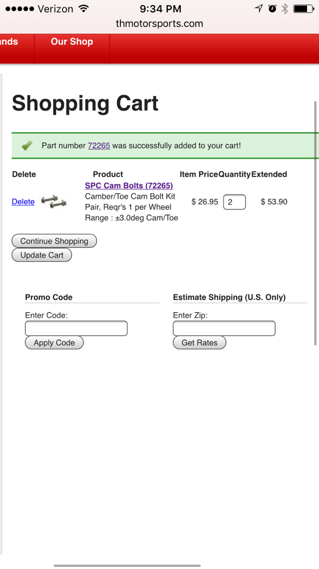

This should do correct, for installation how much is it for normal labor and who can do it performance shop or aligment shop maybe? What's a reasonable price and do they need any specific tool for it?
Attached Thumbnails Cambie Kit V36 sedan with swift springs:-photo527.jpg
Old Jan 26, 2016 | 11:47 PM
Here's the SPC instructions
https://www.myg37.com/forums/brakes-...-template.html
This is something best done by a shop that's done it before or not too hard to DIY. Some shops that just deal primarily w/ bone stock cars can be clueless TBH.
Here's a post that may help
https://www.myg37.com/forums/build-t...ml#post3986266
As far as what A shop would charge, not sure, but it took me about 20 minutes to do the toe bolt slots, so I'd say about an hour of labor, whatever the going rate would be in your area.

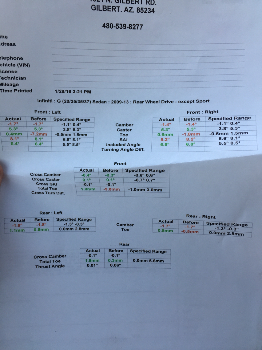

Camber is fine, toe is what's out again, we're going to get it aligned to spec, will post the sheet after there done, I'm at around negative 1.7 in camber witch I'm not worried about but the toe is what I'll keep an eye on.

Here are the updates specs now
Attached Thumbnails Cambie Kit V36 sedan with swift springs:-photo292.jpg
Old Jan 27, 2016 | 08:56 PM
I think you can live w/ those alignment specs. I forget, do you have a square wheel setup or staggered? If you're running square just rotate a bit more often, like every 7k miles. If you have assymetric tires on a non staggered you can still rotate side to side to help out a bit.
Yes I have a square set up and I rotate every 6k miles actually recommended by discount tire, thanks again I'm sure my tire wear is fine the tech stated I have good tire thread
