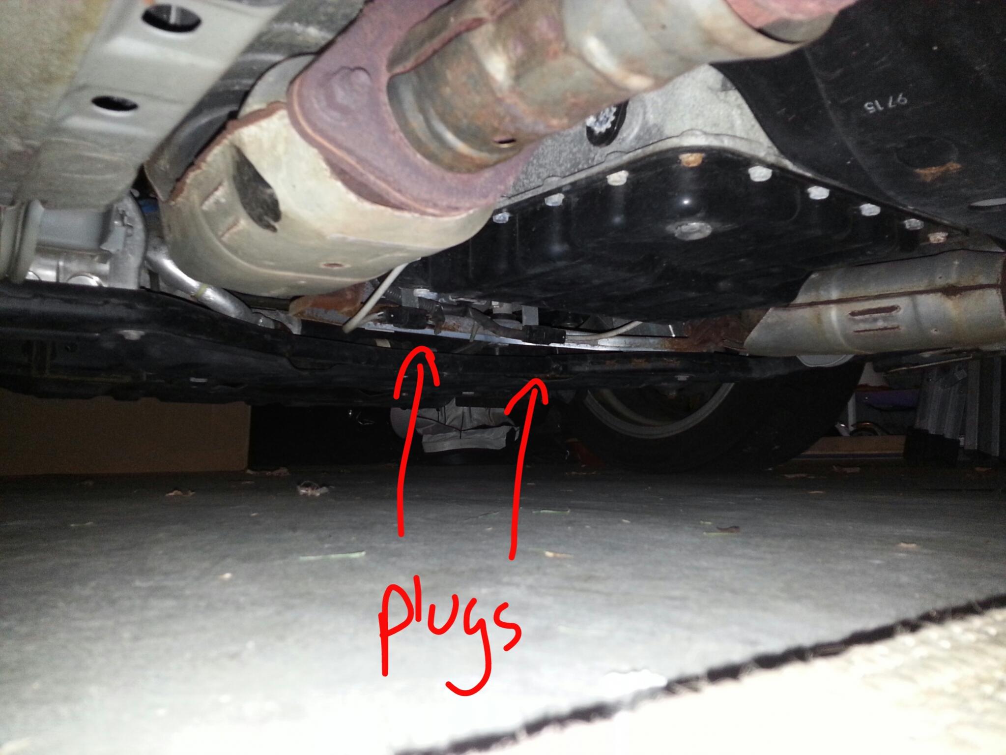

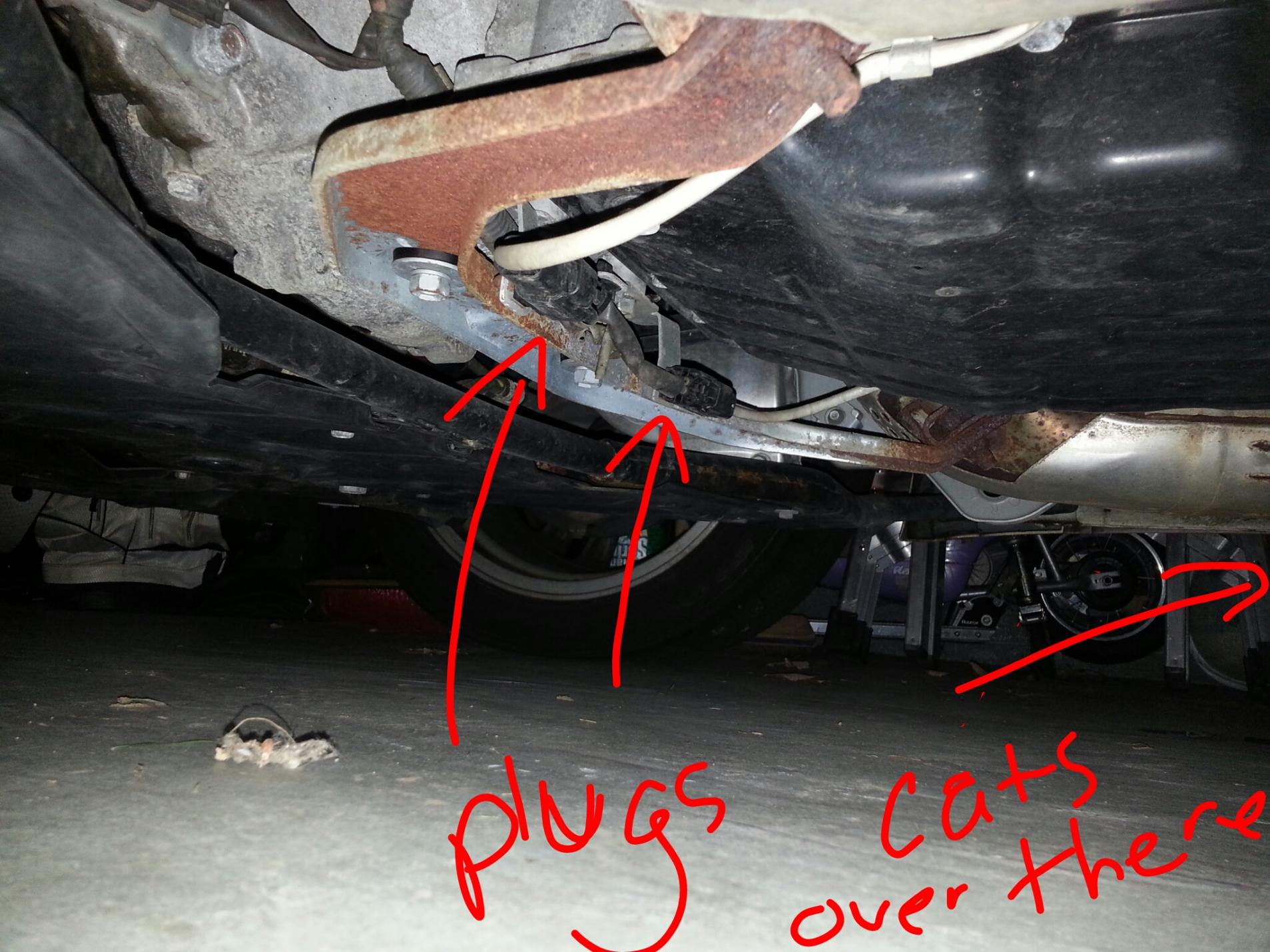

Hey guys,
correct me if I'm wrong, but these should be the wires that you need to disconnect to prevent power to the front wheels. I don't have a lift, so these were the best pics I could get, but honestly the plug is pretty easy to find. They're right in the center of the car, basically underneath the nav screen. Maybe someone that has done this successfully can chime in and confirm these wires for us.
