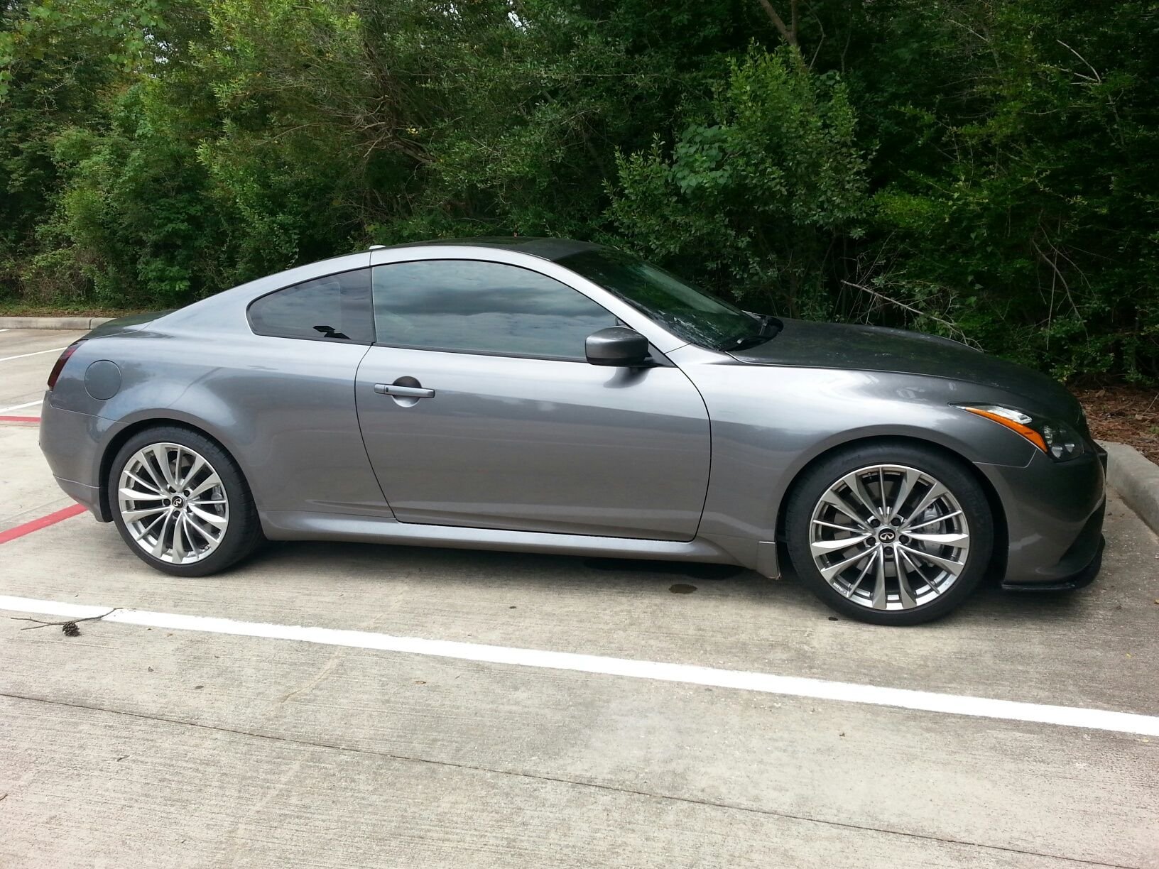

Here is mine, just installed myself. With 15MM spacers all the way around. Drives and feels stock...but I think it sat approximately 28.5 front and now sits just a tad over 27 in the front.

Came out nice Graphite, looks just about even from the pics.

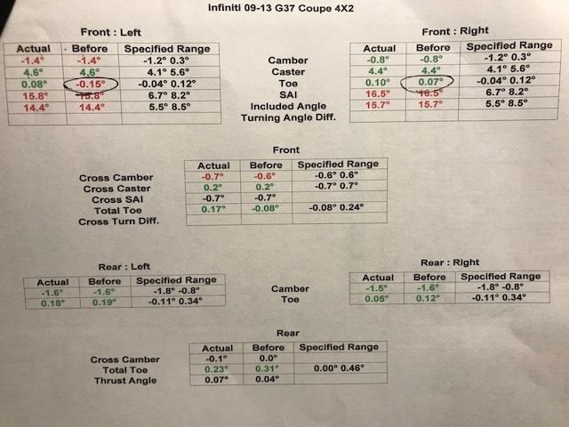

I know this thread is over a year old but I'm hoping to find some understanding....
I did this same exact mod to my 2012 Sport coupe a few days ago. It looks great! Tanabe lowering springs in the front and factory springs in the rear. I also added 15mm H&R spacers all around so now the stance is perfect for my taste. I have IPL wheels, 235 front and 265 rear summer tires.
Today I got an alignment. I'm not too savvy when it comes to these numbers but from what I have read on the forums only the toe is adjustable and not the camber.
Are these good results for an alignment? Am I going to eat through my tires quickly? Is my steering/handling going to be off?
I have no problem going back to the shop and telling them to make more adjustments. Thanks!

Are the numbers you have circled your concern?
The numbers dont need to match the "before" numbers perfectly. As long as they are within the tolerances, they are acceptable.
Based on the results, the toe got better as it was originally out of spec but now is within spec after the alignment.
