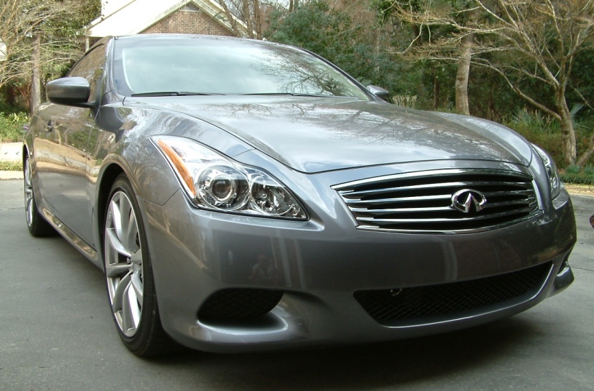

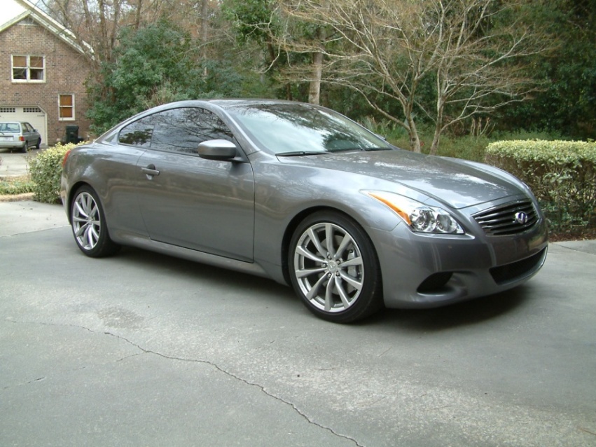

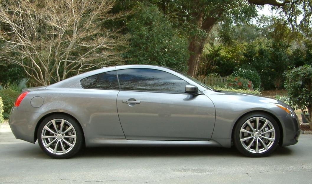

Tanabe front springs with Infiniti Sport rear springs – G37S Coupe
Well, instead of joining the “Tanabach” family as some have, I’ve become a member of the “Tanasport” clan.
I was looking for a solution to the infamous “motor boat” look of the G’s sport suspension, but (as a middle aged guy) I wanted a conservative drop while maintaining the stock ride comfort. For me, the solution was to install Tanabe NF210 springs in front and leave the rear (sport model) springs stock.
Before modification, the front of my car measured 28 1/8 inches and the rear 27 1/4. After installation of the NF210 front springs, the measurements are 27 1/4 (F) and 27 1/4 (R). Dead even! And the look is SO much better, with the ride essentially the same - the steering may be slightly sharper, but that’s about it.
This is the way the car should have come from the factory. It’s a shame to spend $400 on parts and installation to fix a one inch styling mistake, but worth it in the long run, as I will no longer be bothered by the front tire gap. Once I live with this setup for a couple of months and am certain the stance and ride comfort remain the same, I’ll put the Tanabe rear springs up for sale and hopefully recover a bit of my cost.
While the look of the wheels is not overly tucked, I may get 10-15 mm spacers to complete the look, however I’m apprehensive about safety and vibration issues. I’m open to (and welcome) suggestions from the forum in this matter. Who makes the best spacers? What type to buy?
Here’s pictures of the current stance with this setup…

Old Feb 17, 2011 | 09:52 PM
Felix_the_Cat's Avatar
Felix_the_Cat
Joined: Feb 2010
Posts: 290
From: Modesto, NorCal
Came out nice Steve! I'll post pics of my setup soon as I get my wheels done.
Old Feb 17, 2011 | 09:58 PM
cereal2k's Avatar
cereal2k
Mr. Drop it like it's hot
iTrader: (10)
Joined: Dec 2009
Posts: 6,135
Likes: 39
From: Lawrenceville, GA
Originally Posted by usrsld
Thanks... And what's wrong with the "raked muscle car look"? After all, I used to own a raked Mustang Cobra!
Nothing is wrong with it on a american muscle car. It may look off as a Japanese muscle car. The point is, on the vert since it's 4100 lbs, will have a 2 inch drop in the front (at least on eichbachs), I theorize after time it may be the same drop height on the front with the tanabes. Keeping the stock rear spring height would be a little off. I'm playing the waiting game for some vert specific springs though.

wow, they actually are very close in height. The only downflaw I could see happening is that the fronts will continue to settle over the next 6 months causing the front to be a tad lower.
VERY close though!! nicely done!

Hang on to the rears, like you said, until they settle. Might end up wanting to throw them on too....if it looks off
