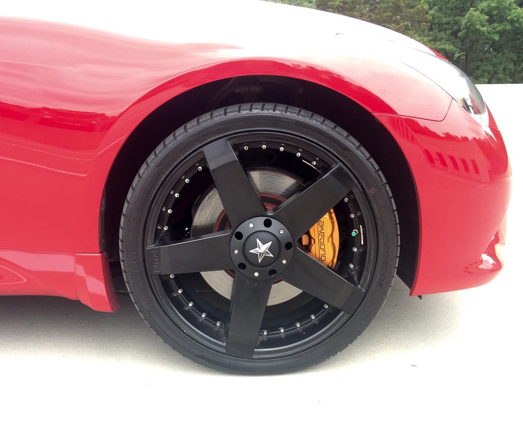

I don't plan on slamming, only closing my wheel gap. 1.5-2" or whatever it takes on my SUV looking xS

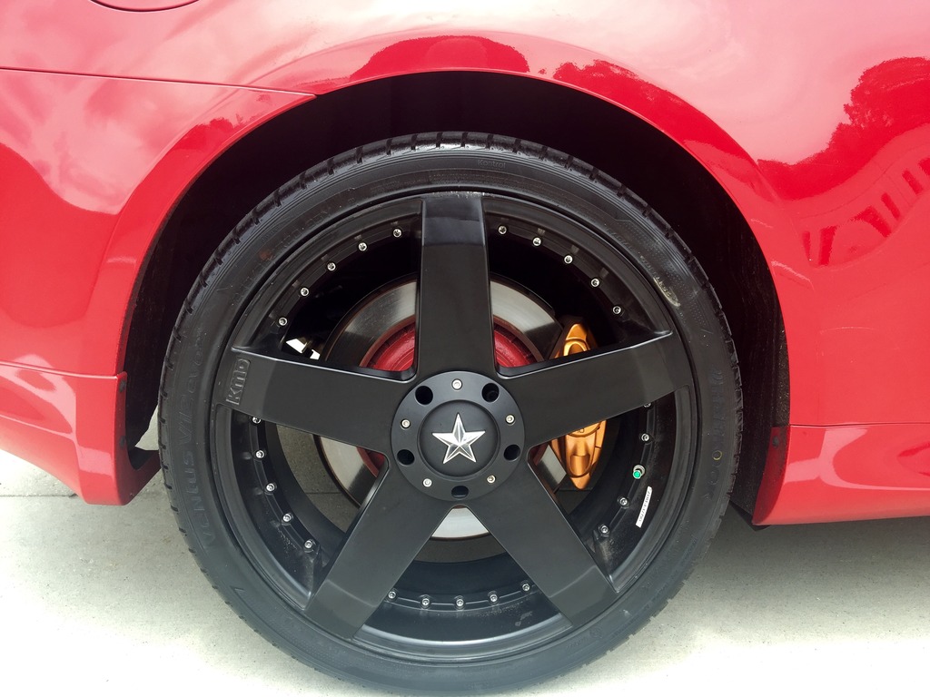

Ah!
Well that explains the awesome wheel clearance!

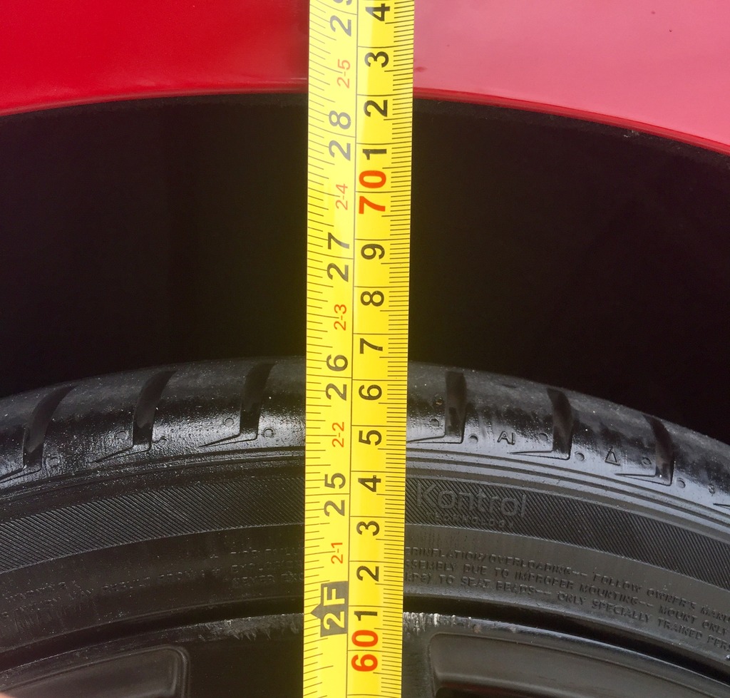

Front on my sedan with fender at 26.25 to ground
Rear on my sedan with fender at 26.25 to ground
