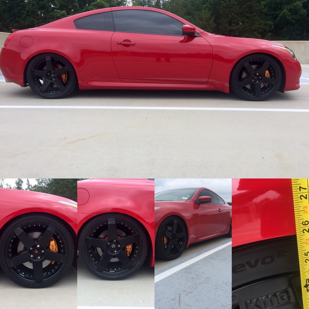

Just before I dropped it off for alignment:

Looks like you've got it sitting pretty good, and now you're a coilover pro!
Thanks Brad, I sure learned a lot...and found there's much yet to know. I hope this might be partially useful for someone. Ill do a proper review when it's all done.
So I had the alignment done.
i definitely will raise the back a quarter and drop the front the same amount. That should make both ends even. Side to side they are surprisingly dead on with the opposing wheel.
The shop struggled with the rear passenger wheel. They couldn't get enough toe even with the mods. They eventually got close with a combo of toe and camber adjustments.
I'll take it to an alignment specialist later.
The ride:
With the F & R done, the car rides like OEM on smooth flowy roads and highways. On choppy roads it's more like my old Vette okay, a bit better.
Noise: almost none. I do get a spring ping on the RR but only on very specific circumstances. I'm still trying to figure out what those circumstances are. For 99% they are dead silent. We'll see in s week.
One small thing bothers me is it occilates very slightly, 2-3 times, On abrupt stops at any speed. I think it might be due to having the tear dampers too soft. (5 clicks) I'll tweak it and see.
I still don't see a practical exit point for extenders on the rear shocks. Kinda surprised no one here has mentioned putting them on a coupe yet.

I adjust the fronts and rears to 26.25"
As Brad has so wisely advised, it's the magic number for tread to arch.
I'll see if I can DD it around here. NP with speed bumps or my driveway. I did bottom on something while ballin down my hill and over some whoops at speed.
No marks in the wheel wells.
Looking under the car the pipes have decent clearence. The lower cover looks like it is ~3" off the ground and so does the main crossmember.
