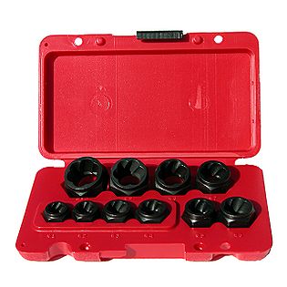

Normally I would advise this: Heat it with a heat gun. Spray it liberally with PB Blaster or Kroil. Let it soak overnight. Respray it liberally. Use an impact gun.
However you have screwed it up by rounding it off. Take the same steps, but instead of using an impact gun, you'll now have to use a damaged bolt extractor. They will cut into the bolt head to grip as you apply pressure. It is ruined, and you'll have to replace that bolt. Use a breaker bar at least 1/2" drive and at least 2' long. Like this one:
1/2" Drive 25" Breaker Bar
Damaged bolt removers:
Judging from the amount of rust visible, I'm guessing you live in a harsher northern climate. My 96 Maxima doesn't have that much rust on it. That's part of the issue making it harder for you. Good luck.
