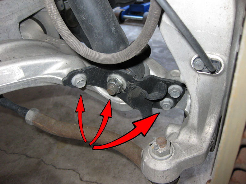

Okay so when changing the suspension, do I actually remove bolts that are the actual alignment bolts? If so, I'd like to figure out which bolts are for the actual alignment so I can mark them and get the specs back to what I currently have even if they'll be off after the install.

The front OEM arms have no adjustment, if you get new front camber arms you can run a length of twine from each mount point to the center of the ball joint and duplicate that measurement for the new camber arms mounts to the ball joint, this will get the front close. In the back just mark the center point of the camber arm bolt and the toe bolt where it rests in the slot. If you get a new adjustable camber arm do the same twine measurement to get the aftermarket arms the same length as the OEM ones, that will get it close enough to carefully drive your car a few days until you get it truly aligned.
That IS the correct Tein part #, and coilovers are quicker to settl, nbut you should drive it lightly a couple times over 3 to 4 days just to be sure everything settles out.
Sorry for all the questions blnewt but I've been reviewing this video for coilover install
and don't see any mention of camber arm/toe bolt removal so I'm still confused at which bolts I should be marking. Can you please clarify?

Check the picture in this link, the upper lone bolt in red is the toe bolt and the inner bolt attached to the red arm (aftermarket adjustable camber arm) is the camber bolt. Should be easy to ID once you look under your car. Both those bolts will be attached at an offset on a large concentric washer and on each side of the washer is a little raised ridge that keeps the washer in it's "track".
Specialty Products Company | SPC Alignment | The Automotive Alignment Leaders

Oh okay!!! I think I got it...thank you so much for the picture!
The video that I posted only removed the outside bolt of the lower control arm and they were able to remove the spring from the assembly so that's why I got confused. Hoping I won't need to touch the inner bolts (unless if it's recommended?) but at least now I know which ones they are if I have to.
Okay one more please (sorry!!)...you mentioned that the front has no camber adjustment but what about toe? Will I be touching/removing the toe bolt on the front when I'm doing the swap?

Toe in front is adjusted through the tie rod connection to the steering rack, so there's full adjustment there

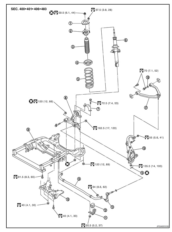

So I'm researching for the upcoming install of the coilover swap and was wondering if someone could help me locate the the torque specs for these bolts for the front suspension:

Looking at the FSM, the big bolt is a 19mm and I THINK it is torqued to 120 ft/lbs and the 3 smaller 14mm bolts are torqued to 89 ft/lbs (I think). However, I'm not really sure if I'm reading it right since I don't know if I'm comparing the right bolts. If someone could please correct or confirm for me I would greatly appreciate it.
Here's a copy of the page I was looking at:

You're reading it right, 120 ft lbs for the bad boy and 89 for the other 3. Be sure to have a backer wrench on the nut holding the 120 ft pounder, IIRC it's 21 or 22mm, then just some PB blast (the night before) and a 2 ft breaker bar and it should break free without much trouble.
