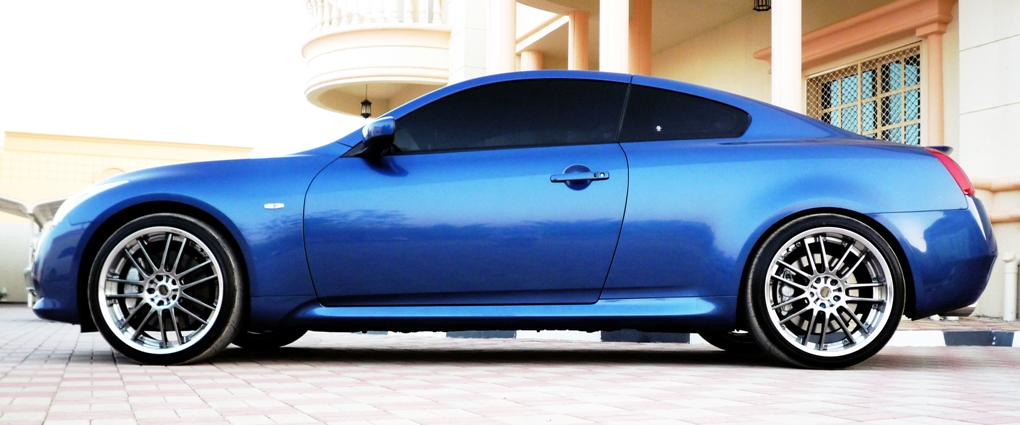

Hey guys,
I already installed my G37 Wheels VOLK GT30 last Saturday. I know I didn't post any photos. I promise you I'll get them posted by this weekend. I'm a bit busy with my University
Anyways, I just would like to give you the specs of the wheels and tires that I have installed:
Wheels: VOLK GT30 "20inch
Front Wheels: 20x9.5 with +35 offset
Rear Wheels: 20x10.5 with +37 offset
Tires: Yokohama Advan
Front 245/35/20
Rear 265/35/20
Now I looked into Tanabe's NF210 specs of lowering the car, but I would like not to lower the rear a lot cause in the U.A.E we have lots of speed bumps and they aren't small ones they are big. Most of them are annoying too when you pass on them. I don't think it's a good idea to lower them a lot + the tires in the rear are (35) of height.
As I saw for Tanabe NF210:
Front: 1.0 inch (that's OKAY)
Rear: 0.7 inch (hmmm not really happy with it)
Is there anyway I can install something in the rear which will lower it at 0.5 or 0.4 inch?
If anyone have a picture of the car with lowered on the same wheels that would be a great help to see a good example.
Open the attachment to see a photo of the car.
Attached Thumbnails Planning to lower on Tanabe NF210 (G37 Coupe)-p1000364lower.jpg
