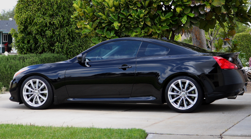

What is needed to lower
Well a camber and toe kit are recommended for a good alignment. You can get a mild drop with eibach pro kit I had it on my 08 coupe and it was a nice drop and not too crazy. The camber kit you can SPC is pretty popular and affordable. Here is my 08 coupe on eibach's I had before I sold it.
Hey Ricio, I've been wondering if your front grill came stock in black like that with a chrome infiniti logo or did you plasti-dip it? I've been trying to get me front grill in a black color instead of this chrome.
I don't know I bought the car like that but now my sedan one is chrome and I'm planning on vynil wrapping it gloss black or painting it so I'm still debating. Don't really want to Plasti dip it but I seen some nice grilles Plasti dipped.

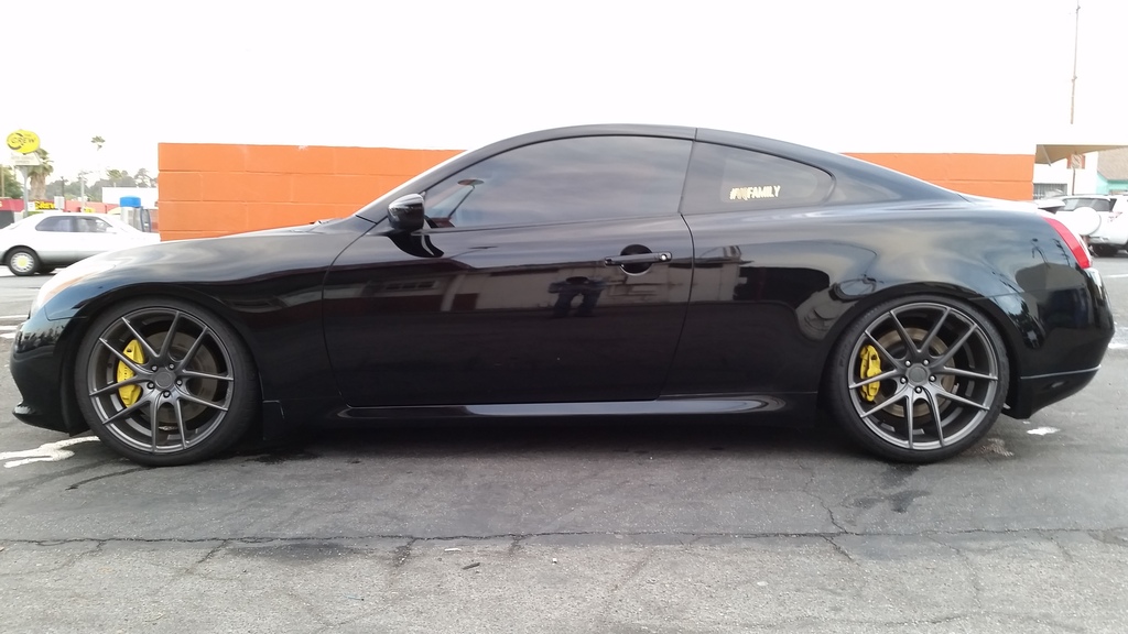

i'm using Tein S Tech. nothing else
but i'll go with coilover next.
What wheels are those?

niche targa
Targa - M129 - Niche Wheels
Nice!! Are those 20" wheels??

yes sir! thanks anyway
