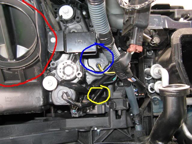

Do you want to also use your original fogs? 4 foglights? If not, all you need to do is cut the wires going into your headlight fogs, then connect them to the ends of the pig tails.
Here is an image of the back of the headlight. You need to cut the wires in the blue circle, connect black to black, blue to yellow (From the pigtails).

Np.

Your 08 has fog lights. They are integrated into your headlight. They are not separate like on 2010+ coupes. The blue circle in the picture is where the headlight fog is located. All you need to do is cut the wires and connect them to the fogs on the bumper via the pigtails.
Got it. Learned something else about my car today. Didn't know they were intergrated into my head lights in he 08.. How would I activate the fogs? Will they turn on every time I turn my head lights on or can I have them run separately? Seems easy enough to install, thanks that to illustration.

Fog light switch. Its a switch you turn right next to the headlight switch.
