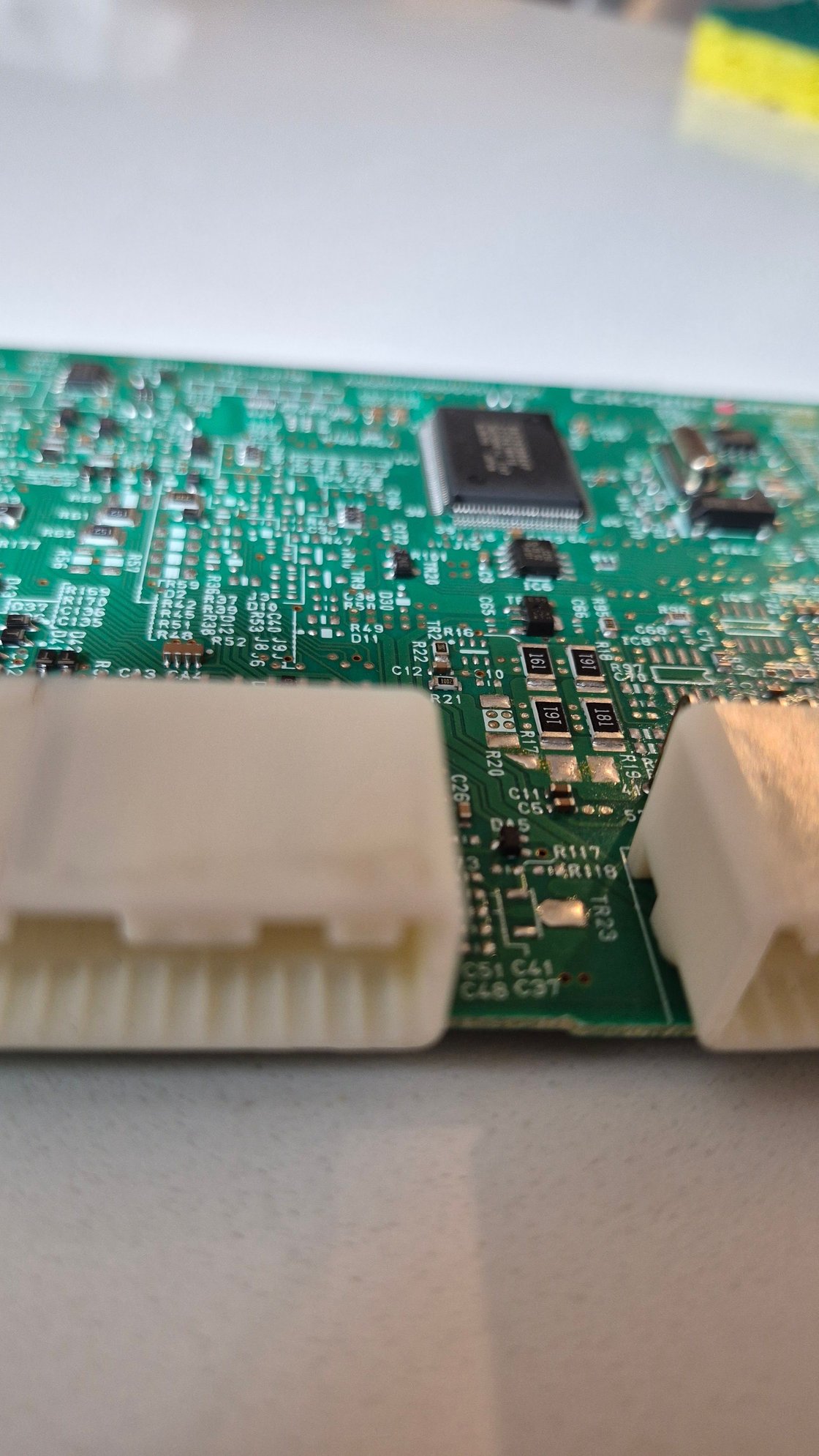

Originally Posted by beefychicken
A huge thanks to @BlackG37CT for pointing out the cracked solder joint on the resistor on the AC Amp board!
My story;
Tank ran dry the other day in traffic even though the car was showing a 1/4 tank...
So I had to do the whole coast to a stop, make that phone call ... 'sure it said 1/4 tank Beefy, i trust you...' then filling with a gas can for the enjoyment of every passer-by, etc. : (
-BTW, I almost never run it this low, so who knows how long this issue was baking - although I have been ignoring the P0642 code for about a month. so I am partly to blame.
Anyway, after getting home and vowing to never go below a 1/4 tank again, I ran my issue through the forum search to see what was out there for help and guidance.
And after a first run and skimmimg through the topics, I resigned myself to opening the tank to clean the sending units and locating and saving an AC Amp on eBay for possible future ordering. And priced some sending units at Napa.
But before completely giving in to spending $$, I read a bit deeper into the threads and discovered @BlackG37CT 's post about the cracked resistor joint. A reprieve was offered! And accepted!
So with all the enthusiasm that I could muster at my age, I tore into the dash, expunging it of many vital components, various screws and other unmentionables that happened to be inside there. This activity occuring a mere few hours ago.
And all that effort paid off in a big way. Because as soon as I extracated the Amp and disemboweled it, I found one of the four resistors on the board had a cracked solder joint. Holy poor manufacturing processes, Batman.
I did my best micro-min solder job (will not share that picture...) and put it all back together nearly the way I found it.
Then powered up everything, made sure none of the smoke escaped from the wires and boxes, put away the extra screws for some project down the road and ran it through a nice op check.
Not only did everything work, but the CEL was cleared as well!
I claim victory and accept my points for this round.
Now I will have to do some real world testing and watch my mileage as the needle goes down and hopefully it will dip below 1/4 tank and provide a trust worthy indication.
Time will tell and I plan to update this post with the results.
here is a pic of the bad solder joint.
just a quick update, I ran it down to almost empty while monitorling the mileage and the fuel gauge indication was accurate the whole time. I claim it as fixed!
