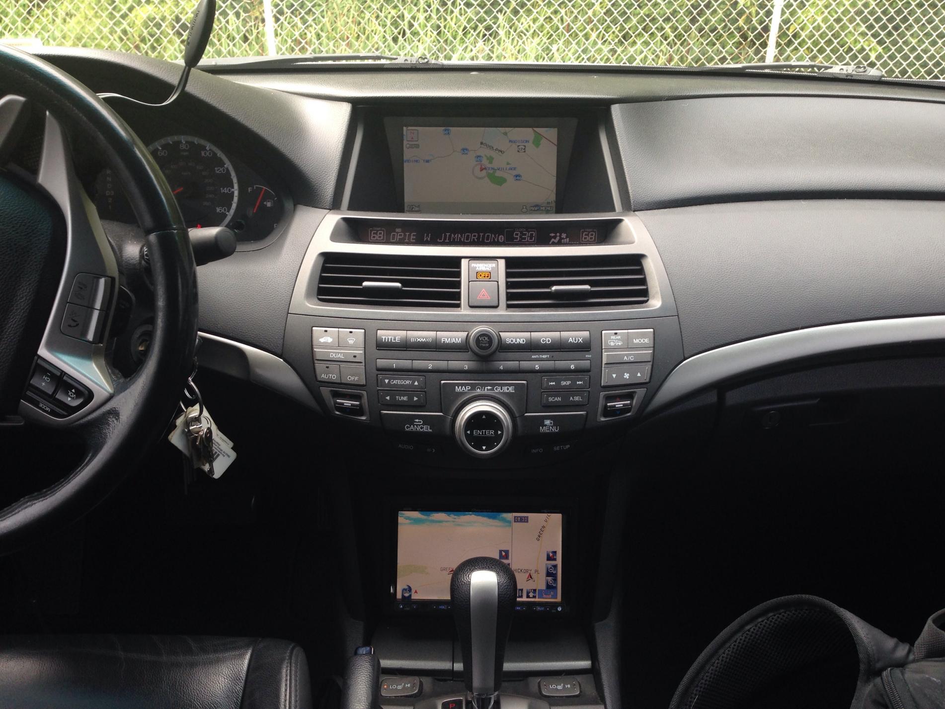

This is what I did in my old Honda. I like the look, and having multiple screens for media, GPS vantage points, GPS maps, other video I/O I may want to add, etc. I think the center section is a little lacking on this car.
