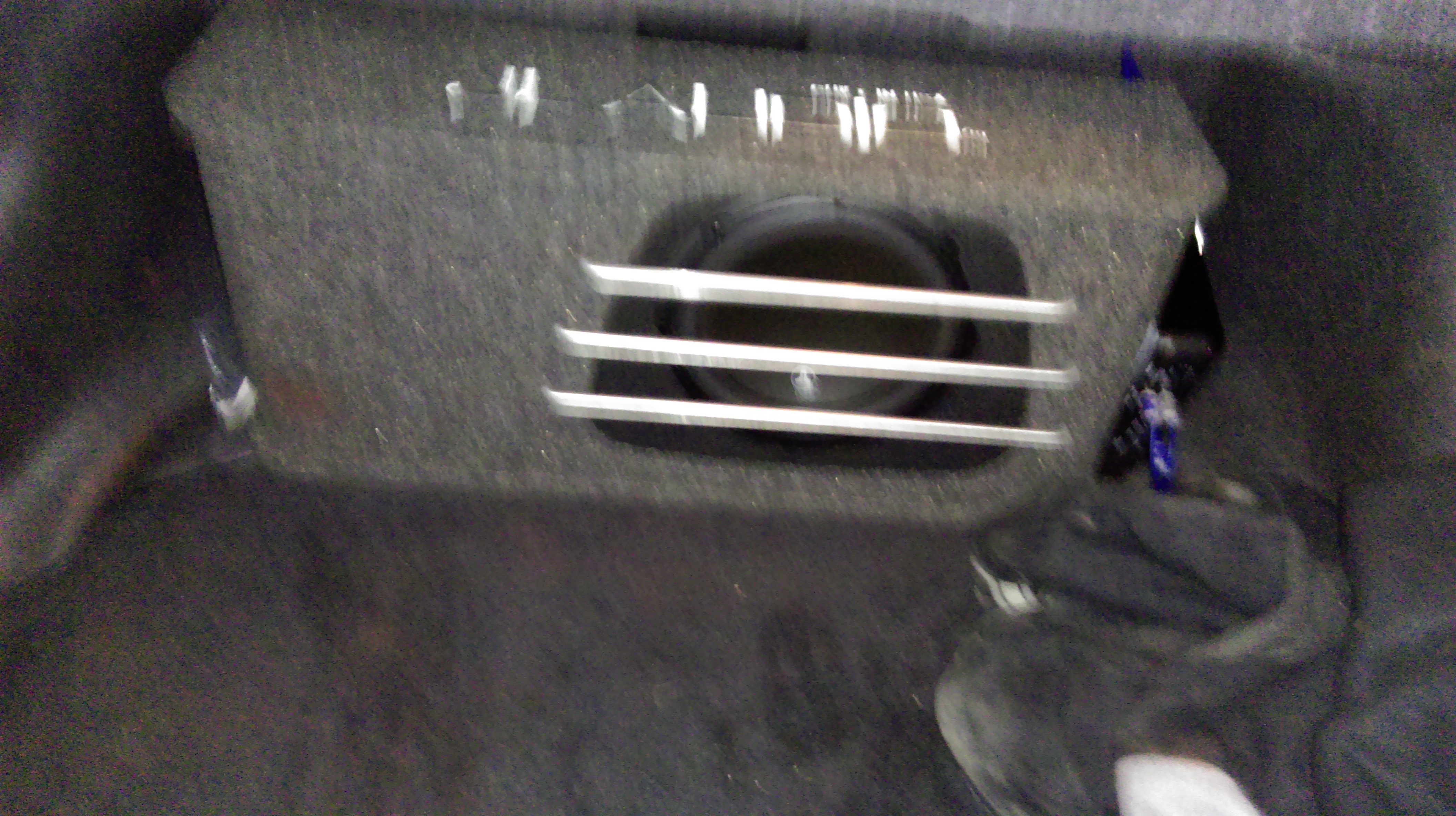

this is the little setup i just put in my g25
[/IMG]
Attached Thumbnails 2011 Infiniti G25x G37 Car audio build Rockford Fosgate 3sixty.3 Polk Audio Zed-imag0248.jpg
