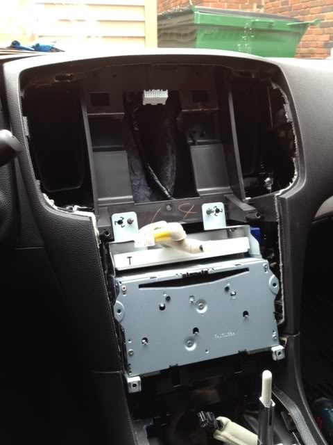

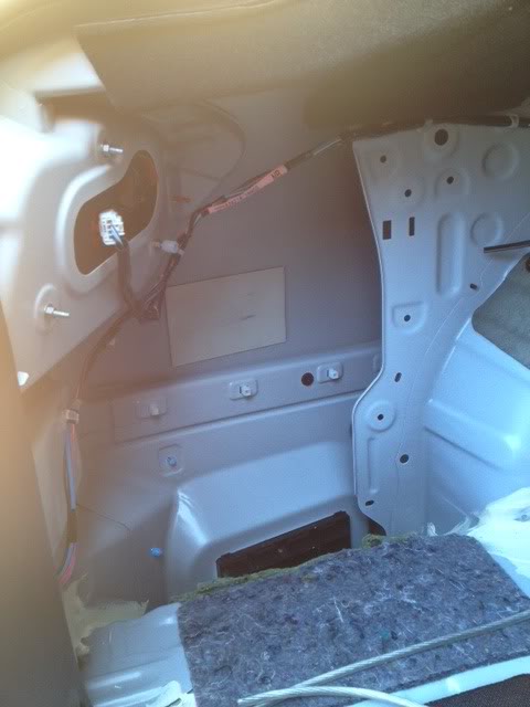

Removing Radio

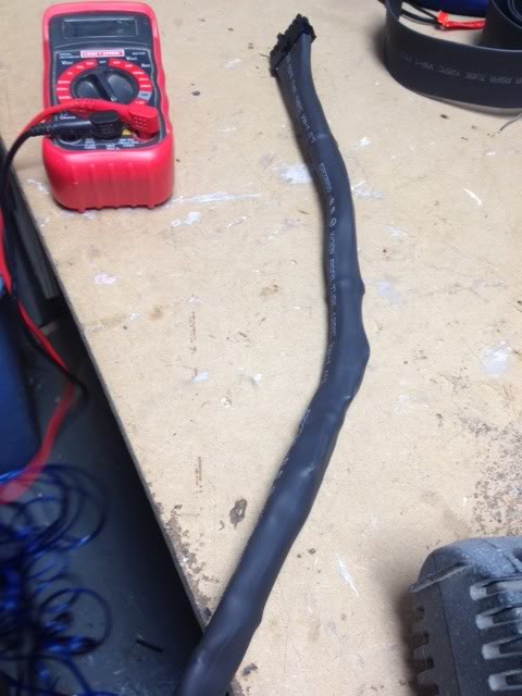

This is where I used the Metra 70-7552, and Metra 71-7552 to tap my signal from the back of the radio

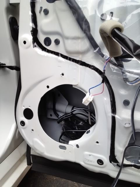

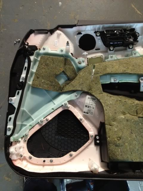

Front door tweeter install prep

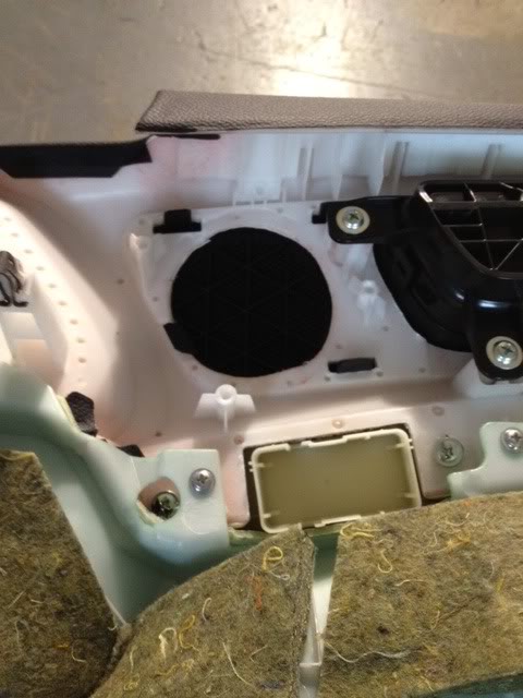

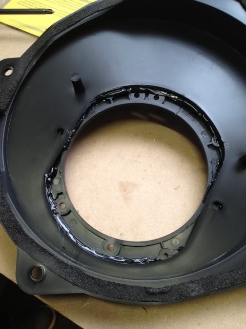

Original front door speaker bracket modification

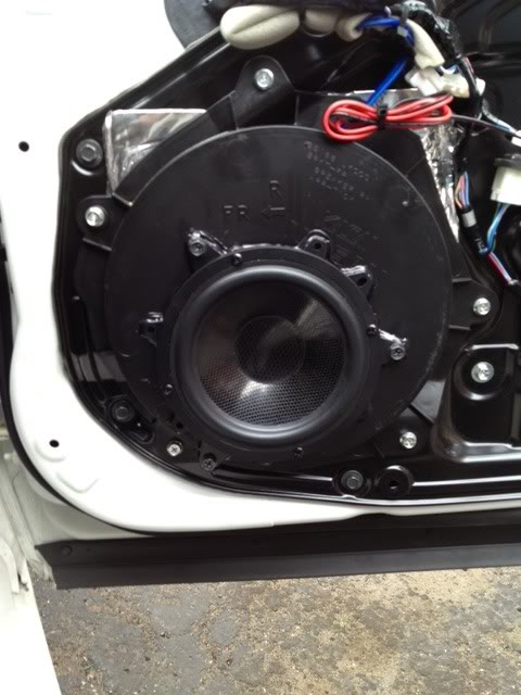

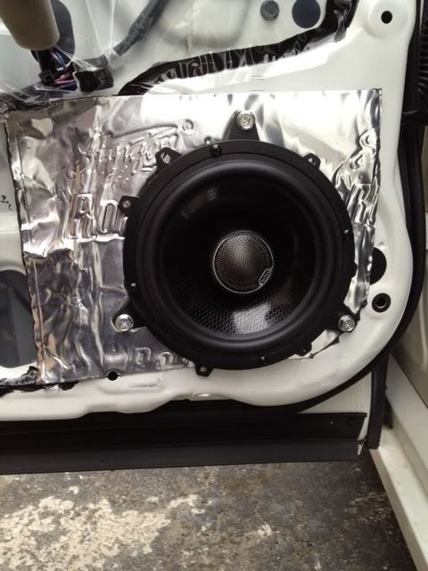

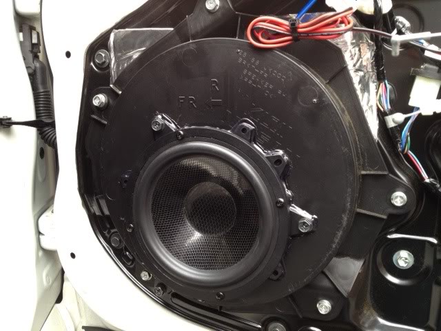

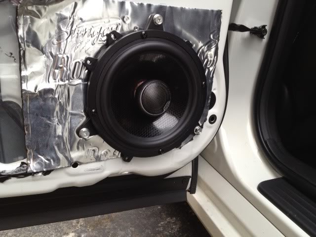

Front door speaker install Polk audio MM6501 component

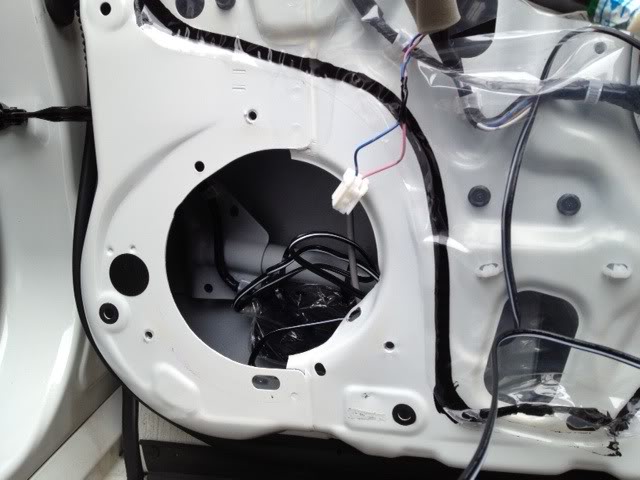

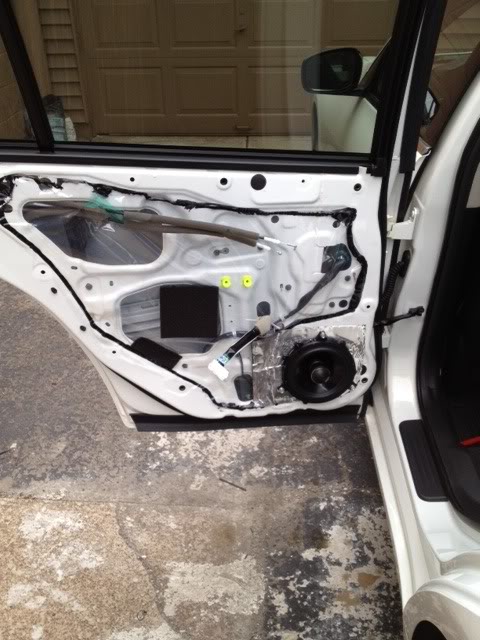

Rear doors speaker install Polk audio MM651 coxial

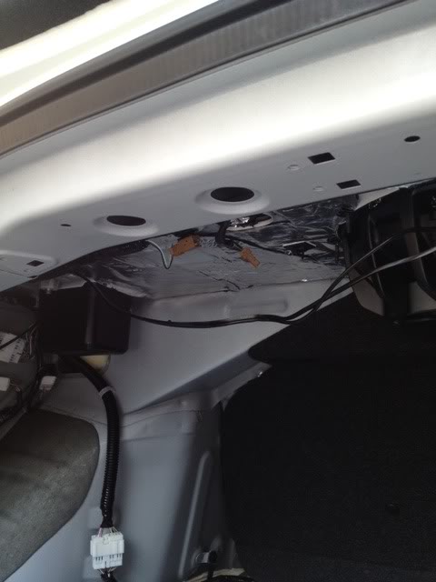

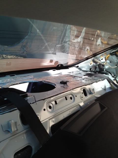

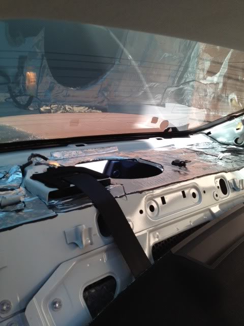

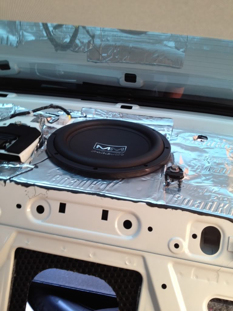

Rear Deck lid Used Stinger Road kill to dampen sound

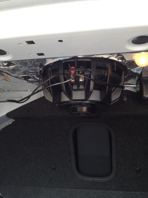

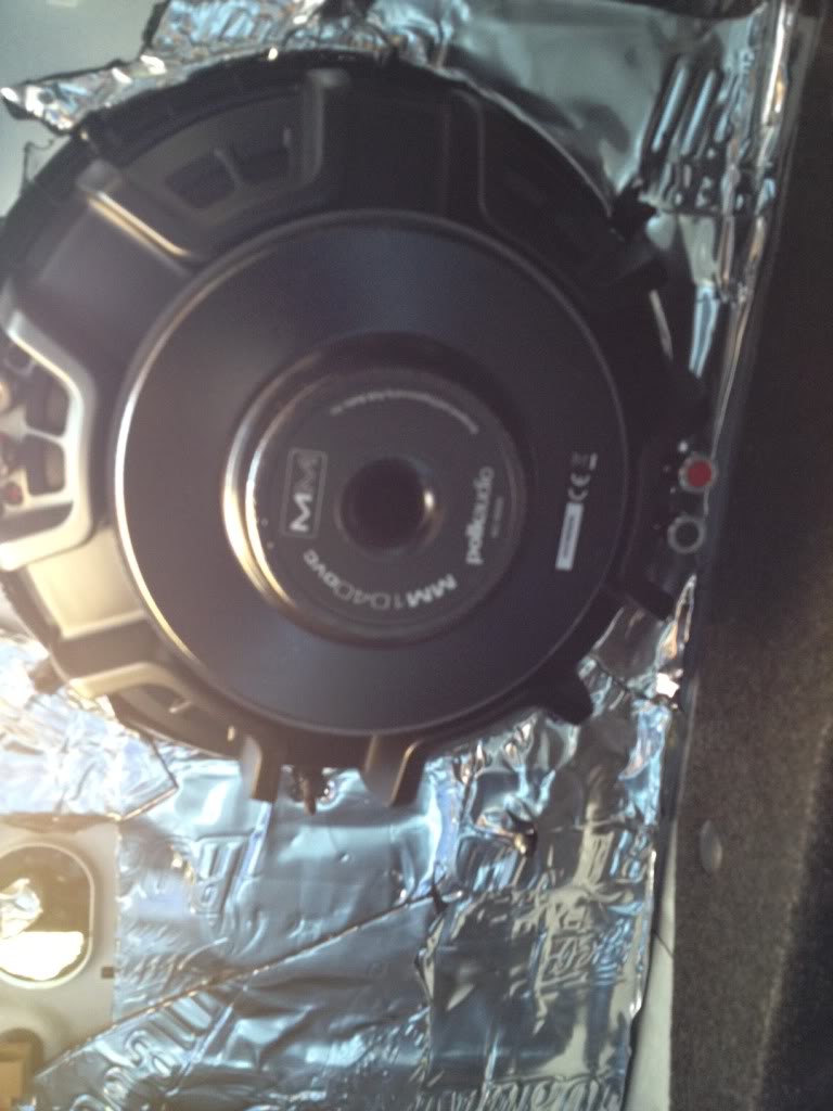

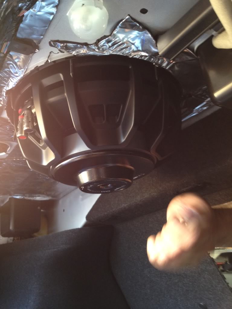

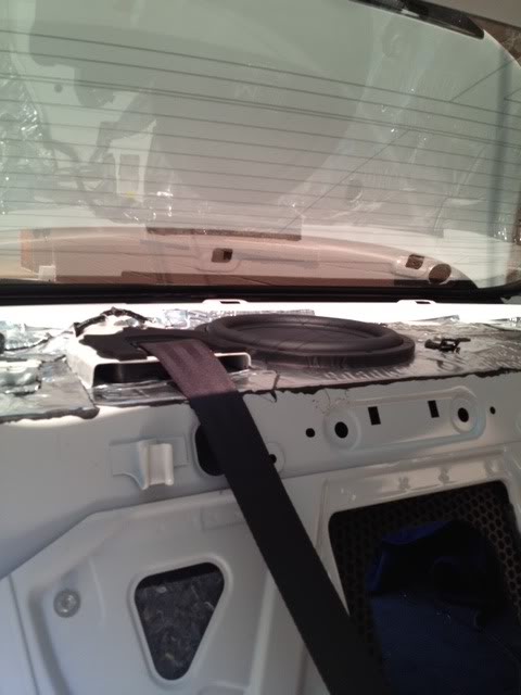

Rear sub install Polk Audio MM1040 DVC

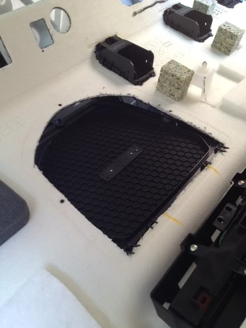

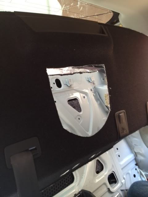

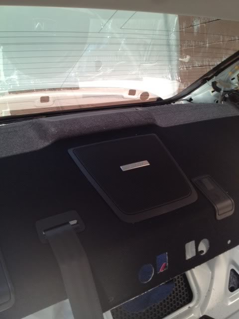

Cut the rear decklid to install OEM Bose grill

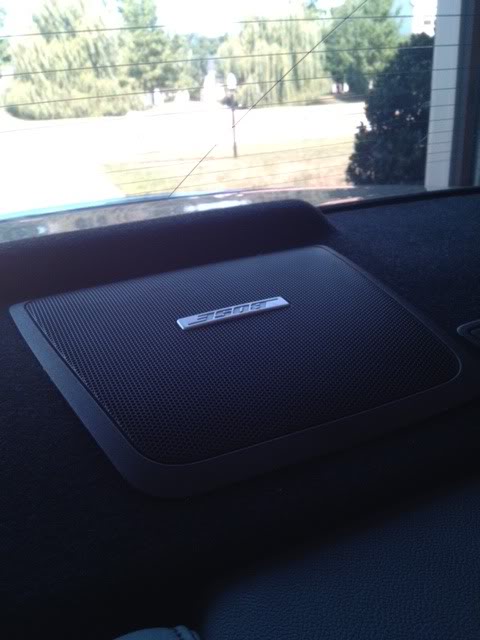

Grill install

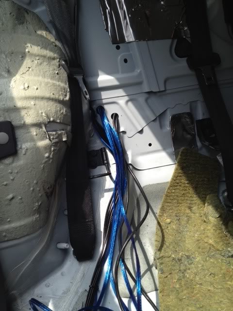

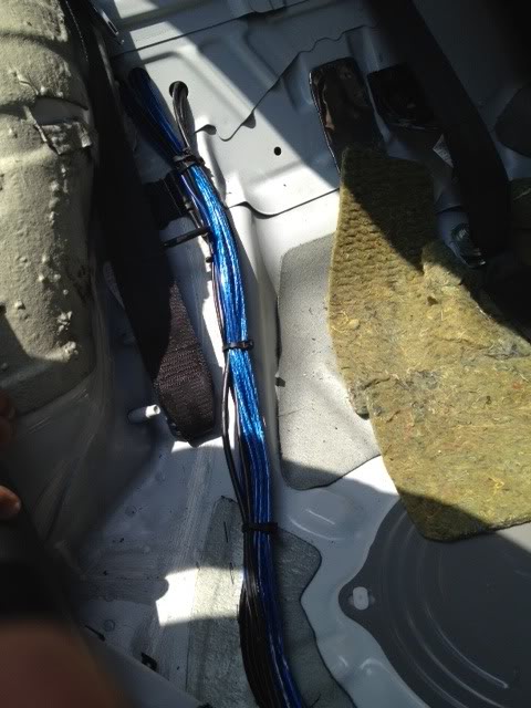

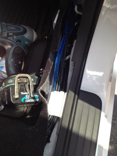

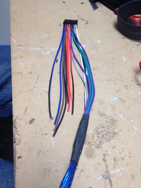

Wiring

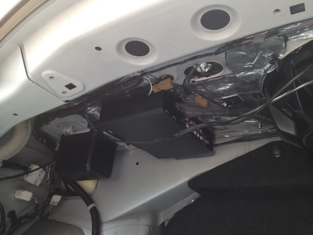

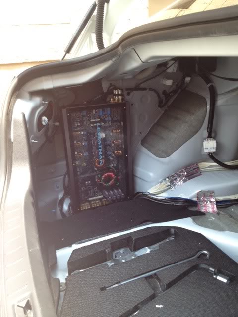

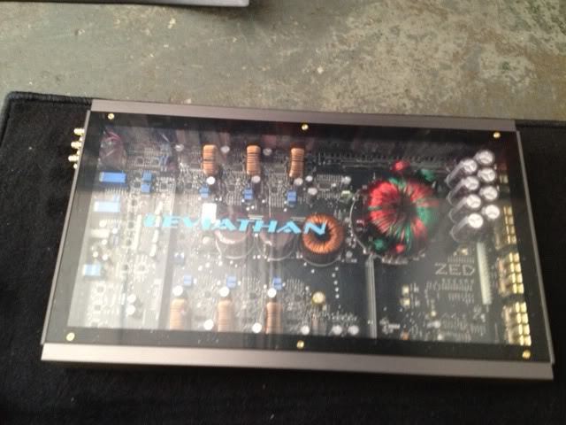

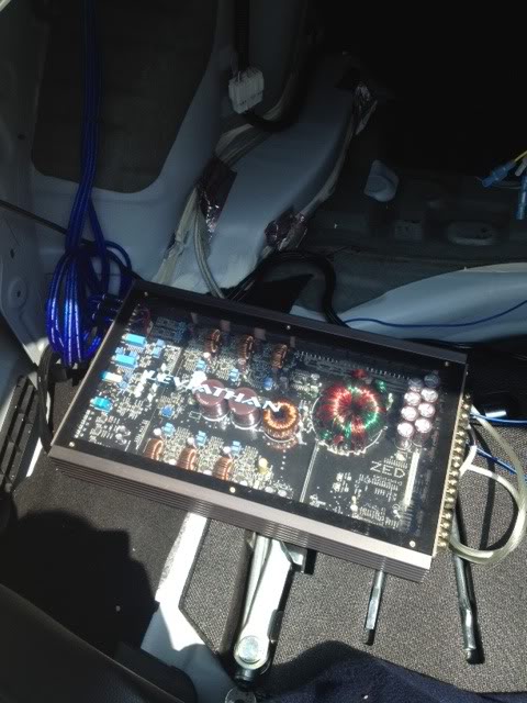

Zed Audio Leviathan III Amp Install

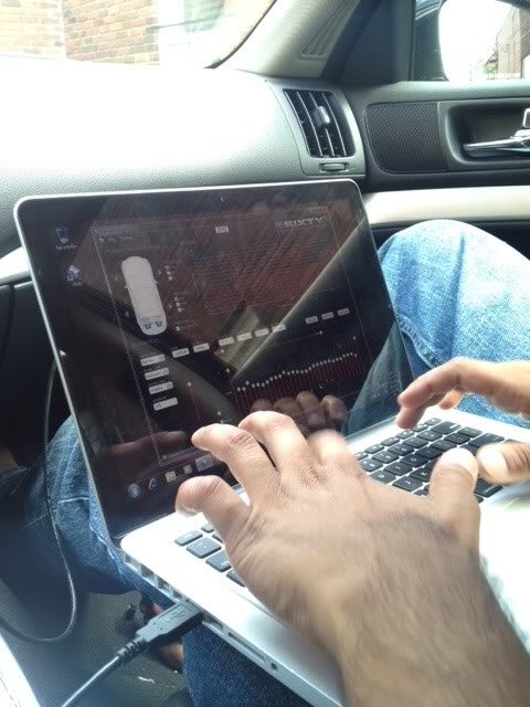

How long did it take you to do the install? Also, one of the pics shows you using a laptop, what was the purpose? Where you able to tap into head unit and configure?

the install was about a few days of work, we were just waiting on the Rockford Fosgate 3sixty.3 DSP
The laptop was to configure the EQ on the 3sixty.3 which is a digital sound processor..

I like it! So you managed to get the front tweeters to fit into the OEM brackets? I couldn't tell from the pictures.
I see you were conservative with the sound deadener on the doors... approved.

Yeah I put the tweeters in the same spot just made my own bracket to mount them,
Yes the deadener is a must on doors, and deck lid, vibration just sounds bad..

How does the Polk Audio MM1040 DVC sound since you have it installed without an enclosure??
What exactly did you modify to get the component speaker installed? Wouldn't an adapter like the ones from zenclosure have worked?

Originally Posted by zinfiniti
Very nice! Bravo!
The mm1040dvc sounds great, i have it hitting in reverse so it makes it sound better..
to get the components in the door i actually used the speaker bracket that came with the polk components.. i didn't have to cut or modify anything in the doors to make them fit.. just basically use the polk speaker adapter and screw it on top of the original infiniti door speaker adapter plate they have already installed...

Hey man, audio install came out awesome. Im in the process of doing mine, i have a 2012 g37, basically same car.
Ive been going back and forth between replacing the factory rear deck subwoofer and putting an amp on it, VS fiberglass enclosures for the trunk. I like the subwoofer in the rear deck better. Are you happy with the sound of it? Is that subwoofer a free-air subwoofer? What did you mean you have it hitting in reverse?
I appreciate the insight.

Just wondering why did you go with a 8awg wiring kit? Why not 4awg?
the sub is not a free air sub but it sounds great, i have the polarity reversed so it makes the sub hit in reverse..
you should definitely look into the Rockford 3sixity3 dsp

just the fact that it was just easier to work with and im running some crazy system setup..
