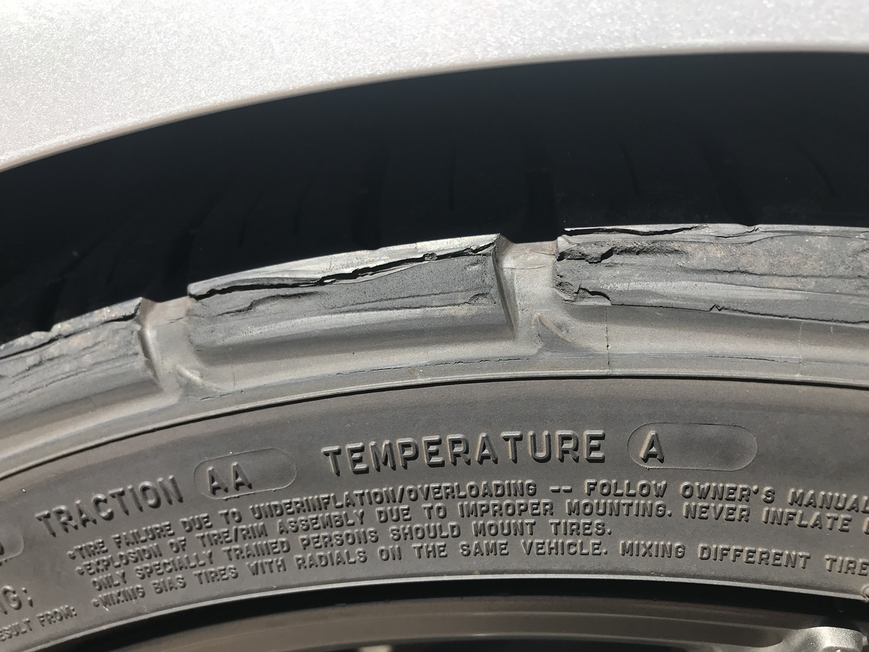

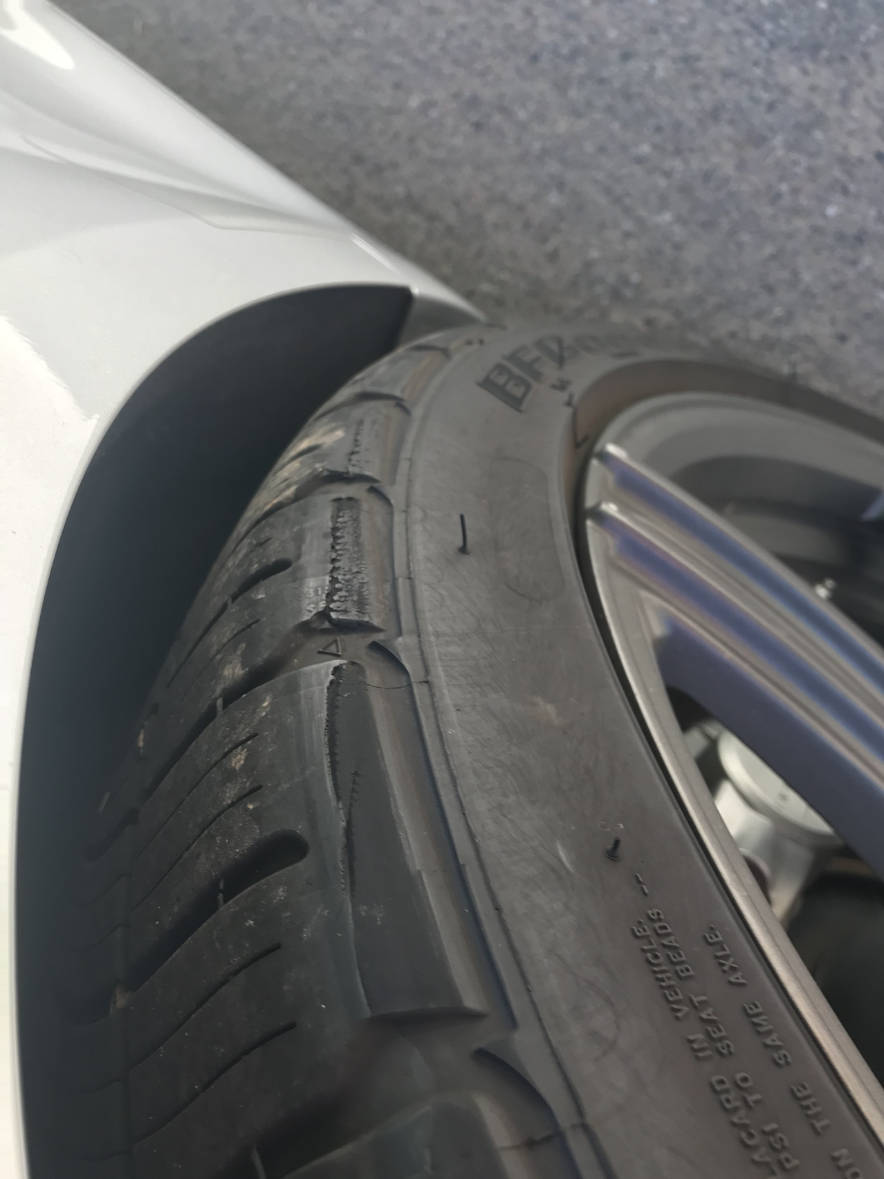

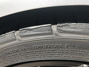

This is why I'm not able to run 285 in the rear, at least with a 35 sidewall. It's so bad if I floor the car, the rear sinks enough to rub.
