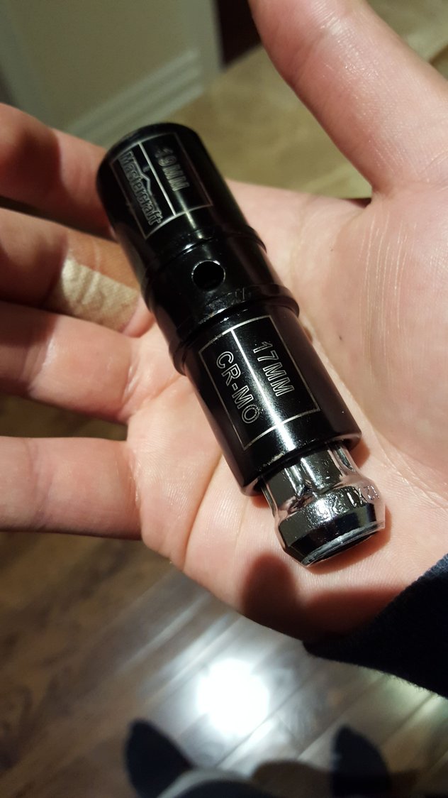

Hey guys ever since I got my G in Feb I've had issues with the friggin' lug nuts. The dealership I got it from didn't have the lock key from the previous owner and I always have to go through so much whenever I have to get something done that requires the wheels to come off.
I was upgrading my HIDs right now and this happened. The lug is stuck real good in there:
Can any of you guys send me a link to a set for for all fours that fits the stock G37s Coupe 2008 wheels.

I got quotes a ridiculous price from them. There has to be another option

Are you rolling on stock wheels? If so, they need mag style lug nuts. The lug nut in your picture is usually for aftermarket wheels. There is potential danger running those type of lug nuts with stock wheels. I've purchased and use non-oem mag lug nuts off ebay without issue for years.

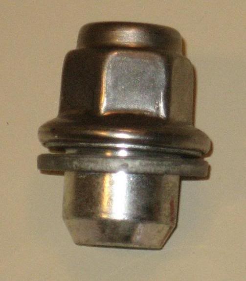

this^^^
Very unsafe as the conical seats will dig into your OEM flat seats and potentially shear off the mounting lip.
This is the type of lug nut you need w/ included washer
And here's the factory mag-style locks on Amazon
Amazon.com: Infiniti Nissan Genuine Factory Original OEM WHEEL LOCK SET EX35 - G37 COUPE SEDAN CONVERTIBLE - M37 M56 M35h - FX35 FX50: Automotive Amazon.com: Infiniti Nissan Genuine Factory Original OEM WHEEL LOCK SET EX35 - G37 COUPE SEDAN CONVERTIBLE - M37 M56 M35h - FX35 FX50: Automotive

Ordered! Thank you sir
