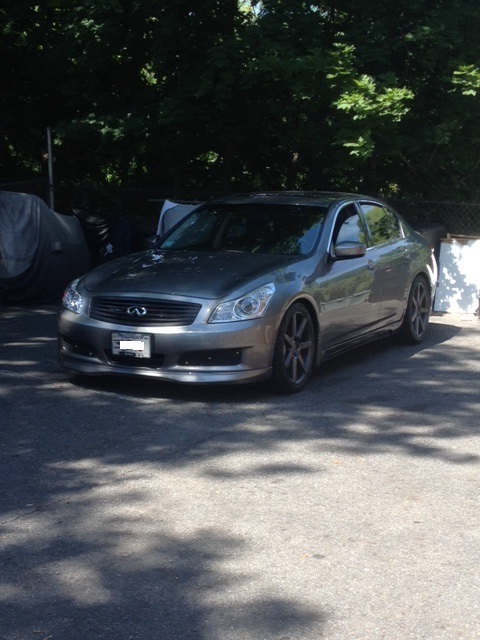

Here's my G on Eibach Springs (rear). As a matter of fact, today was the first day I measured. It rode right, looked right, and if I begin to obsess about something then...well...it's not pretty.
Also being a noob, I didn't note a pre-Eibach baseline. Didn't occur to me then. It probably would now...though still a noob.
Oh and sorry, I didn't measure from the center of the center cap. Just from the floor. Heh, heh...
Sean
