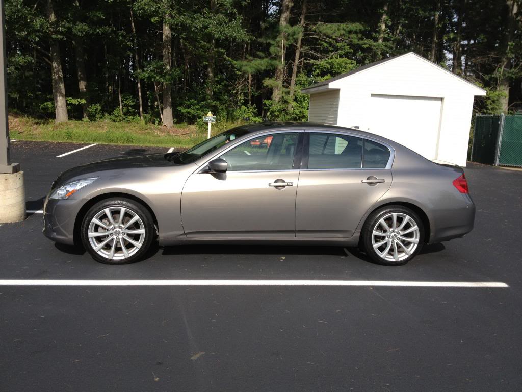

Finally got my hands a set of the 19 inch coupe wheels for a great price
Came with stock tire sizes on the staggered setup (Ventus V12's), rears will need replacing very soon. Anyways, I installed them about an hour after I picked them up I was so excited. While I was away from the forum, I do remember that some people are using the stock tire size on staggered setup on AWD sedan, so I figured I'd be ok as far as the size difference being under the 3%. Was I correct?
I am going to call the tire place this week and get a quote on new rears. Should I continue to roll with stock rear size, or should i go 245/40/19 all around? I do live in New England so snow is a little bit of a concern, but I kept my OEM 17's that will be my winter setup. So hopefully the rear-dif won't be an issue in the summer and fall (as I understand the G is RWD until AWD is needed/sensed by the car).

Car's looking nice and w/ the Swifts on the way it'll look real good

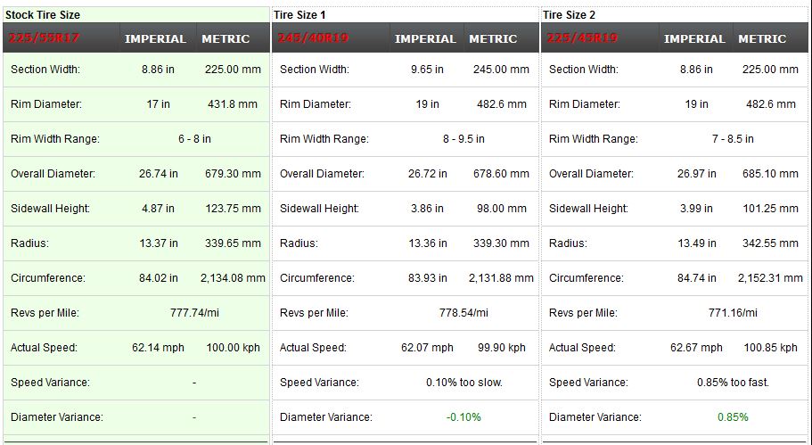

If you go with a 245/40/19 in the front this is the diameter readout~
Diameter difference:
-0.03" (-0.10%)
If you go with a 275/35/19 rear here is the readout~
-0.17" (-0.62%)
And here is the difference between the new 245/275 combo
-0.14" (-0.52%)
Your at .62% max difference from OEM, so about 2.3% better than you need to be. The 0.17" difference in diameter is well within just the air pressure fluctuations or a rear set of OEM tires that's just a bit more worn than the front. You'll be fine with that setup
Did some additional calculator research; feel better now. Anyone who has an X sedan and thinking of switching to coupe wheels please see below. I used stock x sedan tire sizes compared to stock coupe tire sizes. LOOKS ALL GOOD!

If you want same OD front and rear, go for 225/45 F and 255/40 R
OD front will be 26.97 , 27.03 rear.
It's your best option if you want to have "almost" same OD front and rear
