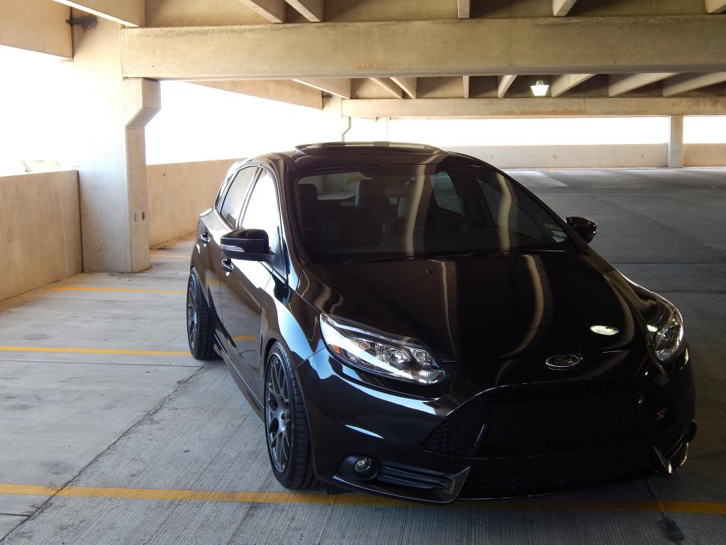

For kicks, here was my previous car. I had a little too much poke/camber in the rear in this picture, but you get the point
2013 Focus ST with just about everything lol. Tuned, intercooler, exhaust, coilovers, wheels, etc. Sold it to get my S Sedan, no regrets
