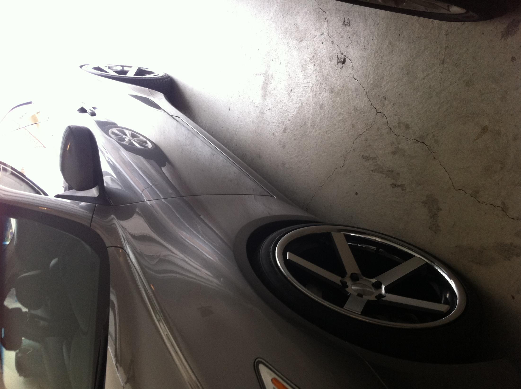

Hey guys,
Just bought some Stance SC5's from a member here and I'm now rubbing on every little bump (even worse while turning) on the rears. My shop maxed out my camber and I'm still rubbing.... any suggestions? Would stiff KW Coilovers do the trick?
I'm on:
20x10 +35 Fronts
20x10.5 +27 Rears
Hankook Evo's
255x35x20
275x30x20
Please help! My car cannot be driven at this time.

I had the same set up, you need to shave your bracket, have sways at stiff, -2.5-3.0 camber ,coilovers on stiff damping setting. Or switch tires to general 235/35 and 265/30.

You should probably sit lower so the wheels tuck in more so they don't rub against the fender.
You should also probably trim the fender bracket, that might be causing the problem. If you have KWV3's.... why are you waiting to install them?

yeah your biggest issue is your simply not low enough. and unless your dead set on getting kw3 id look at companies like stance and bc racing for coilovers.. im running ksports and they are great coilovers. look at some of the guys running 10.5 in front and most of the cars are pretty low. camber is your friend for this type of setup.

No kw won't solve ur issues. The tire set up is aggressive with those offsets
