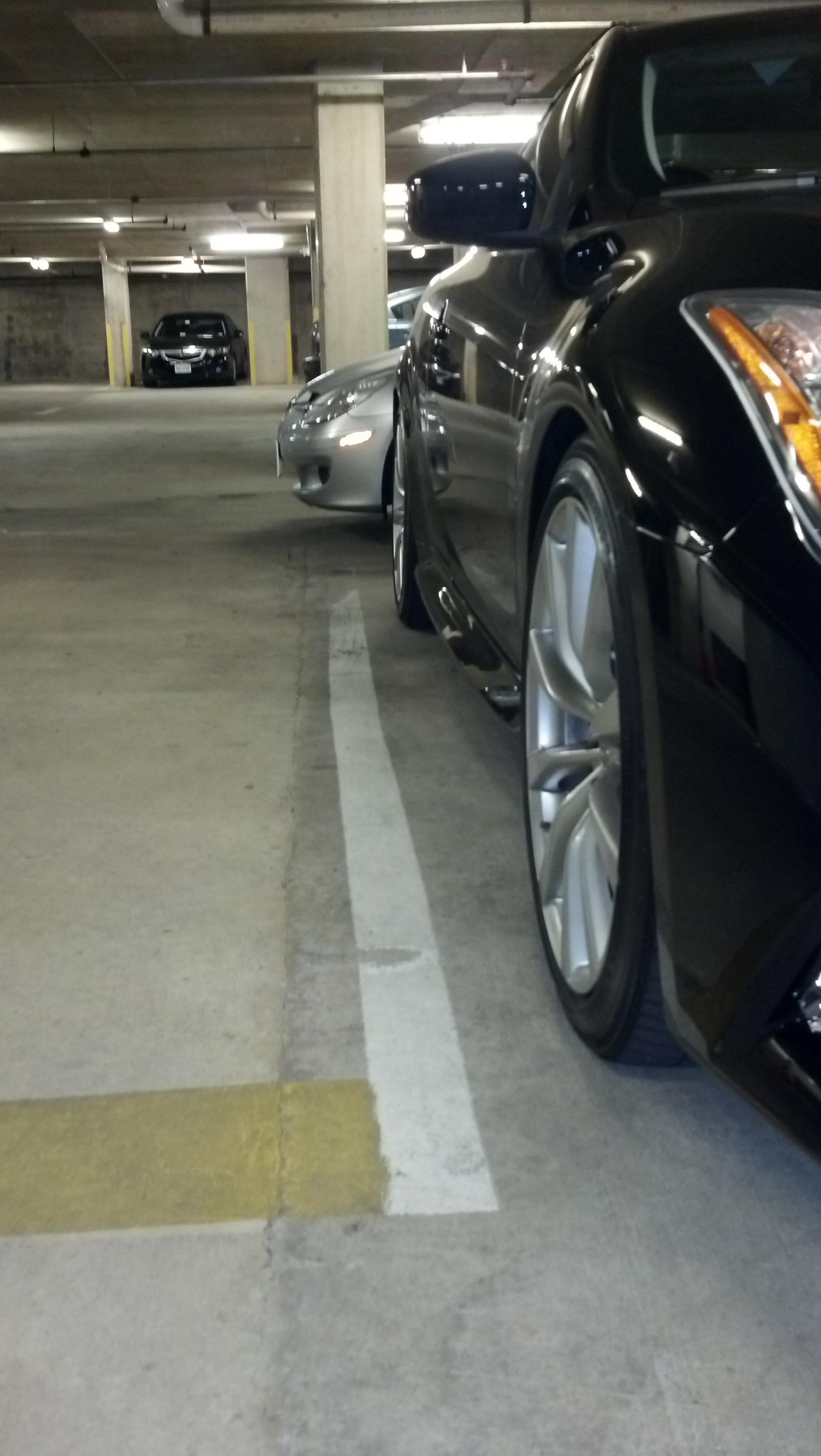

Thanks TVsound for the tips, ended up adding Swift Springs and the 15mm rear and 20mm front spacers. check it out.
Attached Thumbnails 20/25mm spacers with G37S coupe OEM wheels??-2013-06-22-20.14.09.jpg   20/25mm spacers with G37S coupe OEM wheels??-2013-06-19-17.10.25.jpg   20/25mm spacers with G37S coupe OEM wheels??-2013-06-19-15.52.01.jpg

Looking nice Looks like an even drop that should be pretty easy to live w/ on a daily driver, thanks for the pics.
Nice wheel/spacer fit too.
