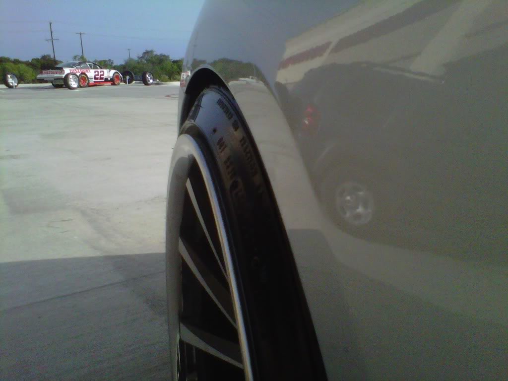

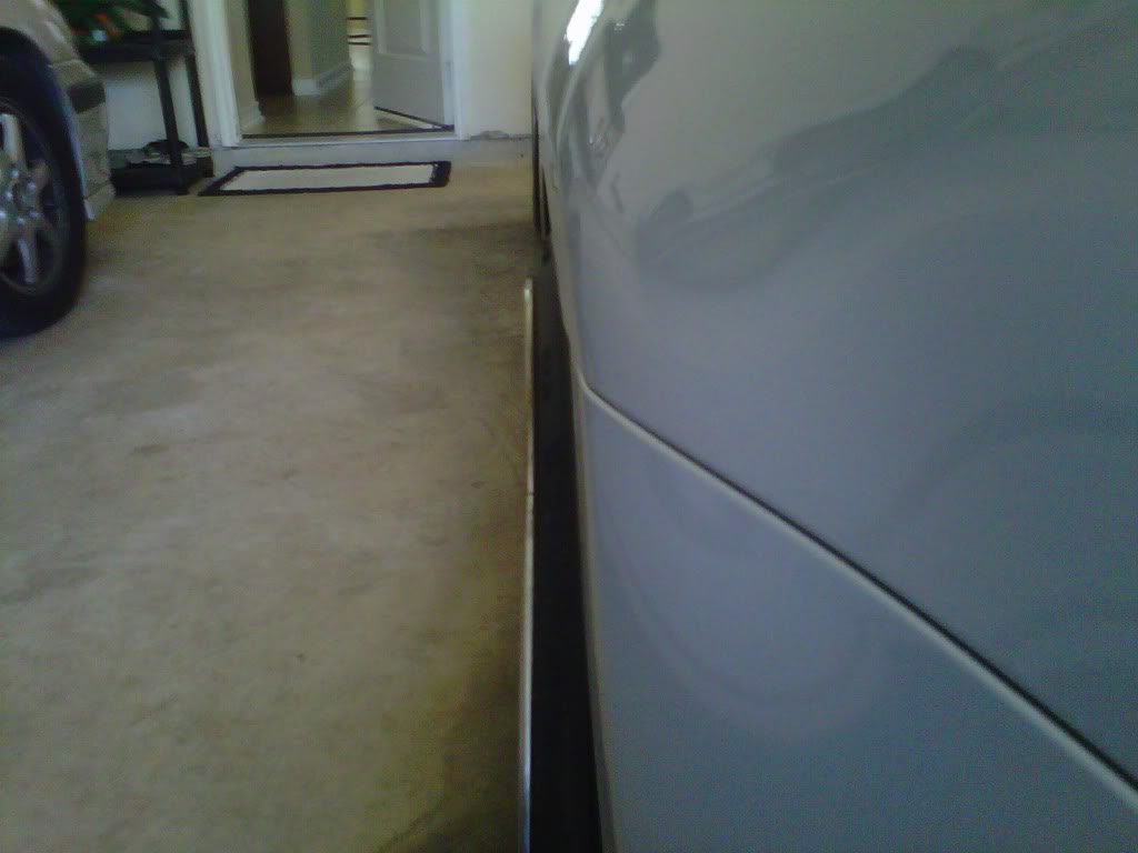

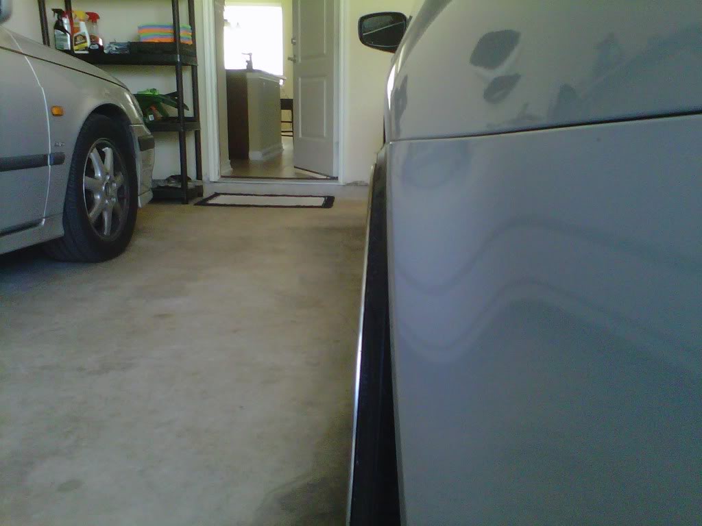

heres what I am going with again, not aggressive but pokes. this is +25 10.5 with a 275/30 slammed

Yours pokes out more than mine, what's your camber at?

low -2's^^^

You sure that's not a 255? That looks super stretched for a 275

All depends on tire. I have had a 275/30 Yokohama S.drive on my +25 10.5 in rear and that **** was square as hell, so it rubbed like crazy. I then switched to a 255 falken, and it was too stretched, so I decided to switch to Hankooks, moderate stretch that clears and won't rub. IMO, falkens have a ugly sidewall.
All I have to say is this; all tires differ by brand. Falkens tend to have a crazy amount of stretch, while the hankooks have a moderate stretch, and the yoko's being crazy square.
