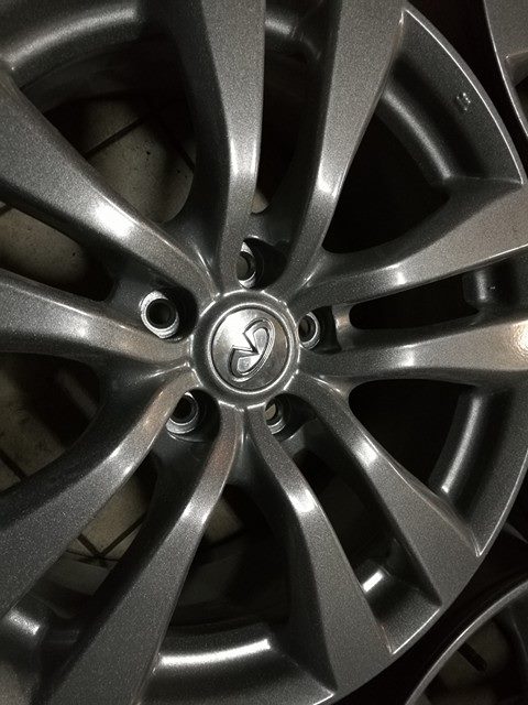

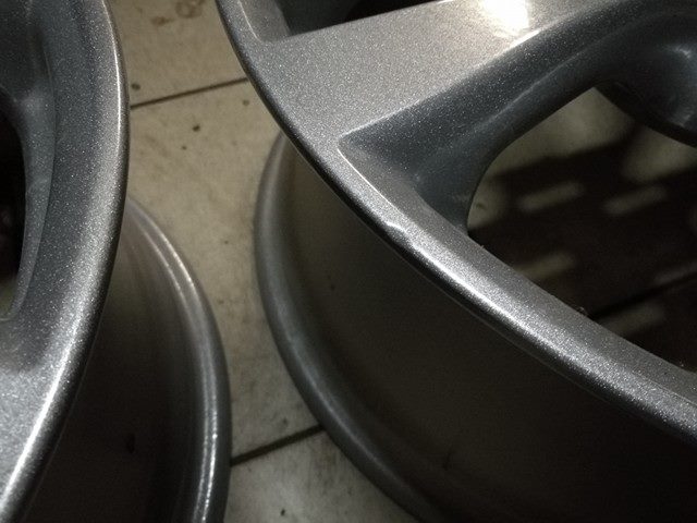

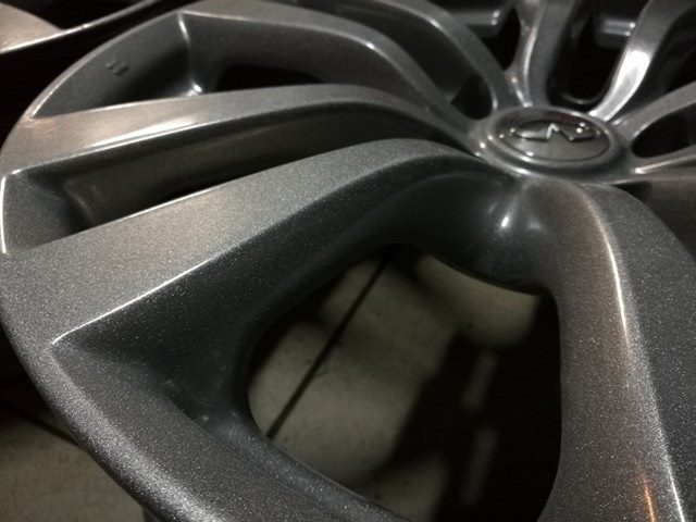

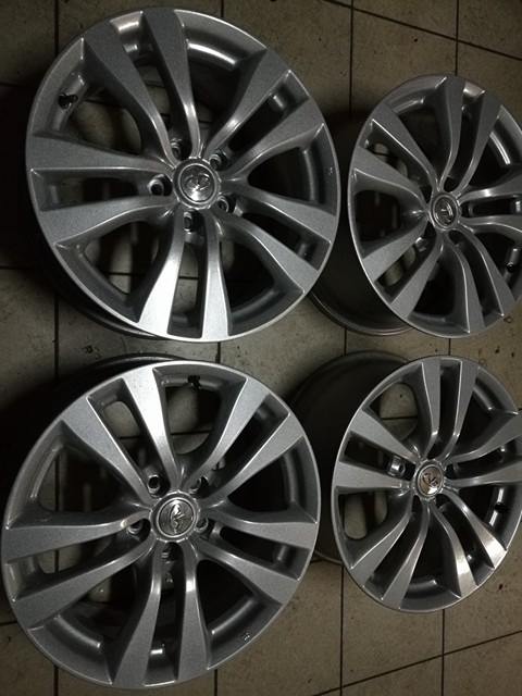

Old Feb 17, 2017 | 07:31 PM
  #147
andi's Avatar
andi
Joined: Feb 2017
Posts: 4
I'm sorry but I have no idea what these letters means as well I just found them on my wheel but I think it's not important maybe it's just Eu code or something I have a pictures and will be very appreciate for your help. Et is 47, in my opinion they are originally from m45
https://www.google.es/url?sa=i&rct=j...87464409673072
Attached Thumbnails G37 OEM wheel & Tires (Specifications) *For Reference*-16466909_1591836894165093_1010852402_n.jpg   G37 OEM wheel & Tires (Specifications) *For Reference*-16469112_1591836914165091_1128820286_n.jpg   G37 OEM wheel & Tires (Specifications) *For Reference*-16443580_1591836890831760_307967089_n-1-.jpg   G37 OEM wheel & Tires (Specifications) *For Reference*-16443685_1591836904165092_350367182_n.jpg
Old Feb 17, 2017 | 08:02 PM
  #148
andi's Avatar
andi
Joined: Feb 2017
Posts: 4
I think i found the answer for my questions this one are original and installed in g37 with big brake akebono kit
SIZE 18X7.5 FRONTS 18X8.5 REARS
BOLT PATTERN 5X114.3 OFFSET 40
My offset is 47, is it means that I should buy spacers? what size? my g37 is AWD
Thanks for all help guys
Old Feb 17, 2017 | 10:36 PM
  #149
Likes: 4,952
Andi, do you currently have the ones in the M45 picture? They may clear the Akebonos but not 100% sure, might need spacers, but you might want them anyway to get a better fit at the fender. If you have those wheels on hand you can fit this template behind the wheel to confirm clearance.
https://www.myg37.com/forums/brakes-...templates.html
