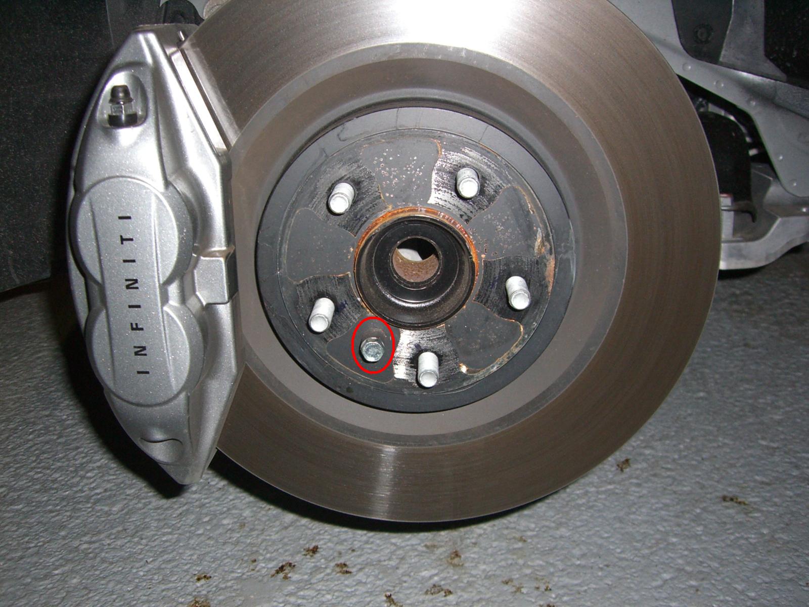

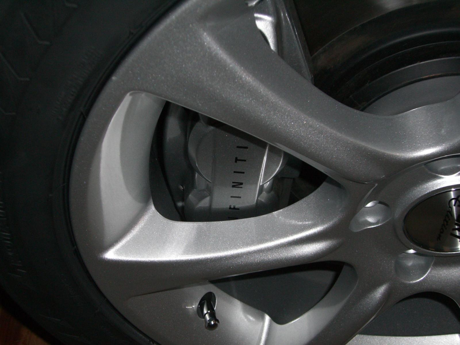

I just installed 4 225/50HR-18 Bridgestone Blizzak LM-25 mounted on 18x8 Sport Edition A7 Silver wheels. They came to $1,258.54 delivered from Tire Rack.
Couple things to point out...
The stock lug nuts won't fit in the deep, narrow holes in the rims. Narrower lug nuts were included along with a lug adapter since most lug wrenches are too fat for the holes too.
There's a 12mm bolt on the front rotors that has to be removed for the rims to fit. The salesman at Tirerack said this was to hold the caliper during repair but I think it prevents you from putting the back tires on the front by mistake.
Rotor clearance was no problem (close to 1.5 inches) The caliper clears by about 3/8's of an inch.
Attached Thumbnails tirerack.com winter tires for boston-caliper.jpg   tirerack.com winter tires for boston-bolt.jpg

Ok, thanks, just did not want to get a jack that would not be able to clear the car. I test fitted one of my winter tires on the car last weekend, but I just used the jack that came with the car. I noticed that bolt to, unfortunately I was not told to take it off, LOL, however after like 15 minutes of trying to put the wheel on, I figured it out, felt stupid! I was happy to see that the tire cleared the calipers. Did you use the jackpoints on the side, or did you jack the car up from the front, because I looked under the front and did not really see a safe place to use to jack up the car.
