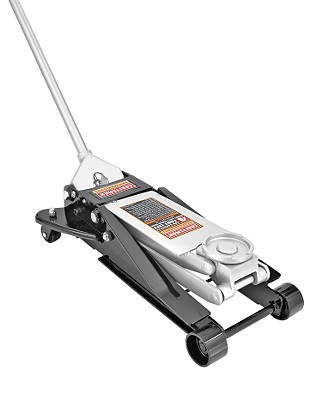

my tires came in a few weeks back. i'm holding off until it stays consistantly cold here in Boston before switching them out with my summers... but today i wanted to make sure they were going to fit so i used my new low profile floor jack (From sears) to lift her up and slap one of those winters on. They look good and it appears to fit w/no problems (i.e. no brake clearance issues). Make sure you follow instructions as you need to put the tires on with the arrows pointing forward.
Instructions that came with the tires state there is a round insert placed into the wheel well which has to come off when you take your winters off next spring... i'm not sure why that insert is in there.. if anyone has an answer to that let me know.
john
new floor jack from sears.. fits under the car perfectly.

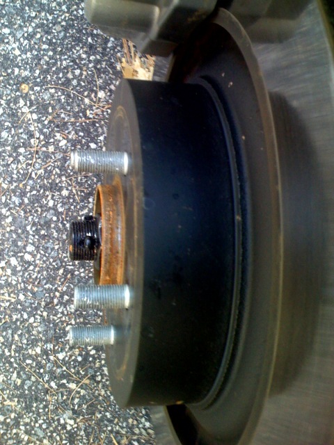

i dont see this big a$$ bolt in the pictures from the post above. this is a shot from my rear left calipar. i dont think that bolt in the center is causing any problems.. though it feels like its night as snug when i test fitted my tire.
at first when you guys were talking about removing a bolt i thought it was this big center bolt.. though it looks like it keeps things together. Thoughts? Looks like it should stay on to me and i dont believe there are any clearance issues with it but when i threw my winter tire on it didnt feel as snug as i think it should... maybe just me... prob!
another question.. do i need to mark my summer tires with where to put them back on next spring? i didnt see any arrows marking the direction of the tire..

If you have the sports package, the front rotor has the bolt to prevent the rear wheel from being put up front.
I always mark which wheel went where but with the sports package it's pretty obvious. The 45's go up front with the 40's in the back. Then the tires are directional so you know which side they go on.

I'm thinking maybe you are describing "hub concentric" rings, I think that's what they're called. If your wheels came with 4 rings, approx. 2 inches in diameter, try putting them in the center portion of your rims before you mount them. Or, alternately, put them on the ring around the large nut in the center of the brake rotor... If my guess is correct and they pop right in, your wheels will fit snug the next time you mount. The big nut stays.

thanks racer.. those rings came installed in each rim.. sort of loose and can rotate around. instructions that came with the rims from tirerack state those rings must come off the rotar area if/when you switch out with other tires. just not sure what they're for.

Yeah basically they're just 4 plastic rings, their purpose is exactly as the name sounds, they allow for the rim to mount exactly centered on the hub of the axle on your car. The center bore of the rim is larger than the hub on your car, thus if you were to try to mount the rims without it, you could be mounting them off center and thus your car will ride very rough with alot of vibration which obviously could be very dangerous. You will see this alot if you buy aftermarket rims because 9 times out of 10 the manufacturer is producing the rim for universal fitment.
The rims that came specifically on your G37 were made to fit the car perfectly. This is the reason why you must ensure the centering rings are pulled off the hub of the car before you mount your O.E. rims back on. If you don't, first you'll notice that once you mount the rim it won't fit flush against the car, next you'll notice that no matter how much you tighten the bolts the rim will still be loose. Each of these things is obviously very dangerous if you drive like this. The centering ring is preventing a flush mounting, as the O.E. rims where designed for the exact size of the hub. If you continue to try and tighten the bolts you'll eventually hear the 'crack' of the plastic ring being crushed against the car. Then you'll have to go out and buy another one when you re-mount your aftermarkets. It's important to note although the rings might appear snug on in your rims right now, it is very possible that when you take the rims off the ring will stay on the hub and not come off with the wheel, so Tirerack is just making sure you check for that.
