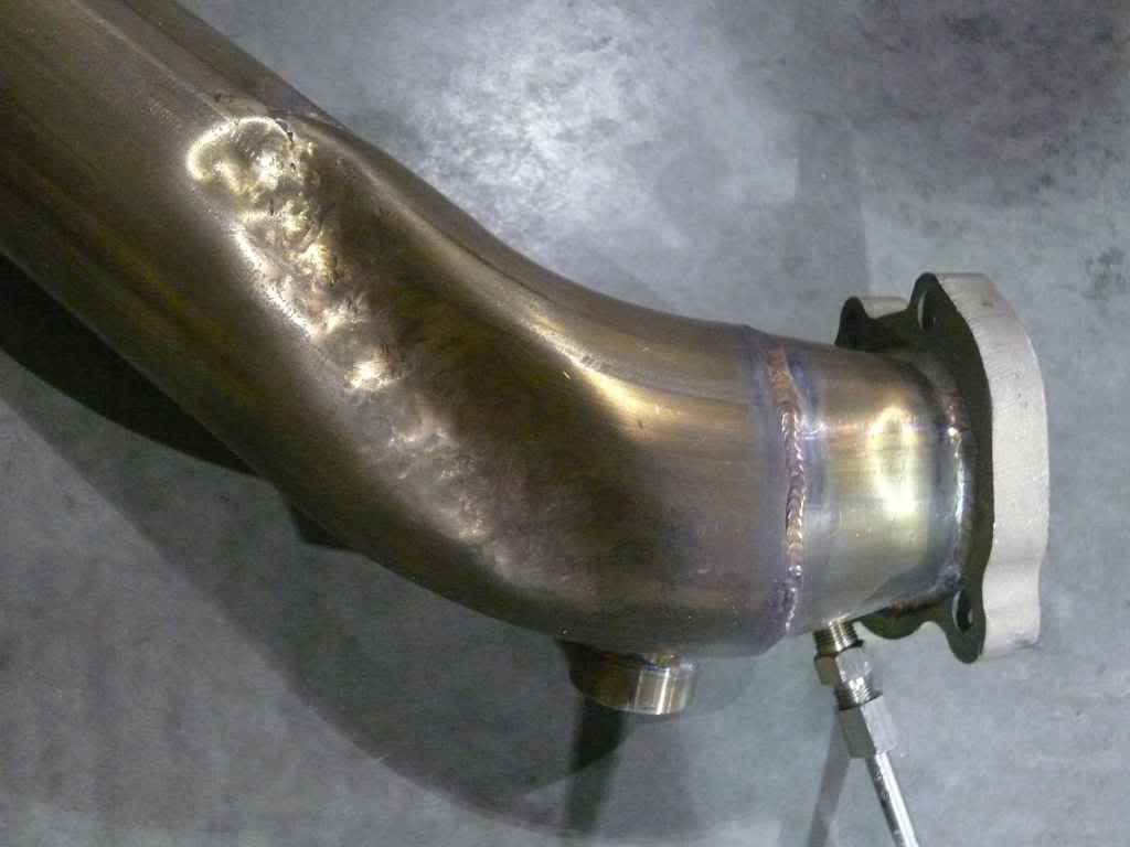

1) The Passenger's side Down Pipe has been dented in severely. It looks like Forged used a hammer and beat the crap out of it. These parts are made for these cars and should be going in without any issues. Sam confirmed this as well.

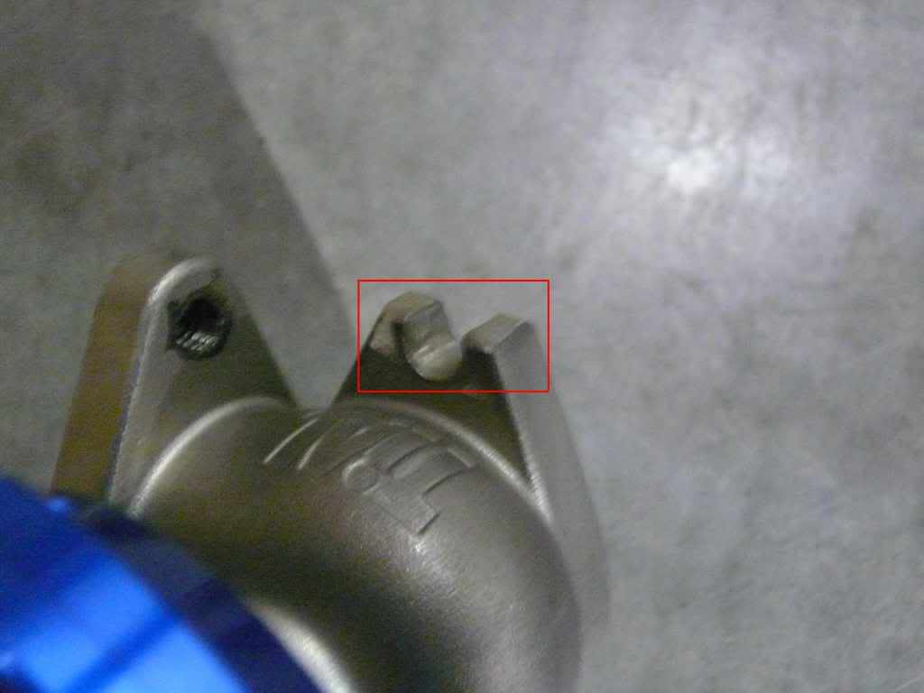

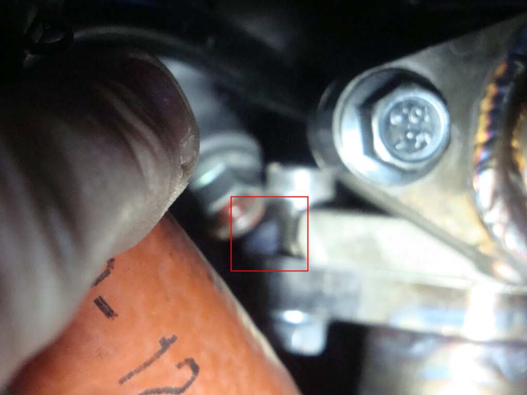

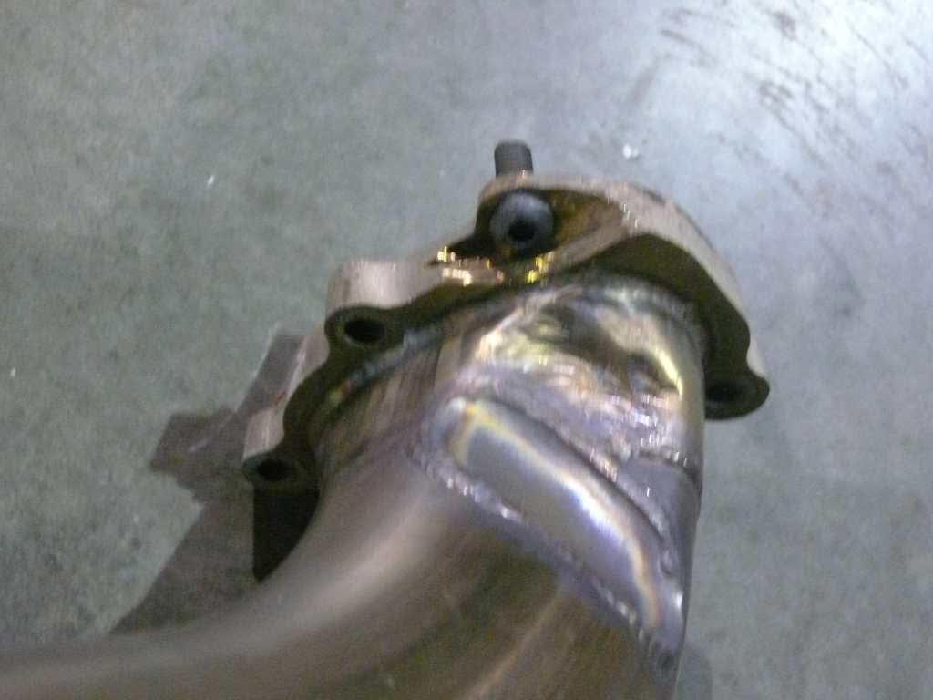

2) The metal around one of the mounting holes on the Driver's side wastegate has been broken/cut off. Basically only half of one of the bolts was pushing against anything. Sam confirmed this as well.

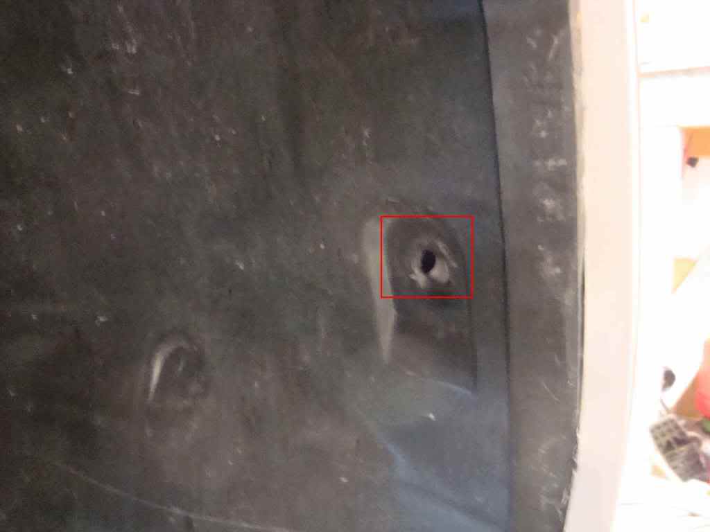

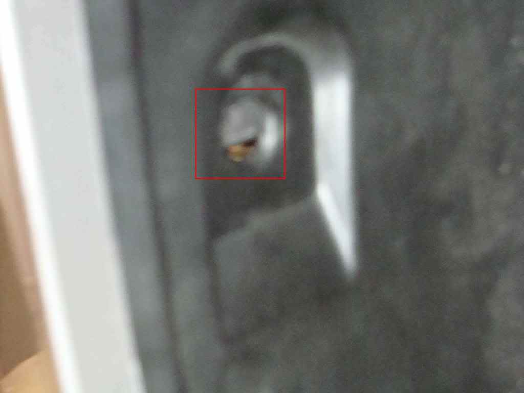

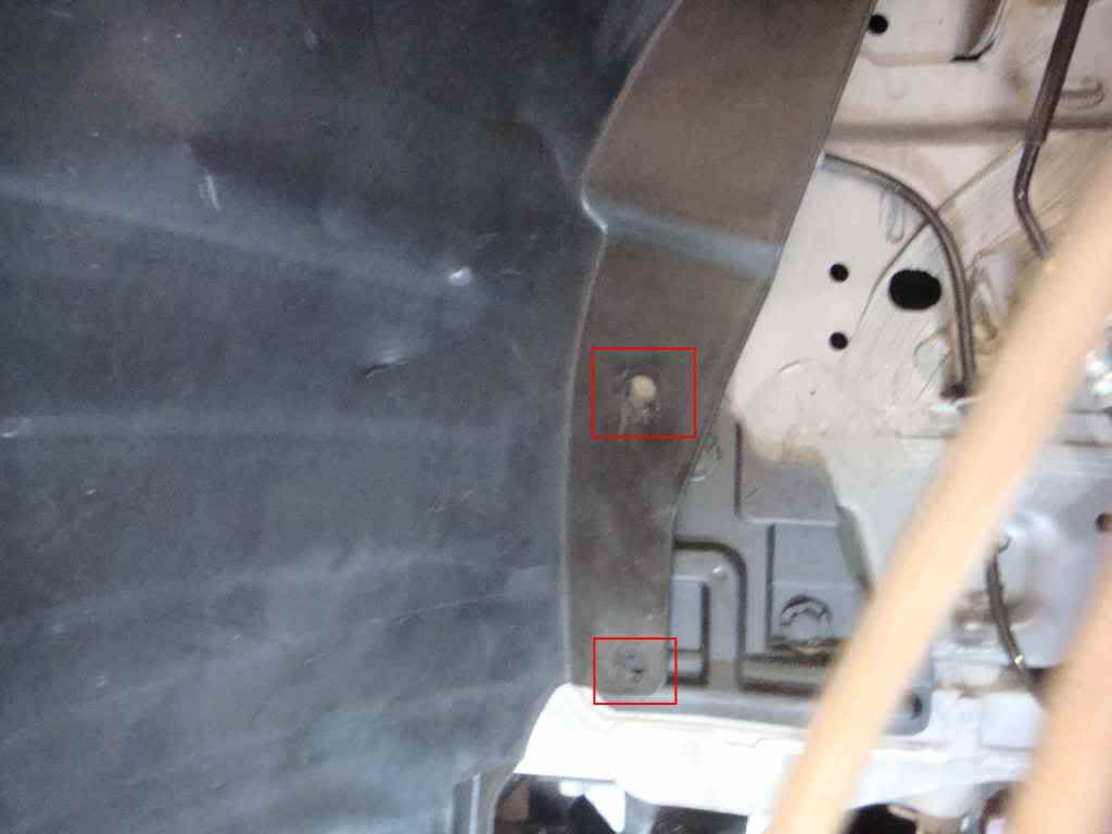

6) The Drive's-side front inner-fender was missing two snap clips (the ones in the back to the left of the strut). The inner fender was not completely attached due to this and the item above.
7) The Driver's-side front inner-fender is missing a snap clip (the one by the outer edge next the quarter panel). Again, this along with the items above meant the inner fender was not in place as it should be, and the inner portion was so loose it could move around.

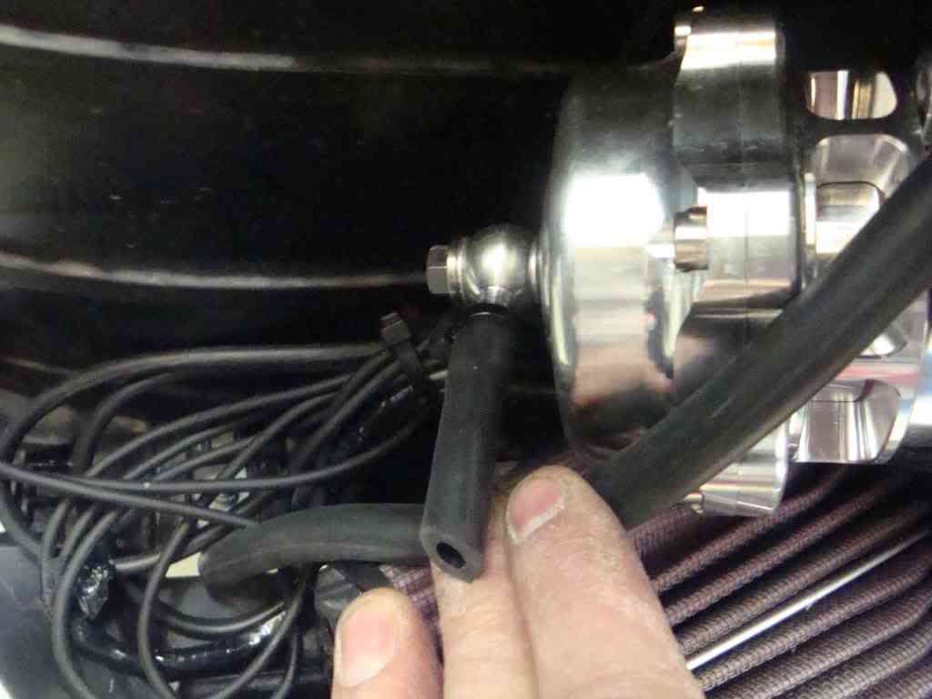

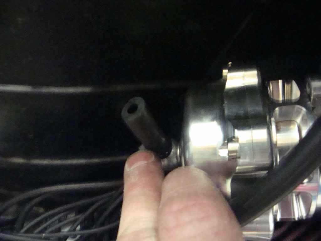

9a) On the passenger's side Blow-Off-Valve, the part where the vacuum line attaches was loose and would spin around freely. I fixed this myself before I decided to send my car to GTM.
9b) Passenger's side Blow-Off-Valve

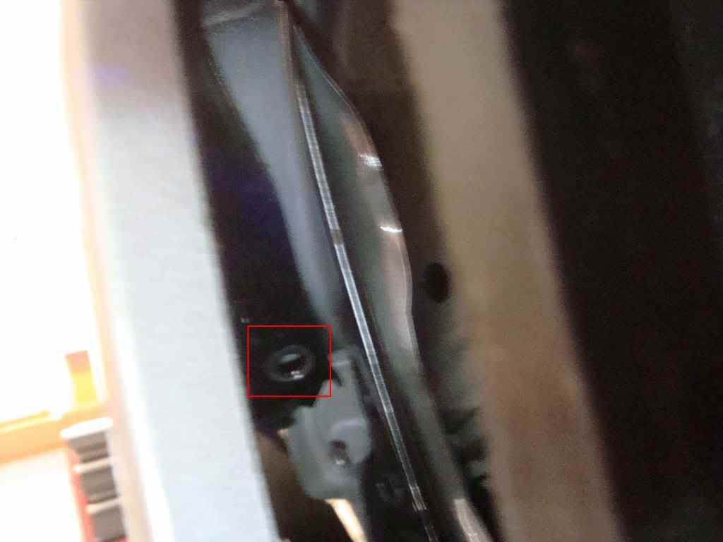

11) The Passenger's-side front inner-fender is missing a snap clip (the one by the outer edge next the quarter panel).

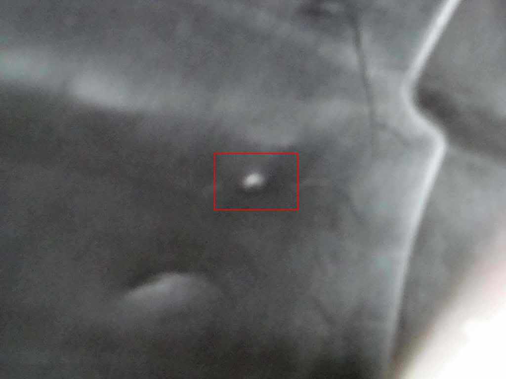

12) One of the two bolts/screws holding the front bumper on from the inner fender is missing on each side.

3a) Put the car on the lift and confirmed that the passenger side Downpipe had been beaten with a hammer.
3b) Downpipe
4) Confirmed that the wastegate support brackets had been cut out.

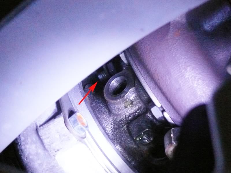

5) Found a loose bolt wedged between the Turbo center section and the Exhaust housing on the turbo.

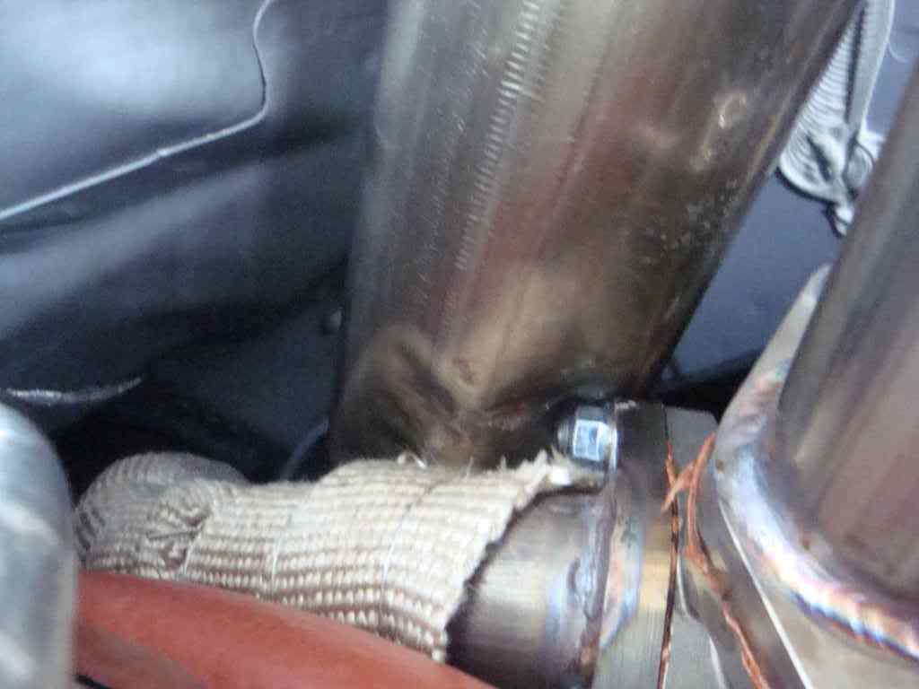

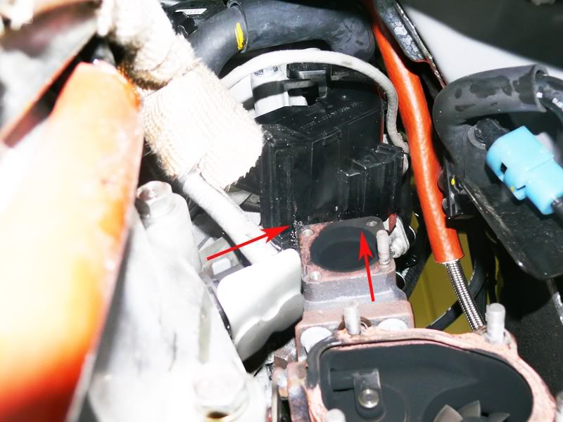

6) Found that the Driver's side upper dump tube has a severe exhaust leak due to the wrong hardware being installed. So, both sides had an exhaust leak!

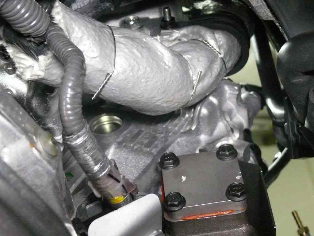

7) The engine harness on the passenger side was lying on the exhaust manifold and had began to melt. This is shown on the picture above that is also showing evidence of the exhaust leak. This was supposed to be moved out of the way and a bunch of heat wrap was supposed to be installed (as shown in the picture below), and it wasn't.

8) This is how it should have been.

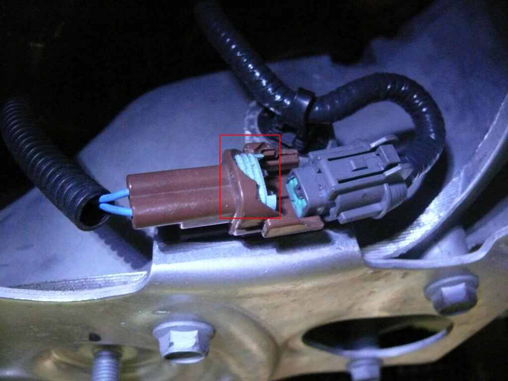

9) The Speed Sensor connector on the Engine Harness has been broken. The portion that was broken is what holds the two sides together. This more than likely would have disconnected over time.

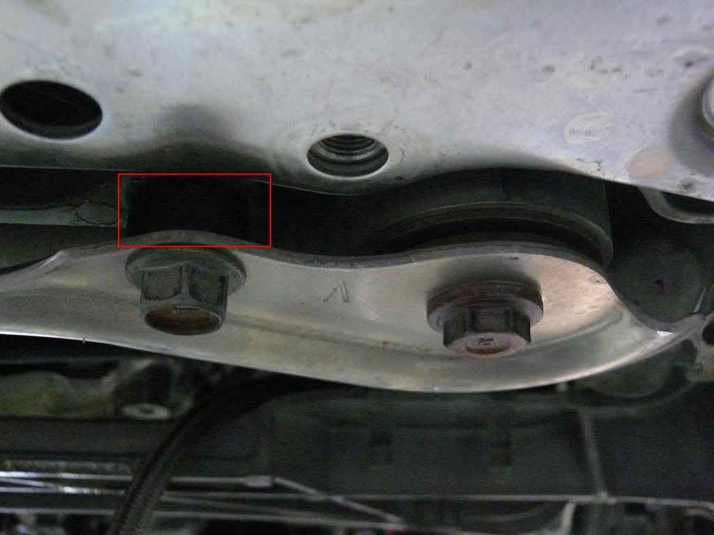

11) The GTM Kit comes with a spacer that needs installed under the Rack & Pinion bracket. They installed it, but put the bracket back on upside down. Due to this, the factory cover that protects the Rack & Pinion was not even put back on.

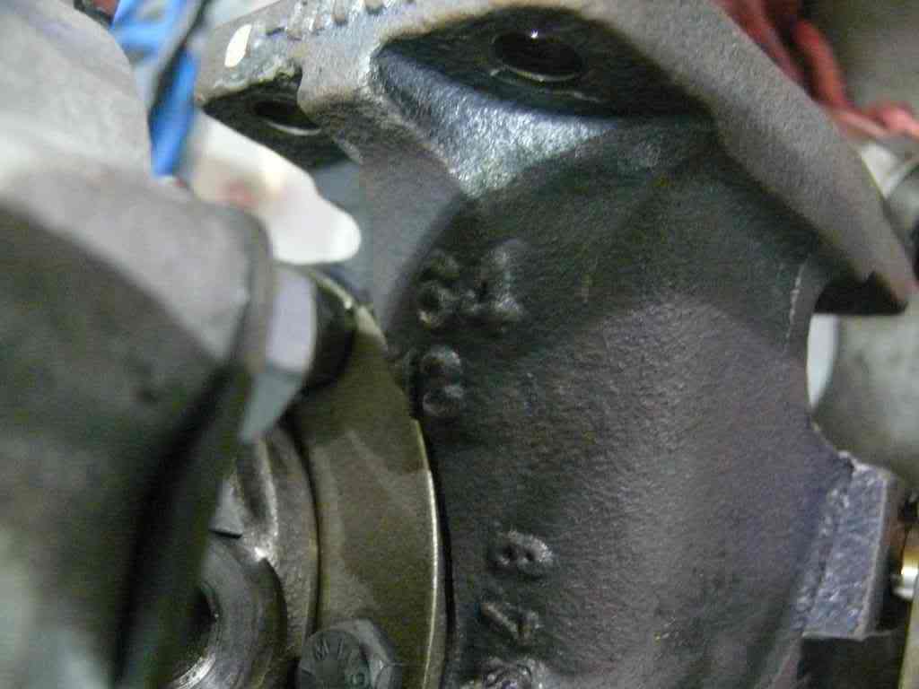

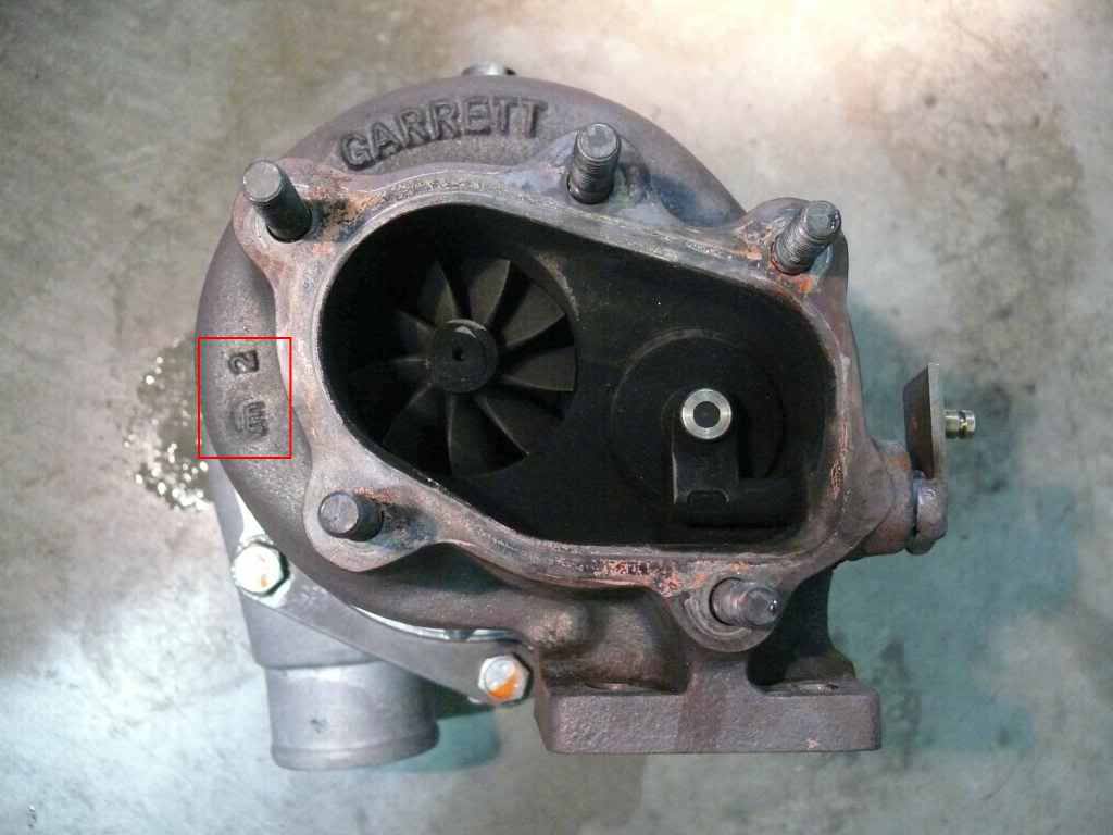

14a) Oh, and the biggie......THE STAGE 1 TURBOS ARE ON THE CAR.....NOT THE STAGE II TURBOS THAT I ORDERED AND PAID FOR.
14b) Wrong Turbos
14c) Wrong Turbos
In conclusion, Sam said it looks like a butcher had worked on my car. I know he is not exaggerating, I know a fair amount about cars, and as you can see from above, the workmanship was absolutely horrible.
