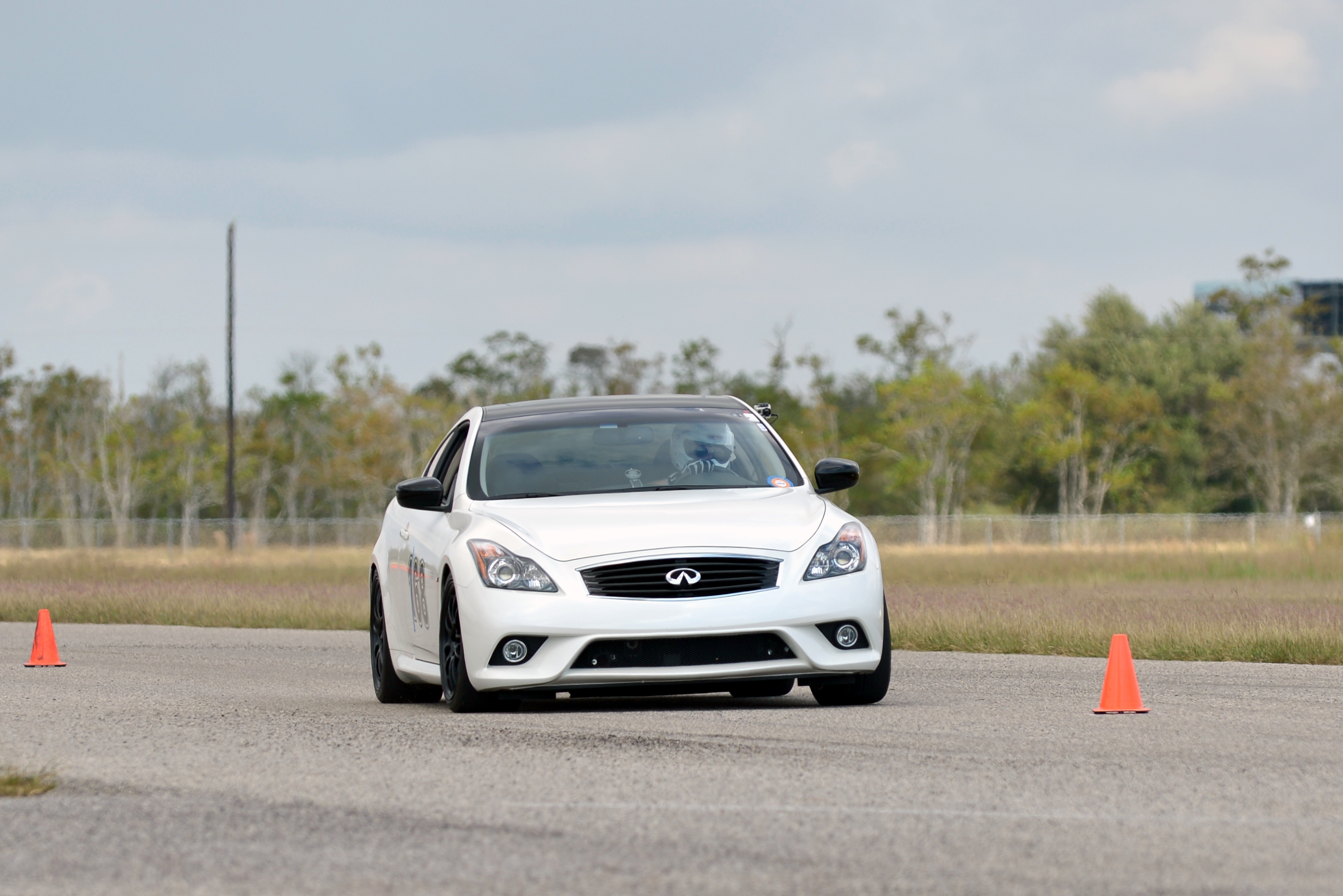

275/35/18 all around here, car handles VERY well. The rears look like they might rub the fender liner just a hair under heavy load, but not causing any issues.
Handling is very great, power steering isn't working too hard by any means now that I fully drained and refilled the system. Had a track day a couple weeks ago and then this a double duty autocross (16 runs back to back, 88 degrees, 5000% humidity) this weekend and didn't get any spill out of the power steering reservoir at all.
Attached Thumbnails The G37S is a great track car-2ah_6183.jpg   The G37S is a great track car-2ah_6185.jpg

Admire my cropping skills.
Car is turning left pretty hard here, hence the wheel gap
Attached Thumbnails The G37S is a great track car-screenshot_20171107-151226.png
