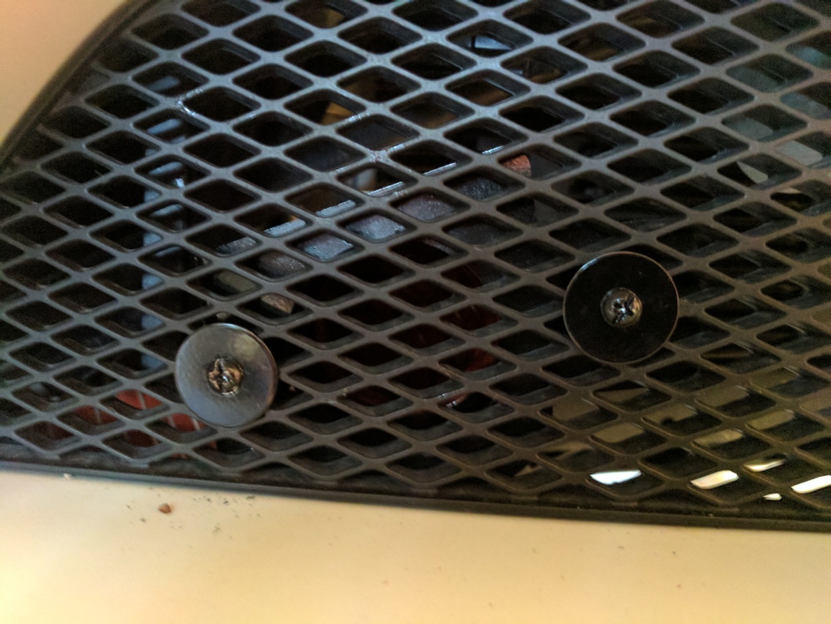

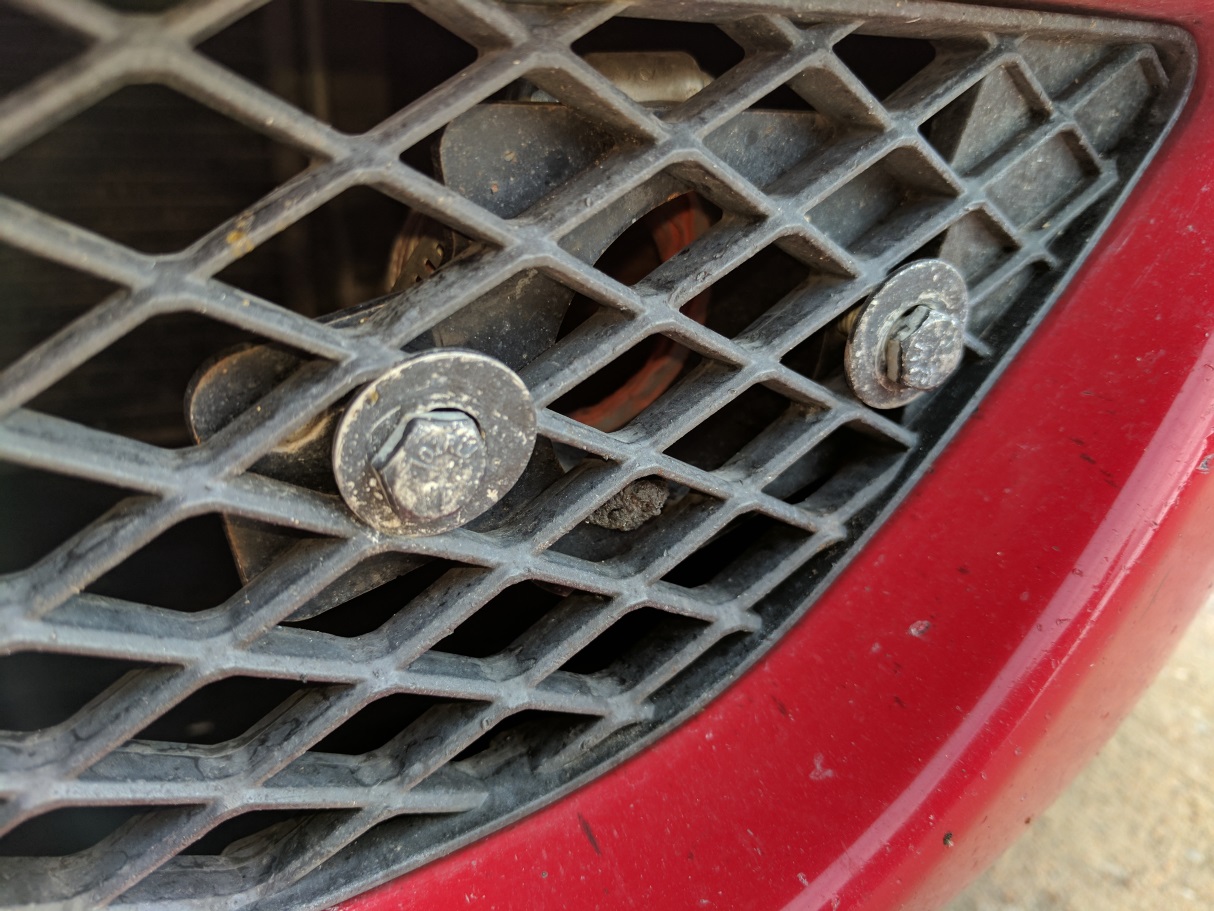

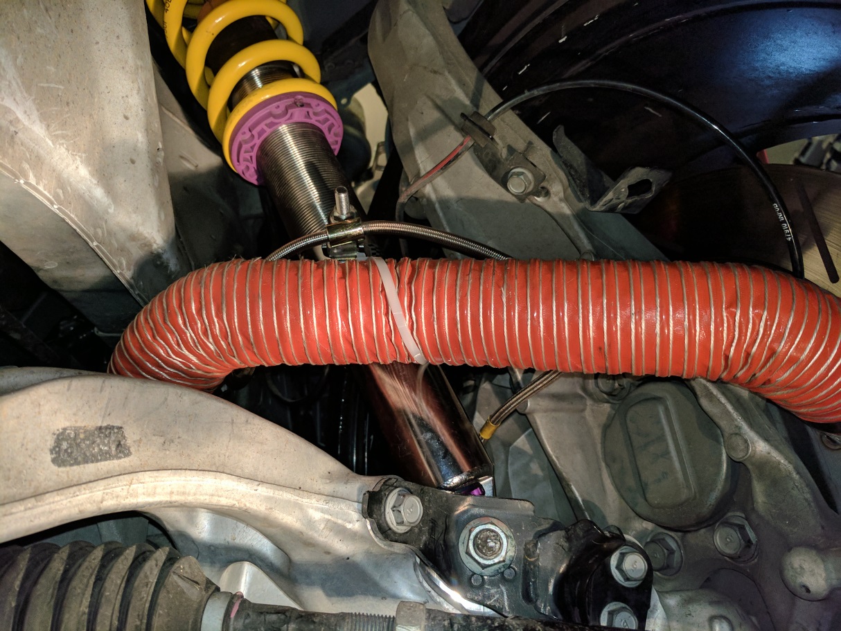

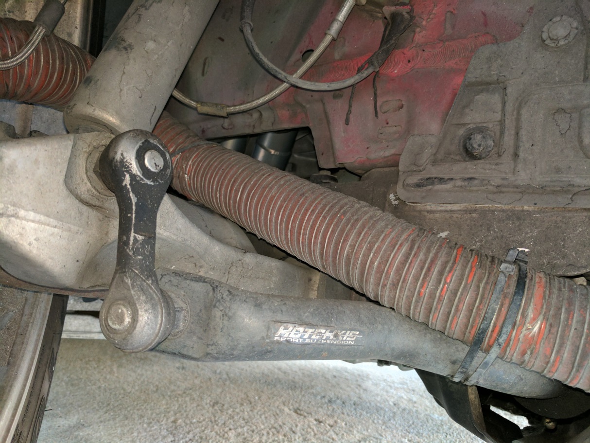

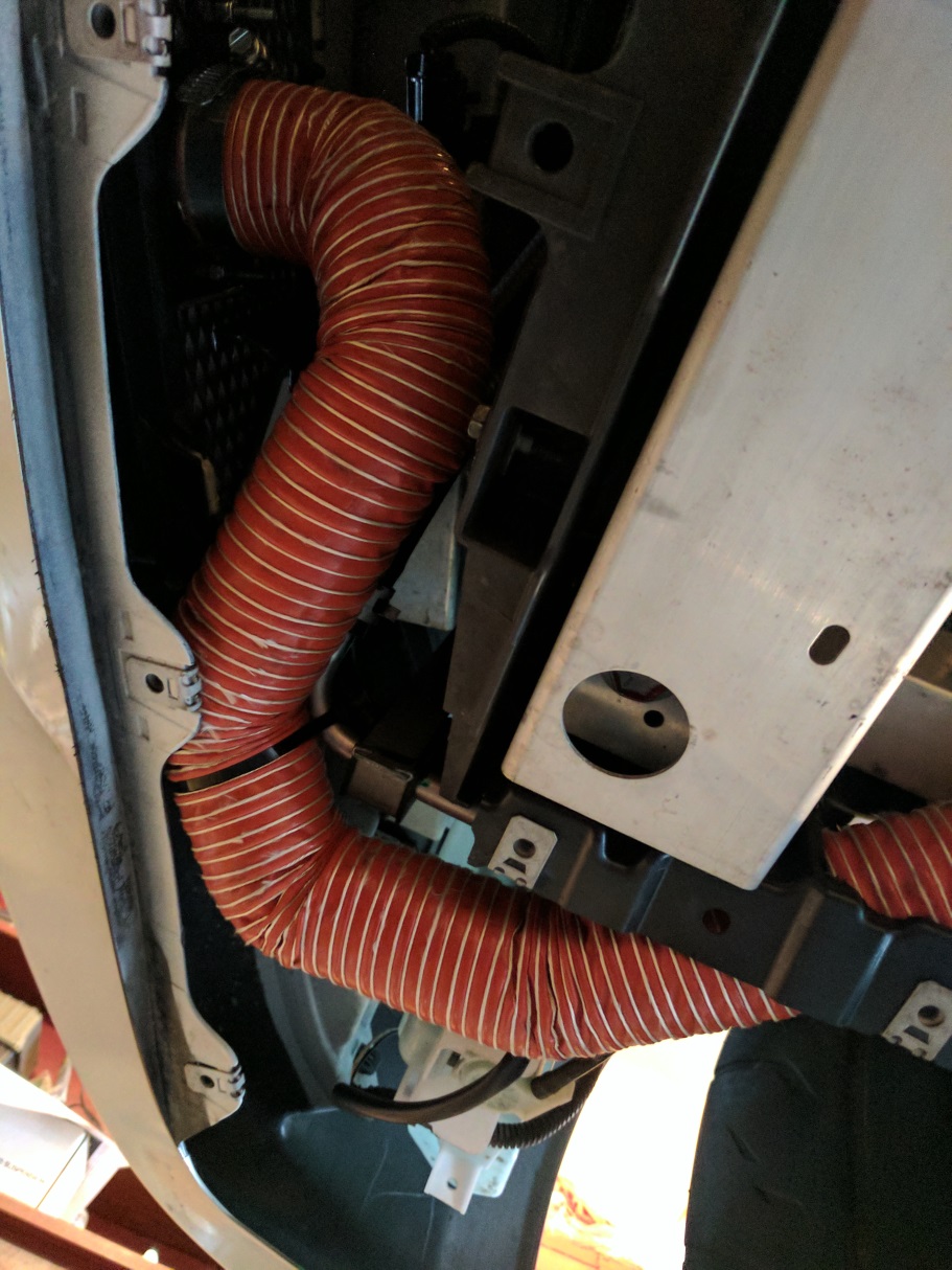

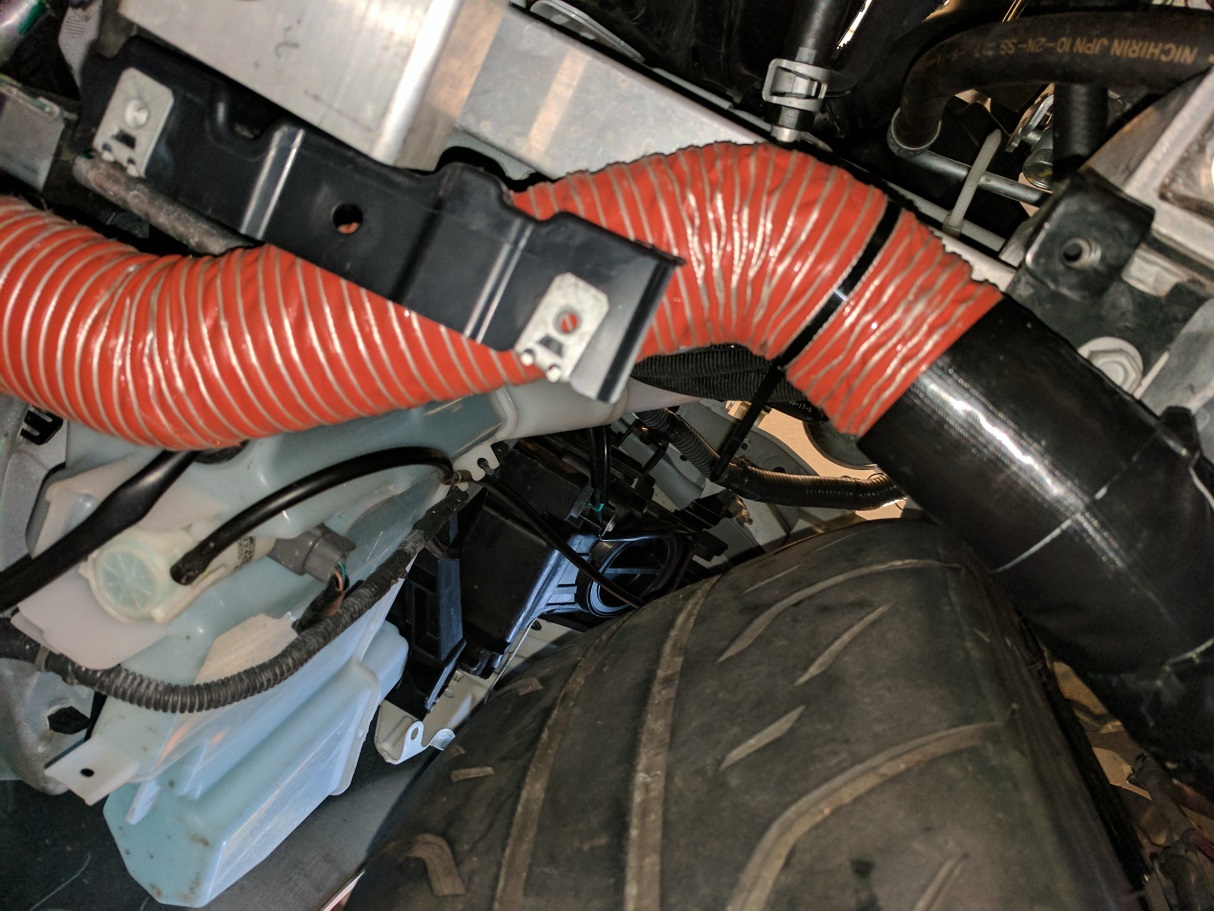

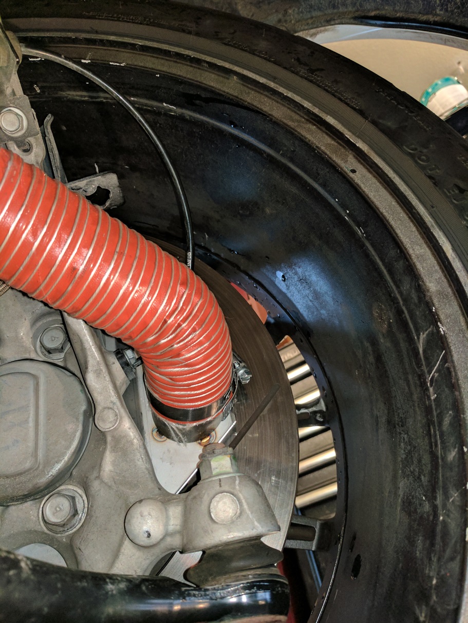

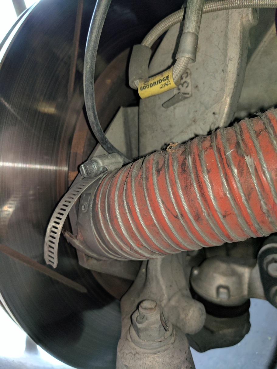

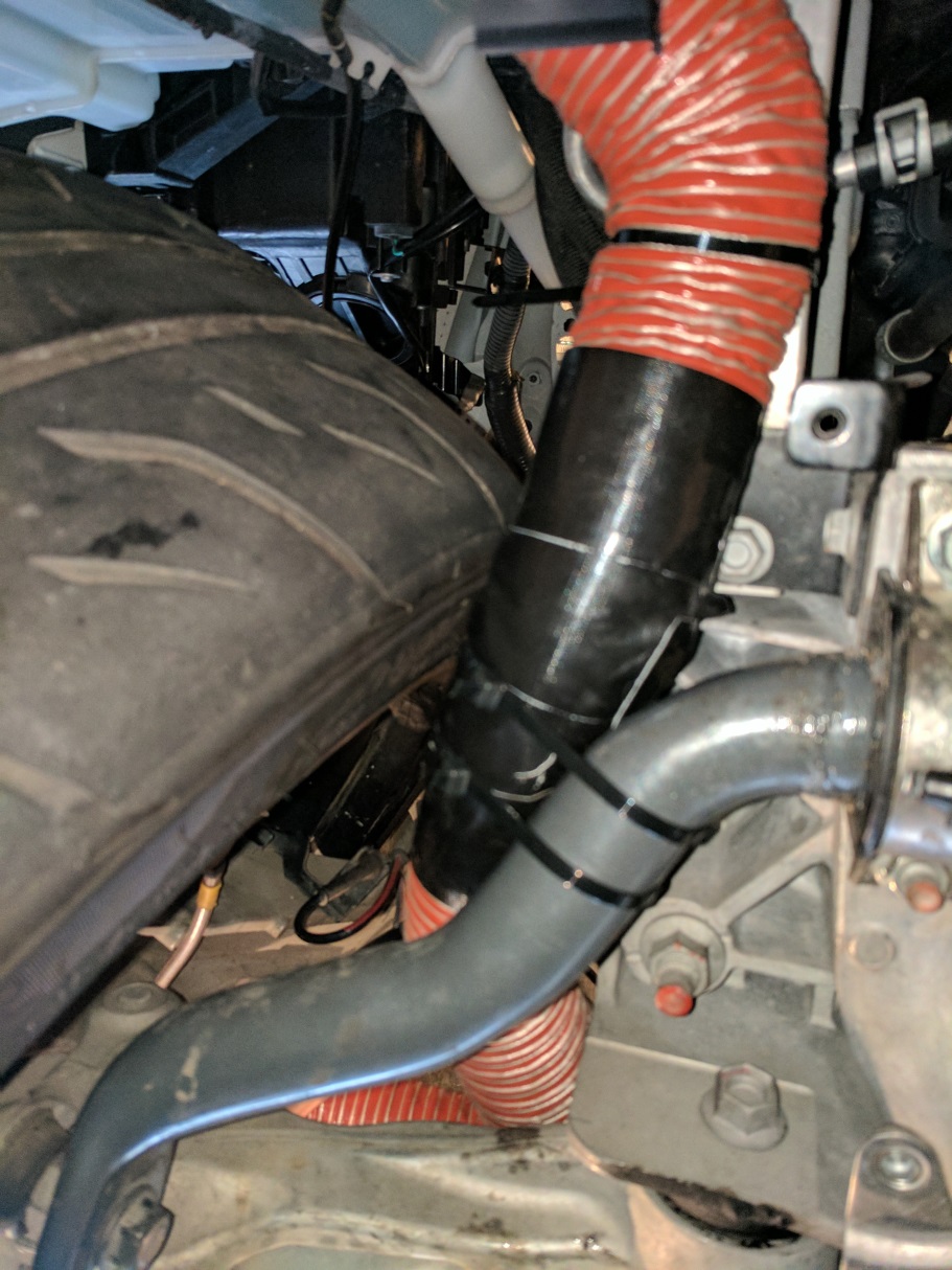

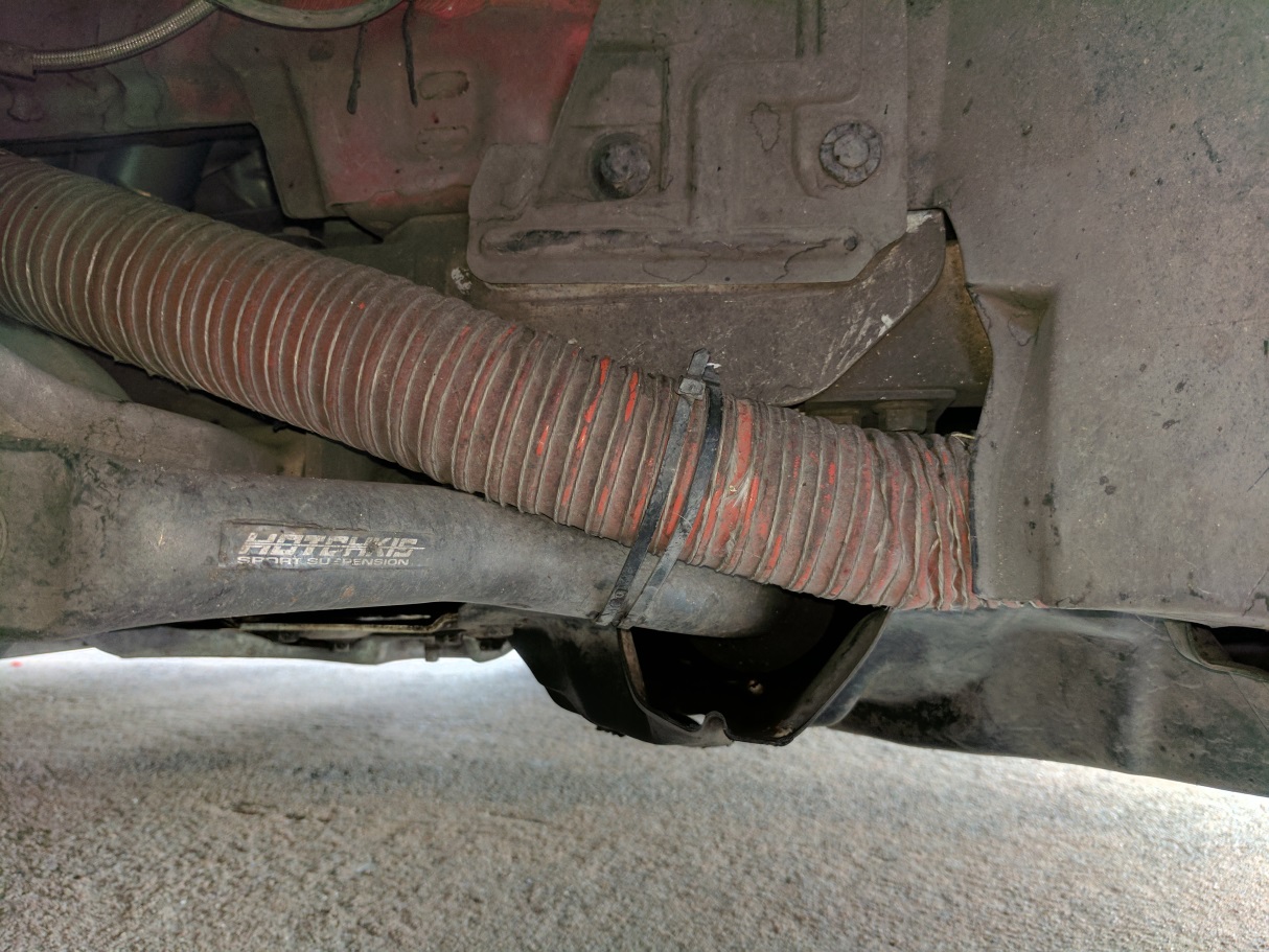

I don't know how we save these for reference, maybe make it a DIY page? Either way, pic attached.
Clean car is mine. Dirty car is a friends, I used his for inspiration and just made it all fit where I could. I could only view his car on the ground 'jacked up' parked on a curb so I don't know what the routing is like under the engine shroud, but I really didn't like how low his hangs, it's about 3" from the ground MAX. His is a track only car, so it's less important, but I wanted to maintain ground clearence. Like I said, 2 of the plastic rivets don't fit - the one by the sway bar, but the shroud is still on tightly. All wheel well trim pieces also fit, without rubbing, but it is all a little tight. After about 6,000 miles I have no rubbing on road or track despite how close it looks with the tyre, that's due to the extra clearance you gain when weight is on the car - pushes the tyre from the sway bar a little.
I only have photos from the passenger side of my car, as the clearance with the washer bottle is the hardest part. The other side of the car is exactly the same tho, just less bends and easier.
I used the stillen kit (non NISMO front fascia) and drilled a second hole in the inlet adapter so that I could run bolts and washers to mount it to the grill. I had about 10" of hose longer than I needed on each side because I did not route a loop around the chassis rails. I tried, but it wouldn't have fit for length anyways due to the inlet ducts being closer to the center of the car than on a 370.
I really wanted to use the fog lights, but I couldn't find a set of fog light plastics for less than $200 per side so I abandoned that idea. I think (know) you wont have space on the passenger side anyways due to the washer bottle.
Getting the hubs off was super simple. 12 or 14mm socket on a breaker bar, using a little 1-2" extension adapter and it was done. Same to put back on. Just turn the wheel fully one way to get the first 2 or 3, then the other to get the remaining bolt. You have to pull the brakes off to do this, so if you are going to do stainless lines, coil overs, rotors, etc. Now is the time to do it and save pulling it all again another time.
A much smaller washer bottle would make this and the oil cooler SO much easier to install!!!!

Nice! Sure is cramped under there. So, the fog light openings aren't usable for the front of the tubing? Darn.
I really doubt it on the passenger side. The wiring loom comes out of the back of the fog light and takes a 90 degree turn to miss the washer bottle. There is about 1/4" of space. You can see it in one of the shots where I show the tubing routing around the plugs on the bottom of the washer bottle.
Like I said, if you had a smaller washer bottle it would be MUCH simpler. I have toyed with the idea of purchasing the stillen washer bottle that comes with their intake kit. I don't think they offer them seperately and I found one second hand but they wanted crazy money. Plus, like I said, fog light plastic trim is EXPENSIVE.
Would look neat, but $500 neat? not to me.
Also, the stillen kit comes with 2" tubing and that is about all that will fit along the route I used. Any thicker and it'd be crushed through a few of the tight spots and likely wouldn't clear the wheel at lock.
