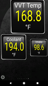

Originally Posted by 4DRZ
I got a new Samsung Galaxy 8 and set up the Torque ap. I can clear CE lights, but it does not read the codes anymore- it tries, but comes up blank on the same code it used to read. Worked fine for reading codes on my old Galaxy S4.
Did you ever figure this one out?
I haven't used torque in a while and wanted to log oil temp this morning, but the VVT temp has disappeared from the custom PID screen. In fact, there used to be 11 or so custom PID's, but now only 4.
Nothing I do seems to be able to find it but it used to work just fine. I've got a Pixel so I'm wondering if it's a newer version of android thing, will have to try out another phone and see what I can figure out.
**EDIT** - Deleted and reinstalled the plugin and now the custom PID list is about 20 strong. Will update once I connect to the car and check if they read anything.
**EDIT** well, that fixed it. Chilly weather out, almost time to block off the oil cooler.
Attached Thumbnails The G37S is a great track car-screenshot_20171024-112153.png
