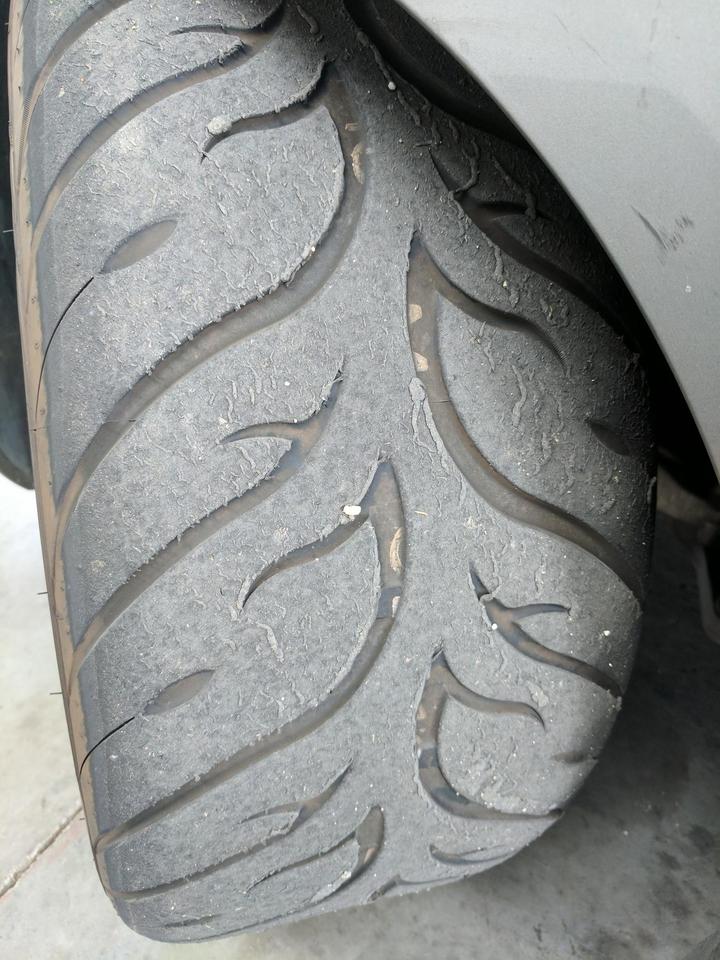

The tires have been good for me in the rain. It is the perfect tire for me for mostly daily driving and the occasional track day. I drive fast and smooth so even on one really technical track we have close by, I tend to get a little more life out of my tires. If you were doing a lot of track days you might want to get a dedicated slick for the track and then use these for the street or track days when it rains.
Haha there isn't much context but the BMW driver spent most of the day trying to go sideways rather than try to set a good time.

Also, I'm having trouble getting these tires to roll over better lol.
