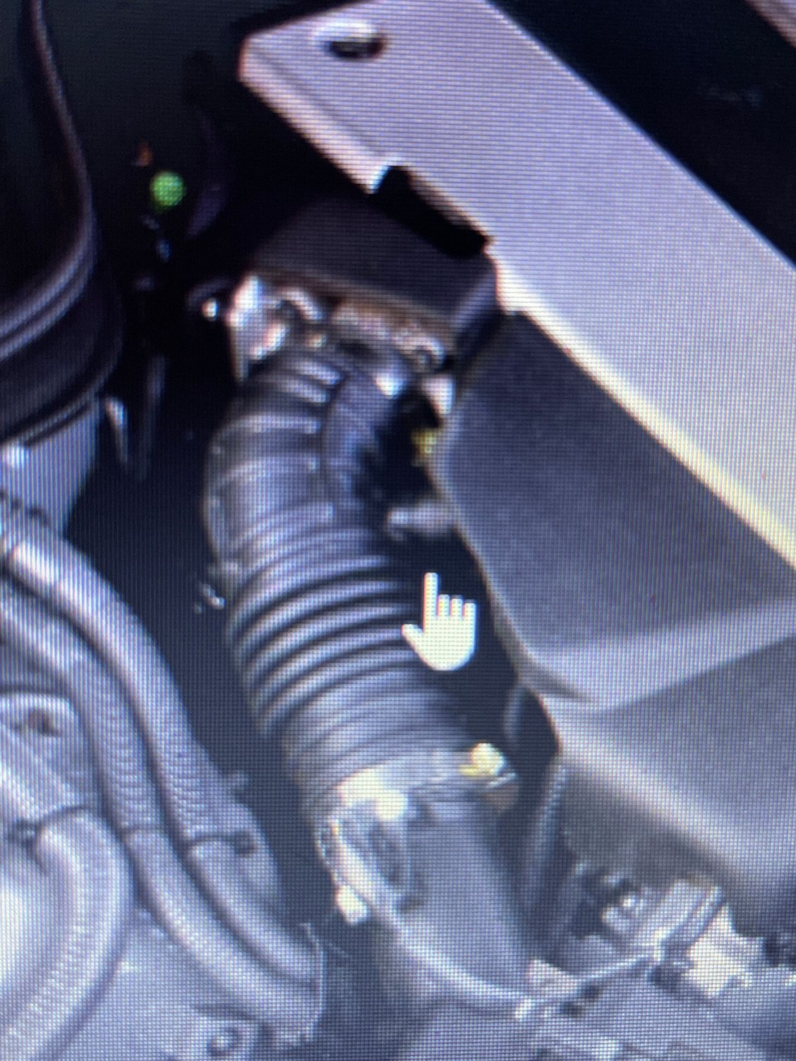

Check your PCV valve. If it is stuck open or closed it can throw that code. Also look for any vacuum leaks in your air intake.
Is that the little line connected to the intake that goes into the engine?
The line where the cursor is pointing at?
