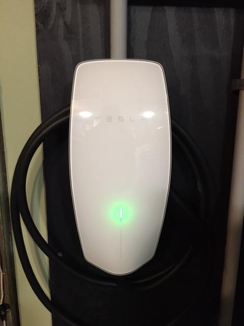

I'm still here on my third Infiniti and still using regular 87 octane since December 2005 when I purchased my 06 G35 6speed. My current Q70 runs just fine and I get excellent MPG on road trips.
My visits to gas stations are numbered as later this year I'll be charging in my garage.
It will be interesting to see how long the premium users stick to it when it reaches $8.00 a gallon?
