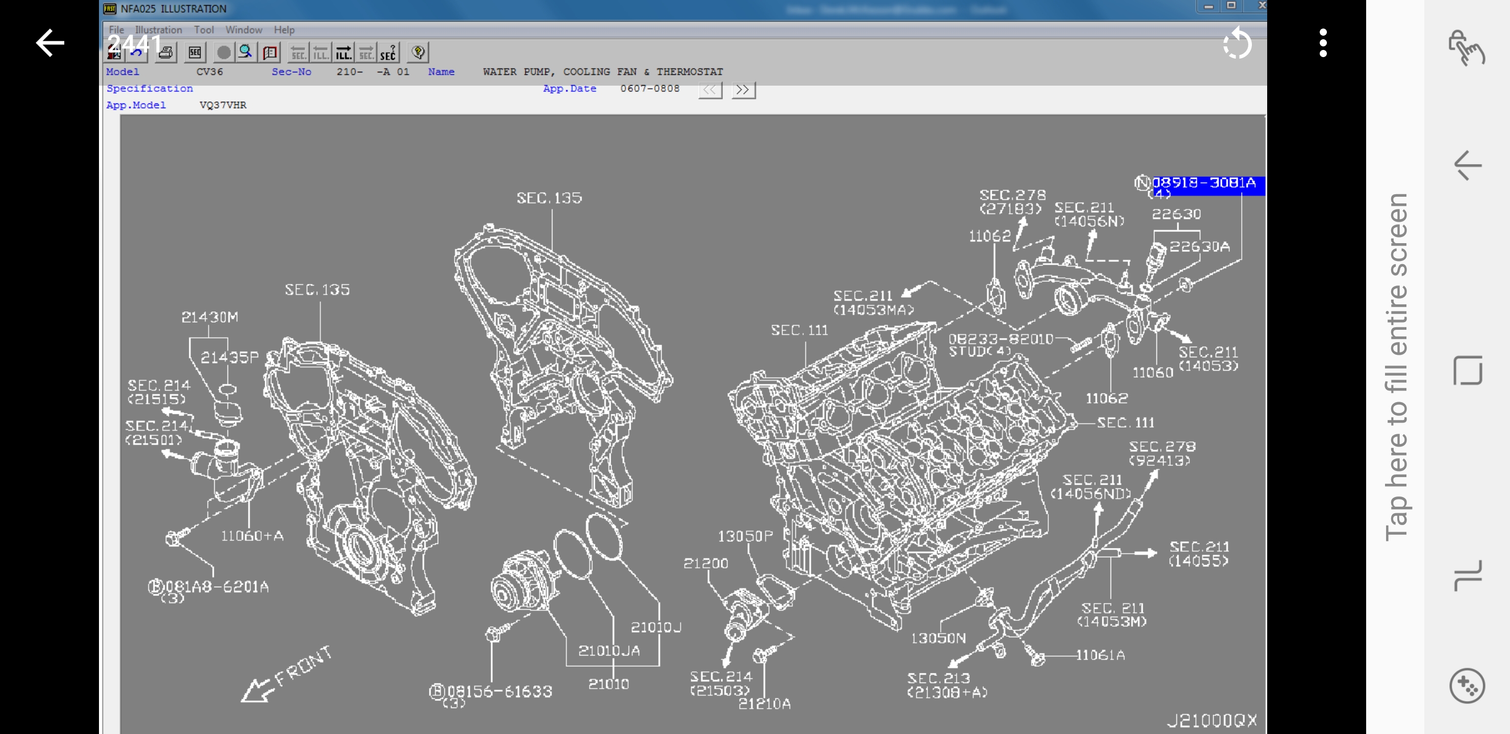

Sorry for just responding . No i have no overheating, no bubbling at all. So now i am thinking its the coolant temp sensor. But honestly i have no idea where it is. I cannot find anywhere on internet where its located. frustrating man

It's on back side of the head toward driver side. Grubbs is emailing the part spec sheet that shows where it is part cost is 41 bucks

Old Jun 7, 2018 | 10:33 AM
rudeboyride's Avatar
rudeboyride
Posts: 24
Holy Crap man.. So I got to take off the intake manifold to get to this thing? Man that sucks!!!!!
