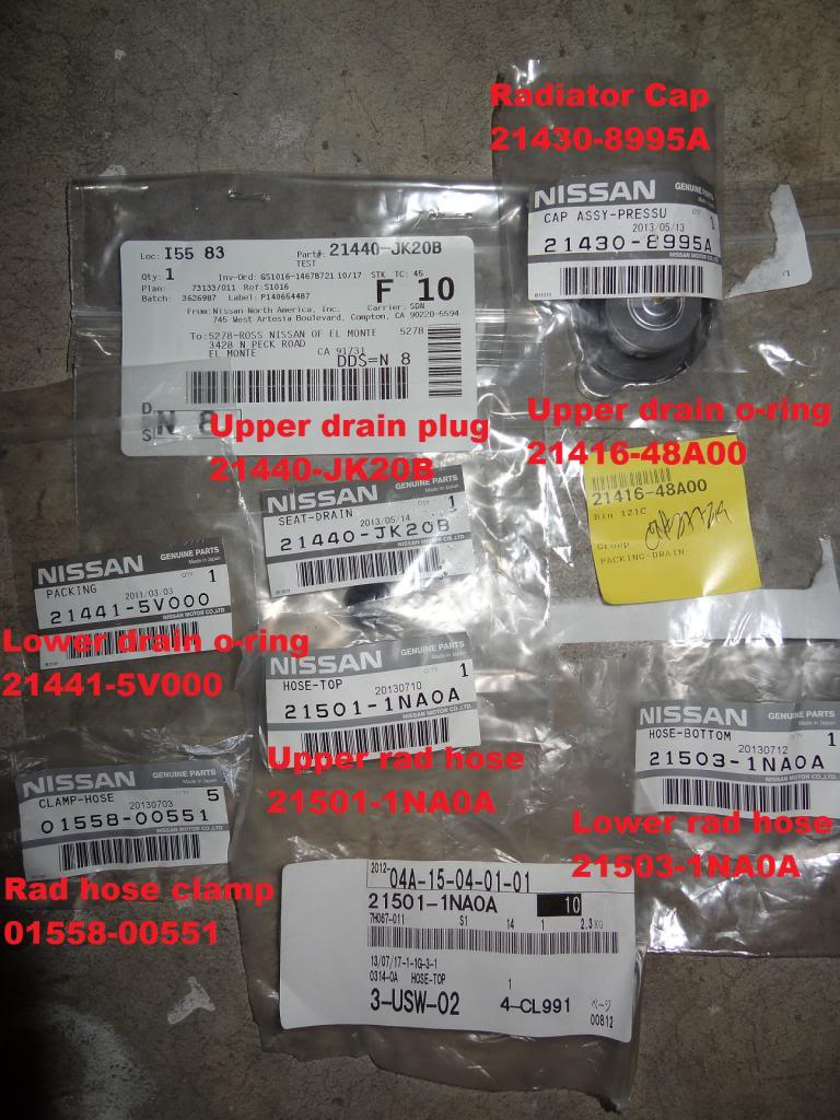

Ok so I guess I will make myself useful and share some of the info that I've gathered. Below you will see parts that are essential and necessary to flush your coolant and/or change your hoses. Please note my vehicle is a V36 3.5L Sedan.
Things you will need...
Nissan Coolant 1 Gallon (Green = concentrated or Blue = 50/50 Premixed)
Distilled Water 1 Gallon
Spill Free Funnel
Radiator Cap (21430-8995A)
Upper Radiator Hose (21501-1NA0A)
Lower Radiator Hose (21503-1NA0A)
Radiator Hose Clamp (01558-00551)
Upper drain plug (21440-JK20B)
Upper drain plug o-ring (21416-48A00)
Lower drain plug o-ring (21441-5V000)
Per FSM, you must change the o-ring but I find that it's not necessary. My vehicle has 50K miles and the o-rings are fine. But they are cheap to replace, so why not? All these parts can be had at any Nissan Dealerships. Infiniti likes to jack up the prices for ALL of them. Many of the parts needed to be special order because they weren't popular in my area. As I've mentioned, all the parts can be special ordered at any Nissan Dealerships.
Also, I was only able to drain out 1.5Gal but I filled it back up with exactly 1.5Gal. Another note I would like to share is that the upper drain plug will start to overflow at roughly 1.2Gal, so have your plug handy and screw it on when you see coolant dripping out.

thanks for the parts info man. nice!!
the part about the upper drain plug. this is the one by driver side headlight? i understand it will pour out when filling the coolant / radiator but does it stop coming out of the upper drain plug when you stop filling the radiator until you can screw that upper drain plug in & continue to fill the radiator?
