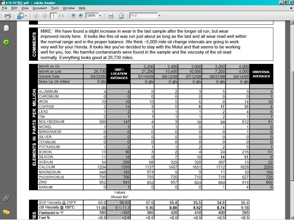

Every oil change I do gets a UOA done, on every car I own. My statements come from solid facts. Unit 6, on that particular car, is 300V. It is in line with every other 300V sample I have seen, regardless of engine make and model.
In fact, I UOA my differential and transmission fluid too.
Old Sep 4, 2009 | 11:49 AM

Mike thanks for the info' and the effort. You seem to want to make
a point that I am somehow missing. This information is useless to
VVEL 3.7 owners. I respectfully disagree with your statment that
infers the same results will be had with that oil in any engine.
You're neglecting that it's a Honda and not a 3.7 and that's what
all of us here want to see. FYI, you can get as good or better
results in that engine with Rotella T-syn 5w40 for $19 gallon with
a 5k OCI. .....Jon

The Shell Rotella T-Synthetic is a Group III Base-stock oil. Every Group III base stock oil I have ever used experiences shear. Shear causes operating-temperature viscosity to drop, resulting in insufficient lubrication.
In addition, it is a 5W40, which neither the F22C, nor VQ37VHR is designed for. The engine specifies a 30 weight operating temperature oil. Using a heavier oil does NOT provide additional protection, as the engine tolerances are specifically designed for a 30 weight. If your engine (and oil) temperature were to exceed the normal operating temperature, your engine oil would continue to get thinner, and the 40 weight would theoretically provide extra protection (provided that the oil isn't already breaking down from being too hot), but that is why the VQ37 has a limp mode that activates when oil temperature reaches approximately 240 degrees.
The reason I use 300V is that Group V base stock oils are proven to have zero shear. It does NOT break down under extended high-rpm, high-load use. Every oil analysis of 300V shows the same result, regardless of engine make and model. I have seen UOA of this oil in EJ20's, 4G63, B18, F20C, VQ35, VQ37, 2JZ, etc, and all show the same result. The oil simply does not break down (provided that you're not doing something stupid and letting oil temperature skyrocket).
Similar results will be had with ANY group V base stock oil. This would include other premium brands like Eunos and Amsoil. (sidebar: I don't condone the 'ultra long OCI' marketed by Amsoil without UOA). Motul is simply the most readily available oil to me, and I happen to receive a price break on it due to the volume I purchase it in.

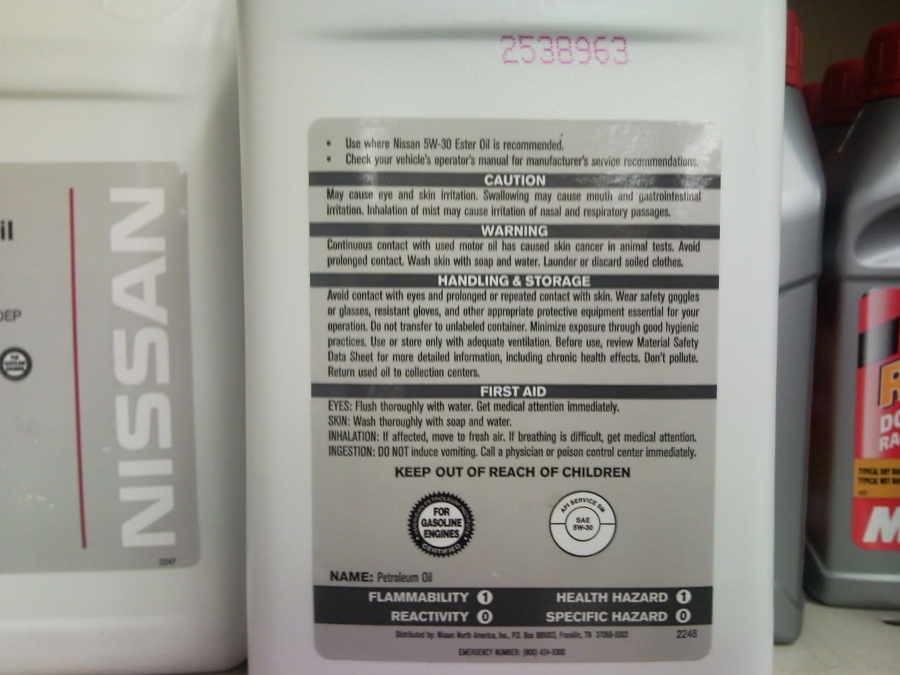

The Nissan Ester Oil, which constantly comes up, is simply a regular oil with ester additive. Patent applications for the oil were denied simply because there is nothing 'new' about the oil, other than the sticker. Oil additives are used all the time.
