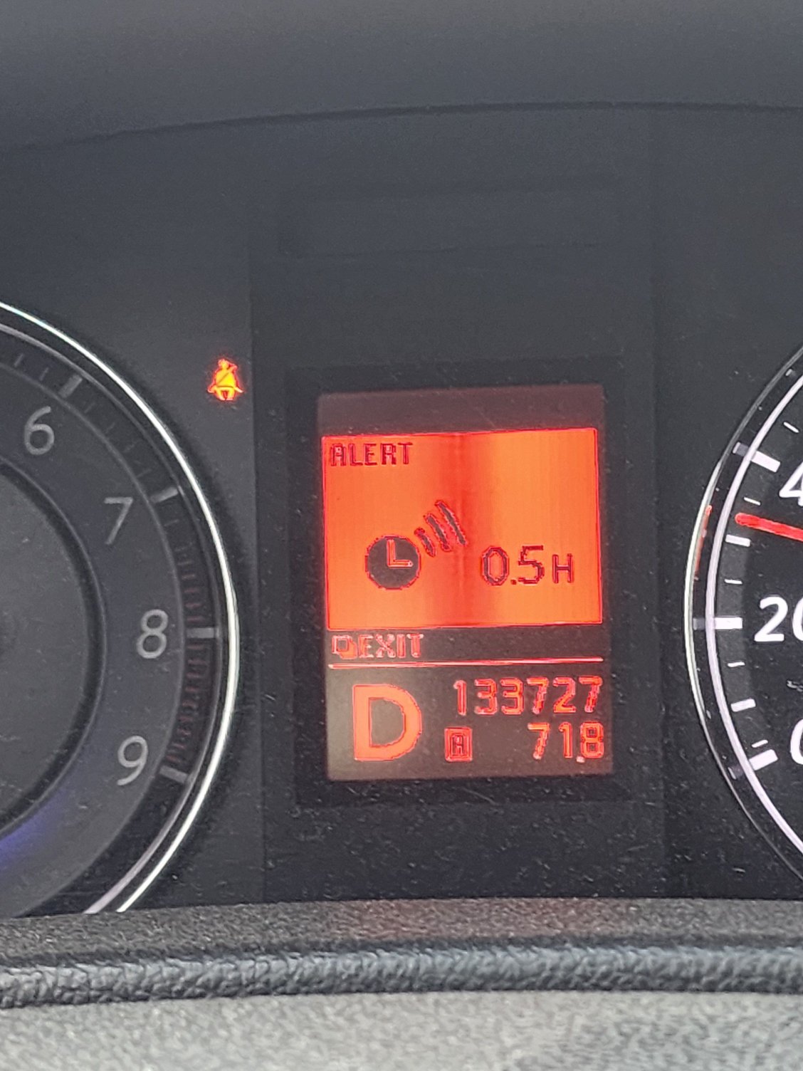

Ok I'll give it a try. It's just odd because I'm getting different kind of alerts as well on the dash that I've never seen before. The temperature logo seems different and what looks like a horn setting has popped up if I'm reading it right

Well now you are talking about an entirely different set of symptoms. Elaborate on what the car is telling you/ post pics of idiot lights, messages, etc.
Old Mar 27, 2024 | 06:30 PM
Infiniti7's Avatar
Infiniti7
Joined: Jan 2010
Posts: 529
yes i know I is two different things but I just didn't know if this may have something to do with it as well. Maybe not though. Never seen this before on my dash

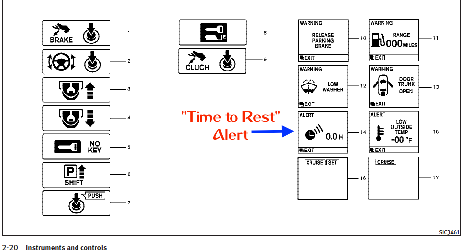

Old Mar 27, 2024 | 07:43 PM
ILM-NC G37S's Avatar
ILM-NC G37S
Joined: Apr 2014
Posts: 4,856
Likes: 1,612
From: NC
Ok, that is the "Time to Rest" alert. This can be set by drivers who are on long road trips to remind them that it is time to take break. I do not think 99% of owners even know it is there and probably 99.9% never used it.
How this got set in the first place is a mystery. Seems maybe someone has been "monkeying" with the cluster/ settings.
This should have zero effect on your horn issue.
