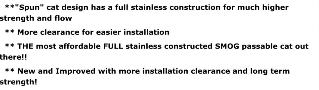

Speaking of HFC, has anyone seen the “new” Kinetix HFC? After looking at their website many times over the past month or two, I noticed they claim “new and improved” as well as Z1 also stating easier install clearance and long term reliability. I wonder what’s different side by side, hopefully still the same as others have said here. Apparently also 49 state compliant, so I guess any shop would be able to install them with no hassle? I know my local shop doesn’t care but my tuner wouldn’t install them if they weren’t legal. Interested to see a new review of some sorts.
