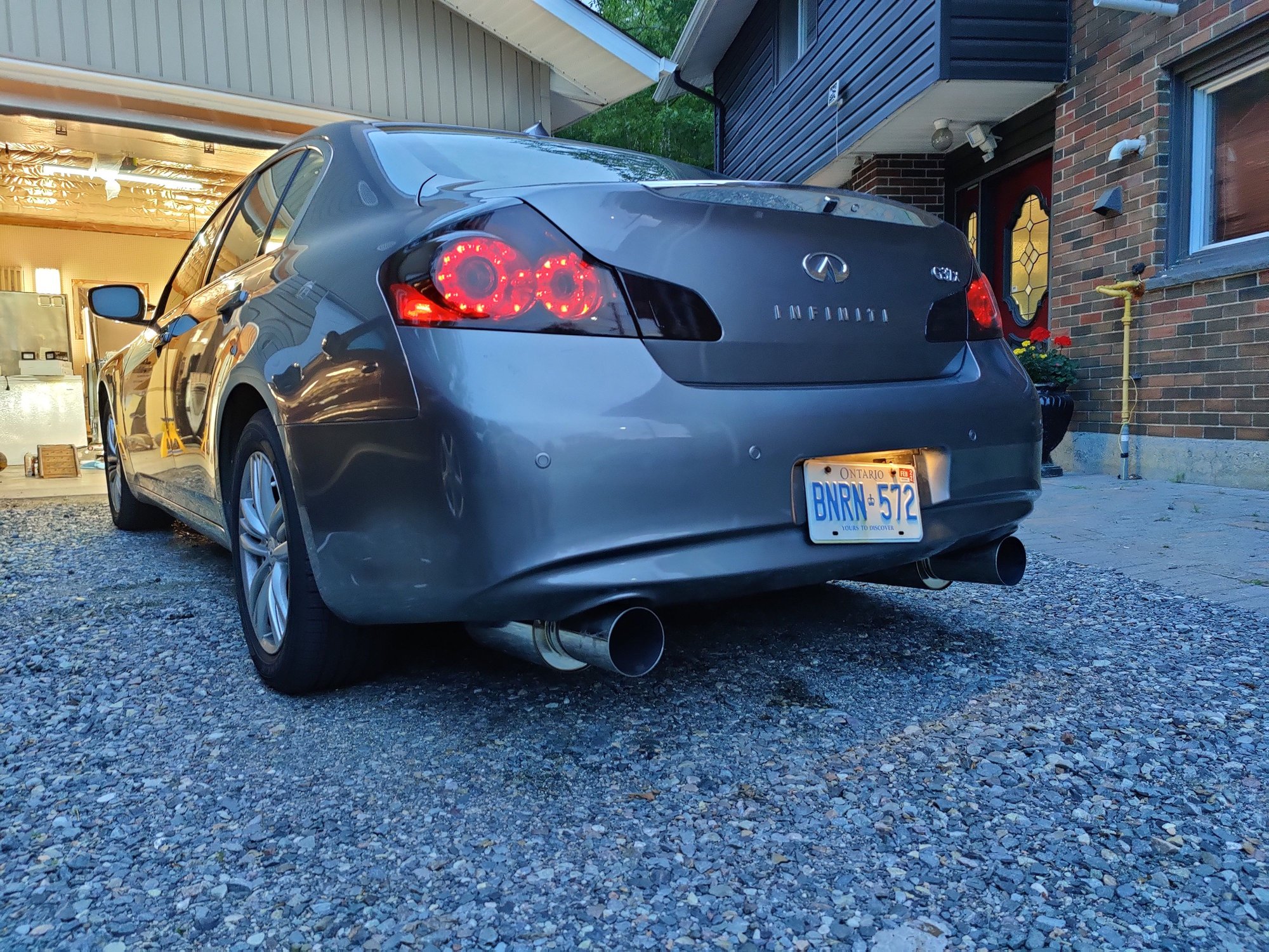

Thanks man!!! Nice ride!! Appreciate the response!
Yup mods are on the way as the budget allows for haha.
Just got my Hks exhaust last night and just put er on. I'm already starting to love it more now!
The one thing i hated going from my 2006 to this is how the 06 was more nimble, easier handling, and easier to zip around town.
The 7spd doesnt allow for that as far as ive seen. But this one is MUCH nicer on the highway and the interior is a big improvement. I love the exterior as well.
Once i get the swifts on i imagine ill be loving the car more. We'll see how the alignment is aftwewards, i imagine ill be investing in a camber kit down the road anyways.
Thanks again!
Thanks again!
Since you put the new exhaust on, and you lack the nimbleness lol, disconnect your battery for like 15 minutes. Reset your windows, seats, mirrors. The tcm will also be back in learning mode. Start driving in manual mode, spiritedly. The car will get used to that driving style after a bit and it will be — while not anything amazing — noticeably more responsive. Grounding kit with ground throttle bodies helps the 7AT a tiny little bit. If you do this, make sure you're not grounding to the negative terminal of the battery, but to the piece of metal that cable from the neg terminal is attached to, before the current sensor. Otherwise, you'll very slowly kill your battery.
Edit: to reset your windows, roll each window down all the way. Pull the windows up and continue to hold the buttons up for 10-15 seconds after the windows go up. That's it, they'll go back to being automatic. You can do all 4 at once.
The exhaust looks great!
You know, that’s a good point you make. I missed that, too, BADLY when I first switched from my 2004 5AT G35. The G37x is significantly heavier and just felt overall sloppier in stock form.
All the mods I mentioned above, plus the ECUTEK tune, has now got this car driving and handling FAR better than my G35 ever did.
