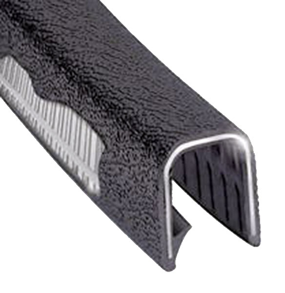

I believe that "flexible trim" piece has metal embedded in it which is meant to keep it in place. I don't think there is normally any adhesive involved, though I could be wrong. (The pic below is of a similar product but with more metal than our trim pieces have.)
I would first try just squeezing it tightly and then sliding it back in place. If that doesn't hold, just a couple spots of silicon adhesive would do, but go lightly.
Your two issues together make me wonder if your rear door and 1/4 panel were rebuilt at some point?
they stick back into the door but every now and then it pops back out while opening the passenger door, which isn't a big deal but is annoying. And the front bumper was rebuilt not the side, I bought the car 3 months ago (just minor issues). Thank you, if it becomes a major problem than I will just buy some Silicon adhesive!
