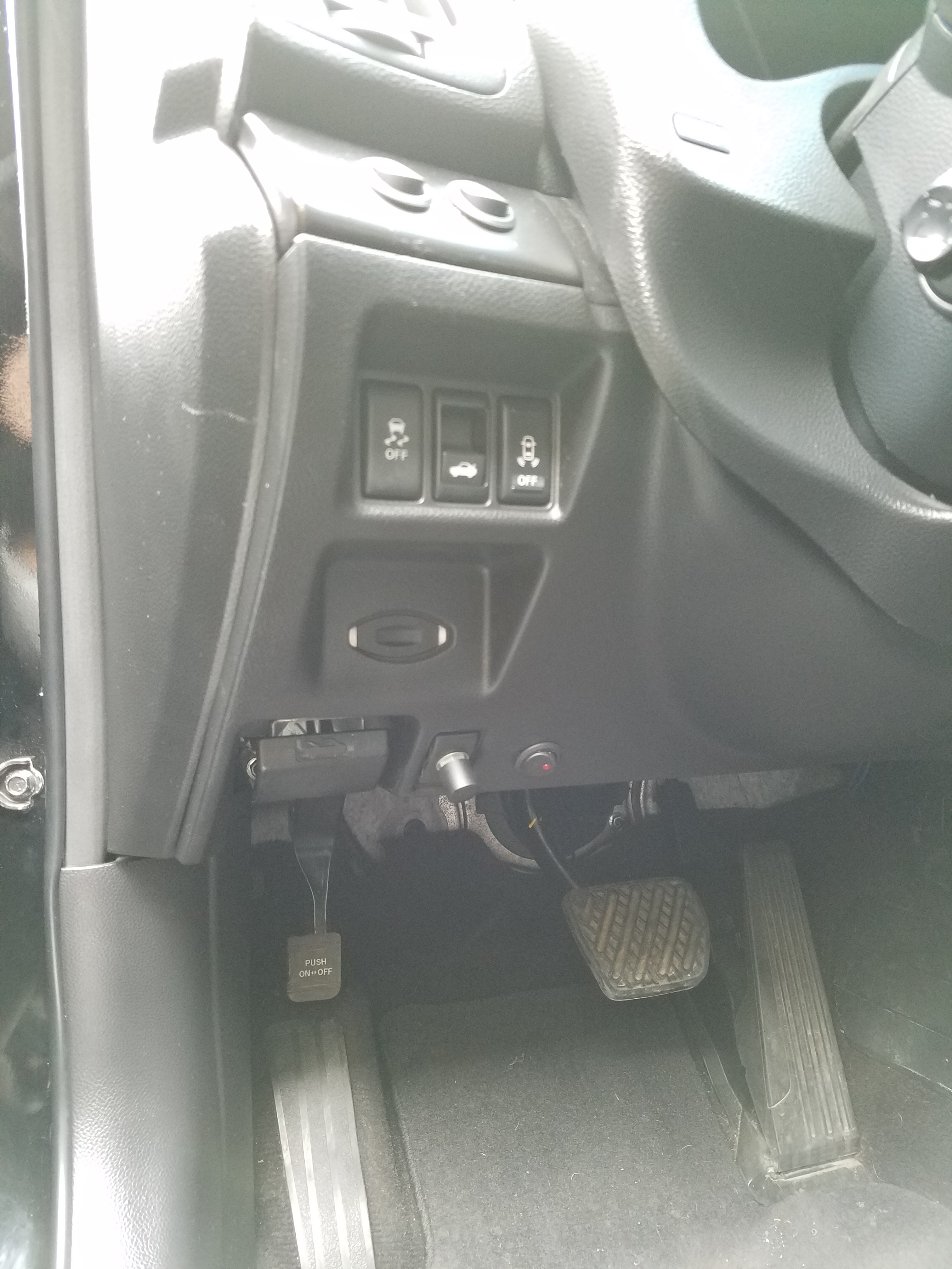

I attached a couple pics of my switches. Top 2 switches are for G-sensor then AWD controller. The one on the bottom next to my bass **** is for the brake torquing that worked great thanks to Lt8Che =]
