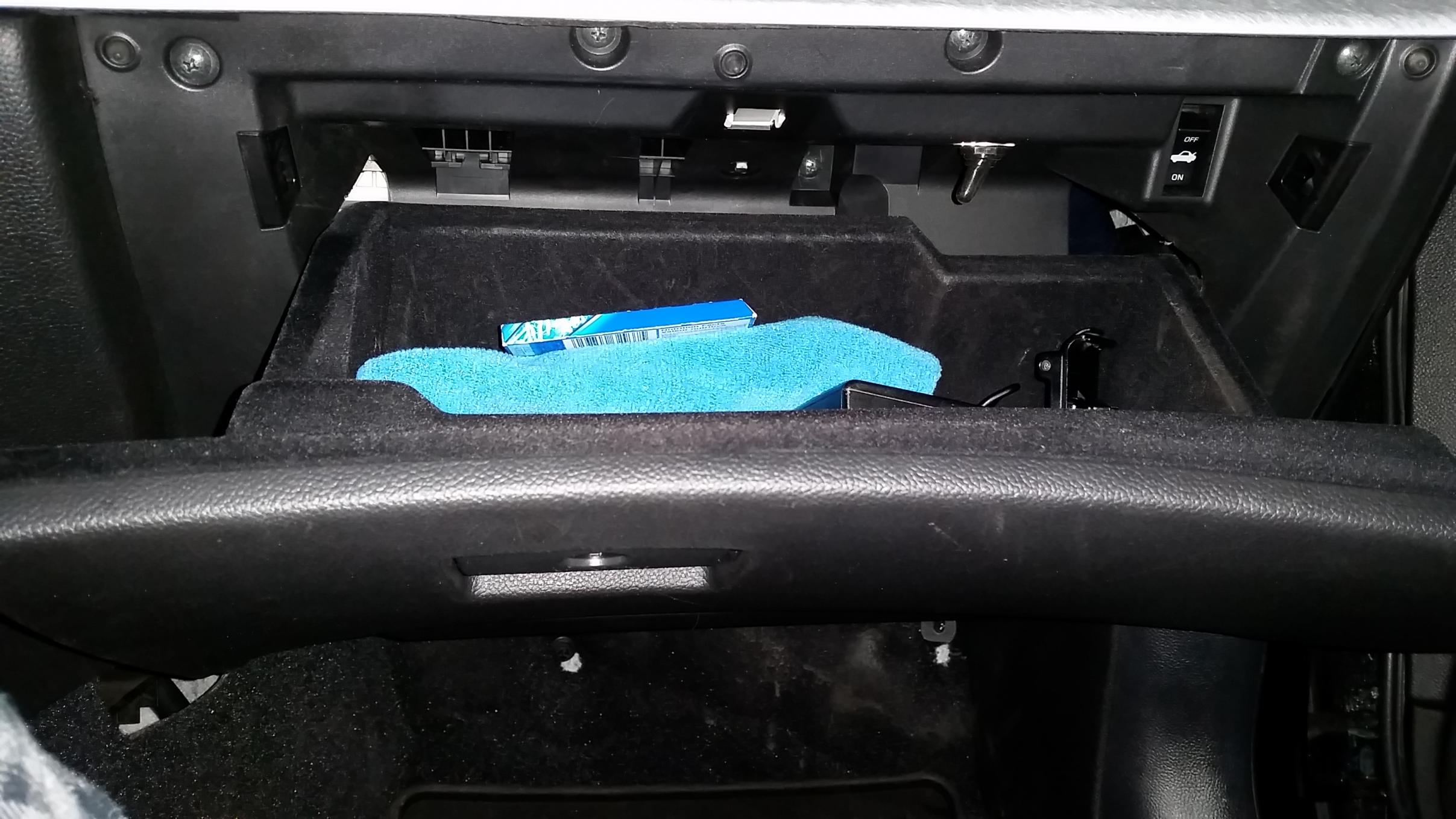

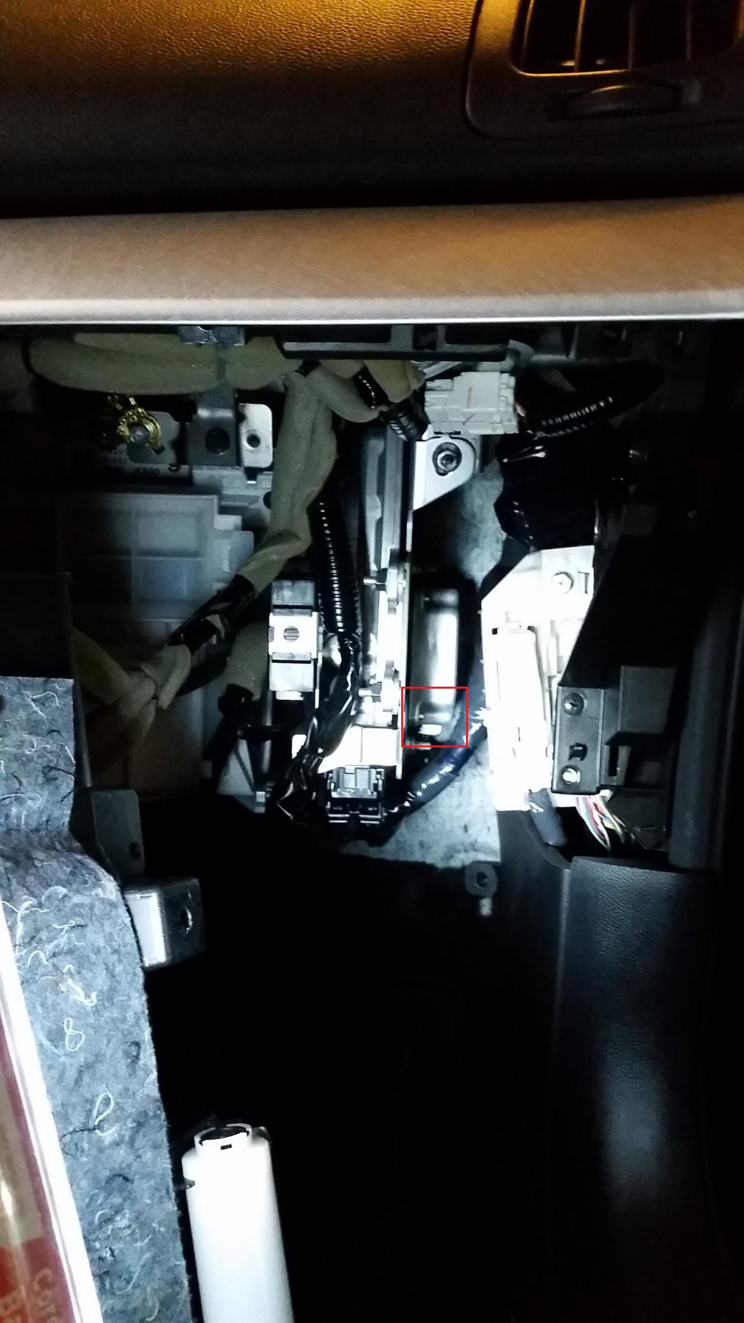

I had to register just to let you know that it's possible to convert our G's into RWD without any parts being removed or modified, so what I did is just rewired one wire which sends signal to ecu on awd and if you disconnect or bypass this particular wire your G will become fully rwd since second generation no matter if it's a coupe or sedan has digital all wheel drive compare to any of these r32-r33 and first gen G where you just pull of a fuse. So step by step
1) you will need some electrical tape
2) switcher (anything and anywhere you want to place, just measure wires to the spot you want)
3) most important knowing which of the trany ecu wire responsible for awd.
So it took me little over 30 minutes from the beginning to the end.
Simply remove your glove box and plastic cover behind it with 7 screws I believe...basically get to that cabin filter I would say.
as soon as you got there find the wire
Wire you need is located on that little ecu circled with red and you are going to cut the black coverage and look for orange wire in corner right beside black, you will than have to strip orange wire which is the one you need and this wire is responsible for sending signal to the front for the awd system. Strip it and connect each wire of your switcher to the each of orange sides, so now you will be able to turn off and turn on your awd. Isolate everything and install your glove box back.
I've been running with this trick for over 10k now and nothing happened, drive hard, even harder now since I can drift and spin tires so my set was gone in 2 weeks...not too quick but still, I run on 20x9.5 so imagine what you can do on 18-19"
Just for you to know you will have your AWD light on and that is not be scared of, it means your awd had been successfuly turned off and now you can crash and smash...be careful since you better not play with switcher while car is on or moving, turn switch on and off while your engine is off and you will be fine, if you didn't get AWD light on dash ON after driving a few meters that means you need to switch it again simply because and is still active and probably your switch is keep passing signal since it's not in off position.
Trust me it's been tested by many people including me, I'm not the one who will mess up with electronic systems if it's not been proven or tested so you can easely go for it and hopefully I saved some buck to you guys
P.s now I have to update my profile and stay here...lol
Btw my car is G35x 2008 sedan auto. (Second gen) and remains the same for all second G's no matter if it coupe or sedan 37 or 35. Let me know if you got any questions regardless this mode.
