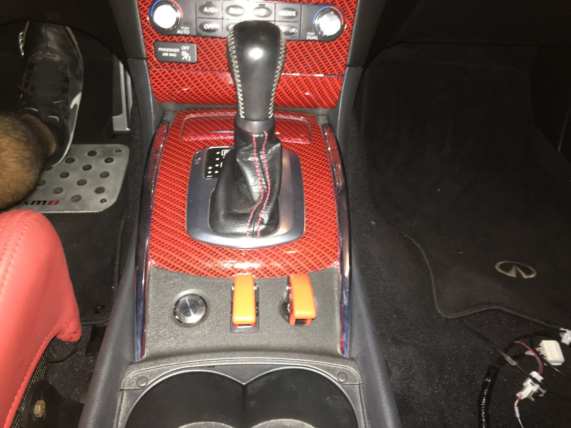

Unfortunately, this feature reduces your ability to do a standing burnout at the dragstrip or brake boost (if available) off the line. After doing a lot of reading on the subject and asking around I found a way to defeat this and did so using a momentary switch (it has to be held down to work).
Tools required (trim removal tool/flathead screwdriver, phillips head screwdriver, needle nose pliers, soldering iron, heat shrink, extra wire, razor blade/wire cutter)
1: Remove your driver side kick guard by pulling up and back on it.
2: Remove the fuse box cover in it's entirety, there is a screw located in the front of it but the other parts are clips and can be pulled directly off.
3: With the fuse box off you can see the fuse diagram showing the fuse that can be pulled accomplishing the same function but removing brake light operation.
4: Locate the pink wire in the middle harness plug. Above the green in the picture. This is the brake light signal wire.
5: Cut this wire and solder your switch wiring on to the ends. Heat shrink the connections and run your additional wiring to your switch.
6: I ran my wires to a button in the center console that is a momentary switch. If I hold it down I can brake boost all day, when I let it go it will return to OEM functions.
The best part about this method is that you maintain your brake lights no matter what (in comparison to the fuse pulling method which disables your brake lights)
Simple and easy DIY. Have fun and be safe!

Awesome, this is great for launching! What size/gauge of wire are you using for your switch mods?
What brand of nc momentary switch did you use?

I've been using a solid 22AWG (threaded may be easier to use) and this switch:
Amazon.com: Alpinetech 19mm 3/4" Momentary Normally Closed Stainless Steel Metal Push Button Switch Screw Terminal Extended Button: Automotive Amazon.com: Alpinetech 19mm 3/4" Momentary Normally Closed Stainless Steel Metal Push Button Switch Screw Terminal Extended Button: Automotive
