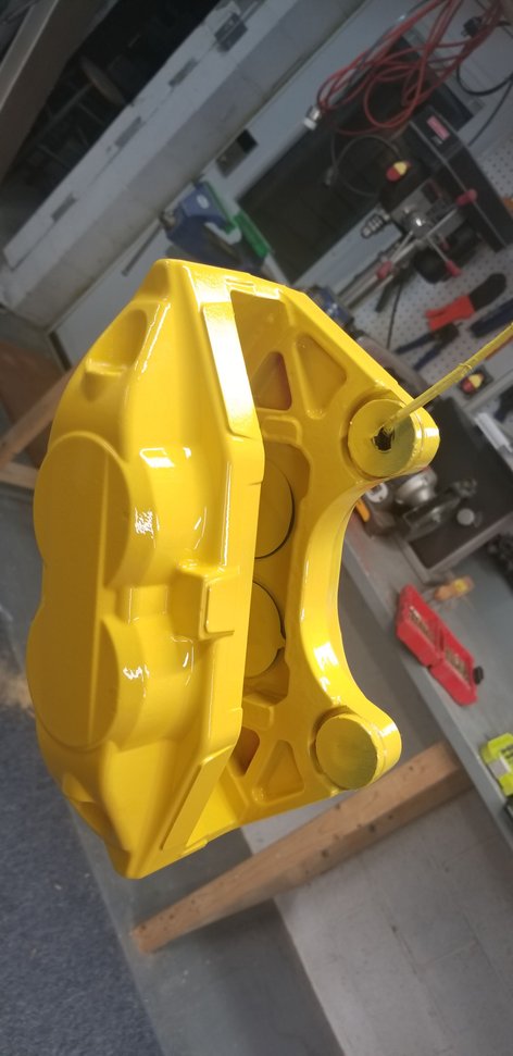

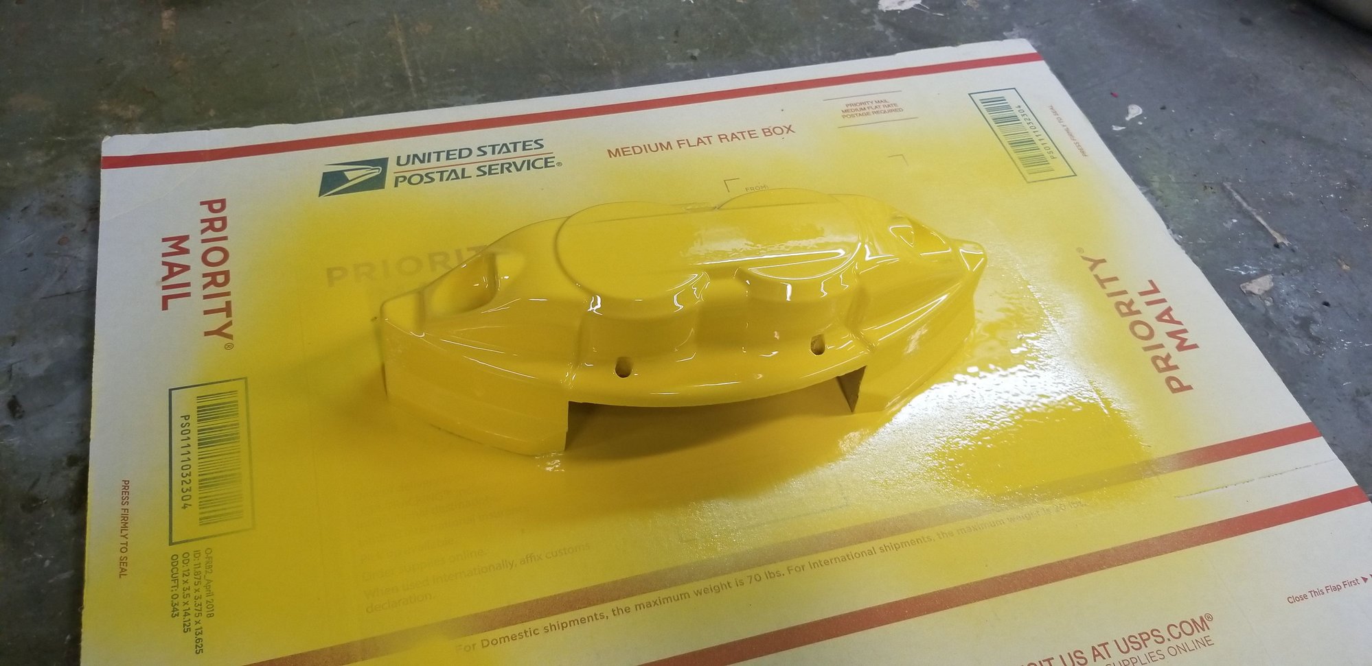

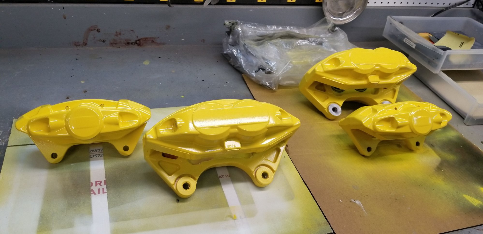

Mine have been painted for like... 2 years now and they are still pretty strong and good looking. I powerwash and scrub it all the time, no paint flaking. I used VHT as well.
I did also put them in the oven to cure, I don't remember how long or what temp though.
I assume you just didn't prep it correctly. Did you sand it down? clean it very well? use wax and grease remover / alcohol?

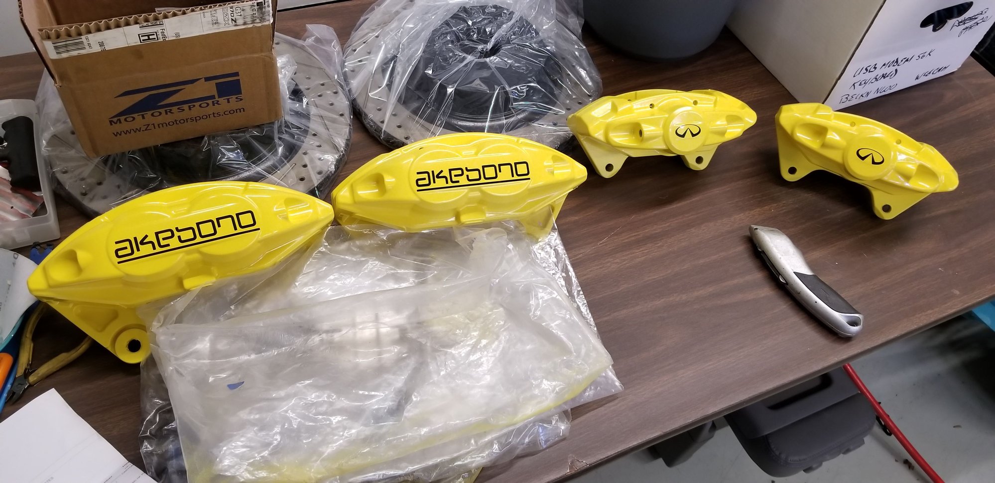

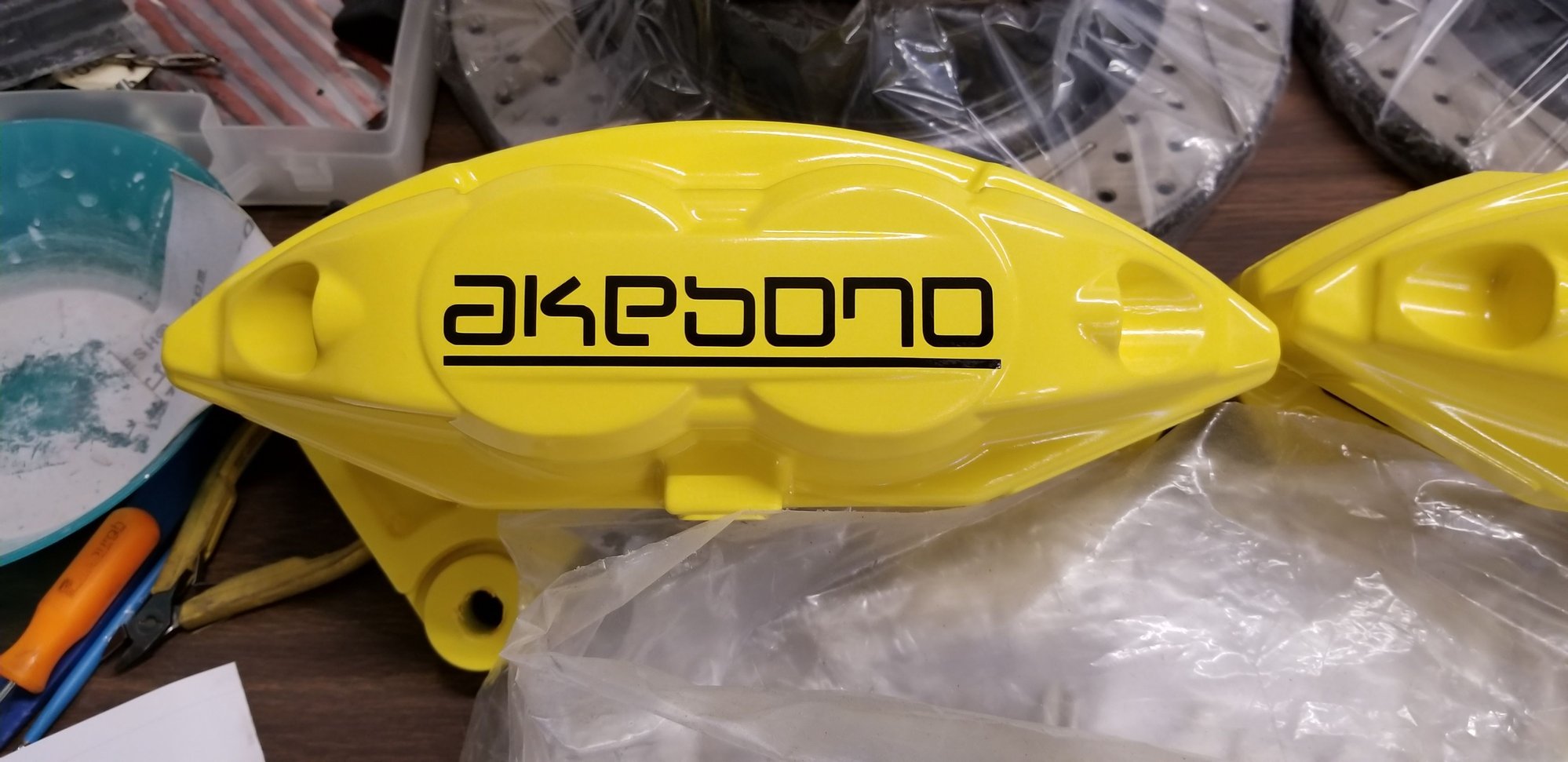

The high-heat primer (as are most primers) is intended for bare metal. The calipers (I'm assuming akebonos) aren't bare - they're anodized. The anodized coating is then clear-coated. I'm not suggesting you sandblast them, but you need a primer that will etch somewhat to get some bite.
Edited to add: Also - stick them in the oven at 300* for an hour or so. Not hot enough to hurt the seals (brakes get hotter than that when running hard) but definitely hot enough to cure the primer / paint.
/// maybe do this while your housemate(s) are not home...

^ yeah I put them in the oven also, I think it did make a big difference. I think the can said 2 hours.

I sanded them down, then took 91% alcohol rub to them to knock off any residue. The only thing I see different is I didn't do an oven cure. I believe the can said you could allow them to dry for a minimum of two hours; which is the route I did and left them to bake in the sun for a 'natural cure'. The first time, I took it down to bare metal. The second time, I just did a 600 grit to rough up the surface, re-sprayed primer let dry, paint then let dry again.
Considering another 600 sanding on the current paint then re-spraying to see if it takes; feeling a bit defeated at this point so a lazy half-cocked attempt is all I have in me before I go the professional route.

If you've got crappy adhesion with the prior primer and paint, you might need to remove it all. Are they off the car? If so, easy enough to get a cheap sand blaster at harbor freight and glass bead or walnut shell to blast with.
https://www.harborfreight.com/21-oz-...gun-95793.html
https://www.harborfreight.com/25-lb-...dia-61875.html or https://www.harborfreight.com/25-lbs...dia-92155.html
You'd need access to an air compressor and a good respirator/goggles.
