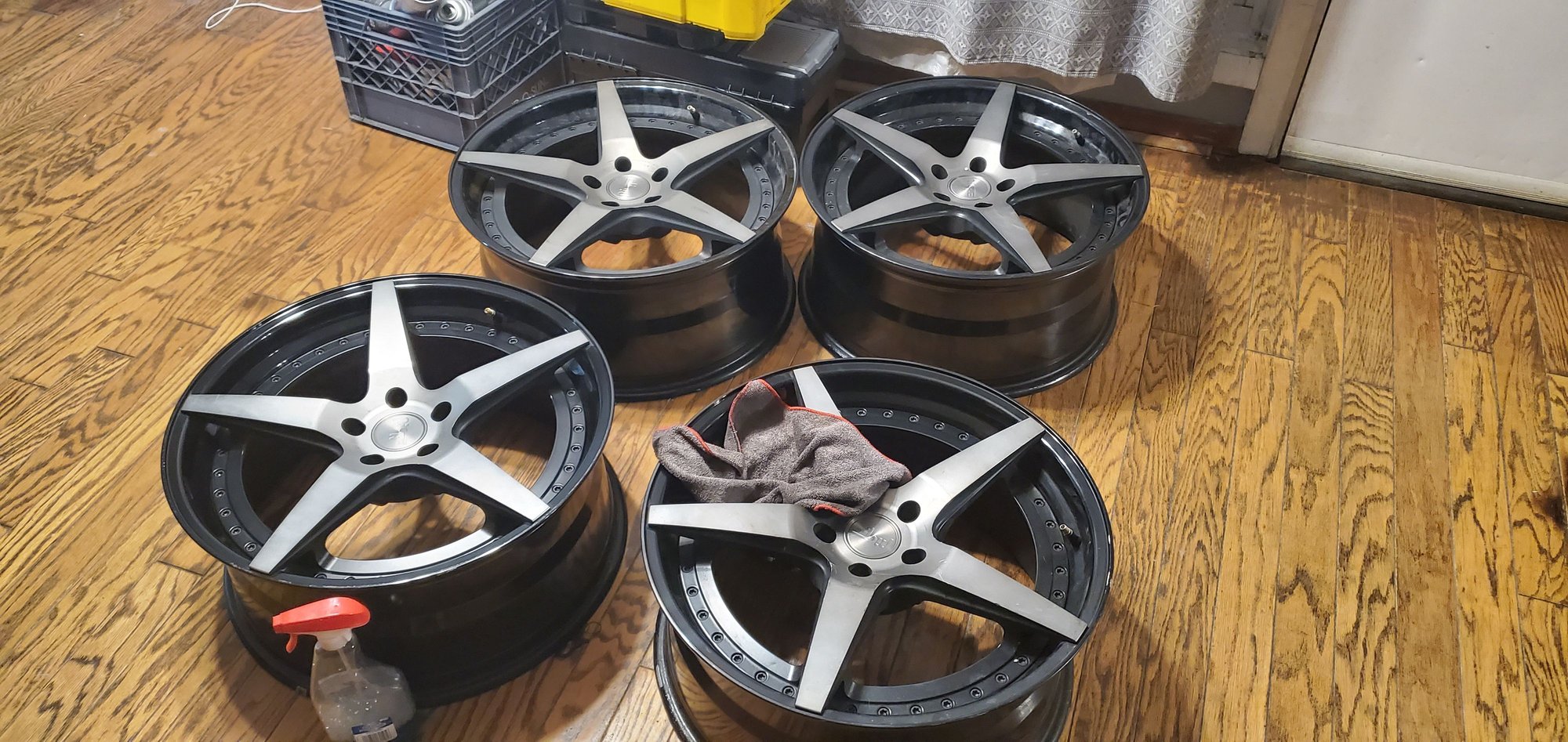

Ended up grabbing these locally for pretty cheap. 2 piece forged niche le mans 20x9 et38. Guy basically gave them to me for free at the price. Gonna tear them down and have the faces hydrodipped in something awesome

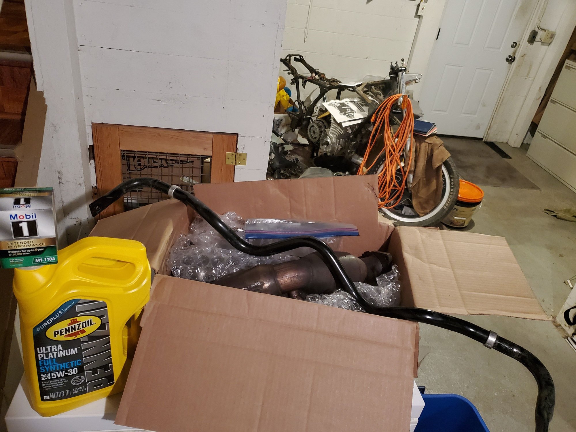

This is the parts I was planning on getting installed today at the shop:
RSB from coupe, oil/filter change, FI RHFC, Bell Raceworks Diff brace.
Items actually installed, all of the above except the RHFC (ran out of time). The cats will hopefully be installed next time.
Between the new-to-me rear sway bar and the diff brace, I dont feel like I feel any major difference yet (I also haven't done any hard acceleration from a stop or good cornering yet). I am really looking forward to getting the cats on soon and will update then

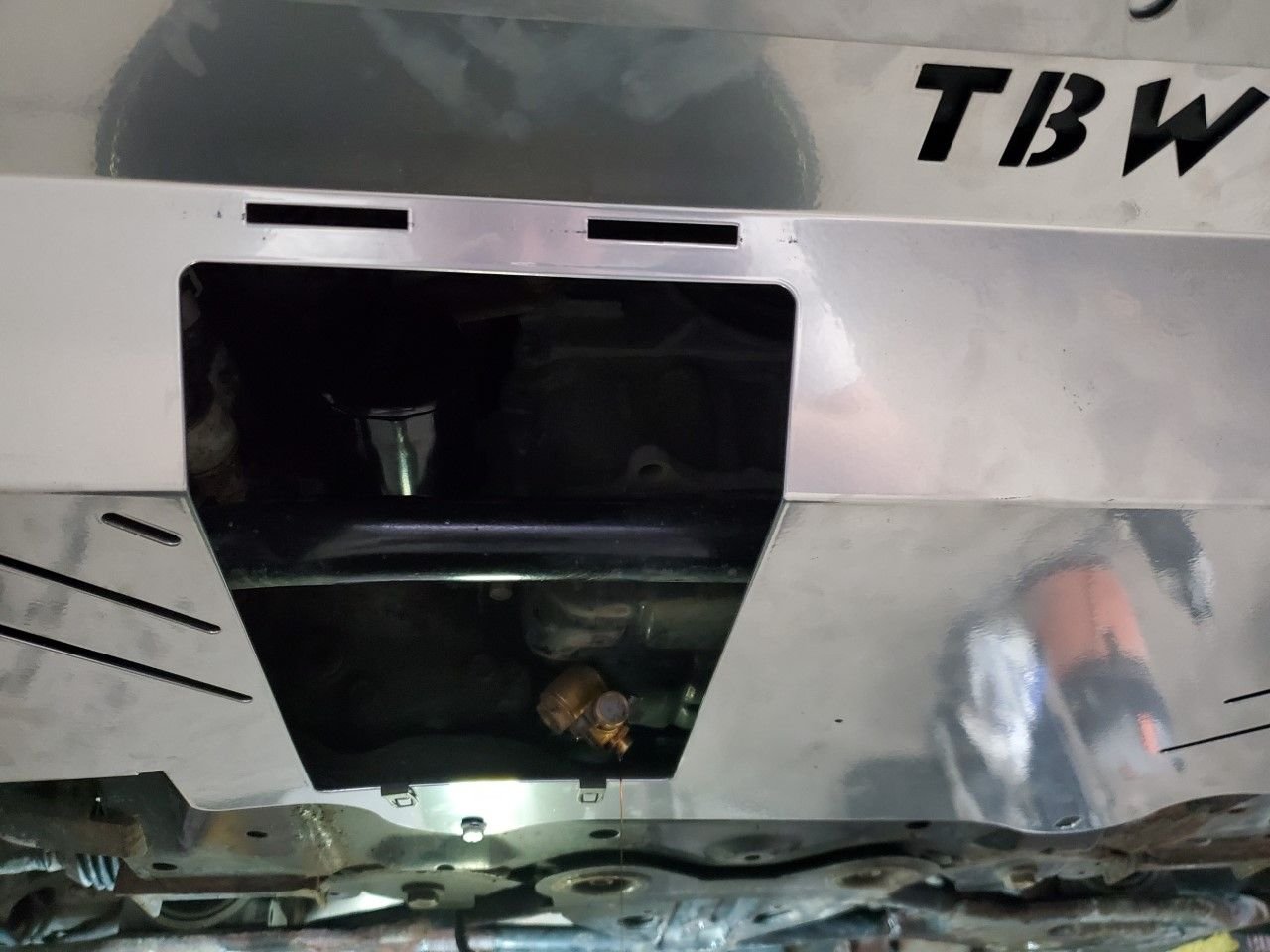

Forgot to upload the other pictures from the shop day on friday.
Drilled out a few broken screws from the old plastic engine cover and installed TBW engine guard. Fits great and my Easy Flow oil drain fits inside the opening perfectly.

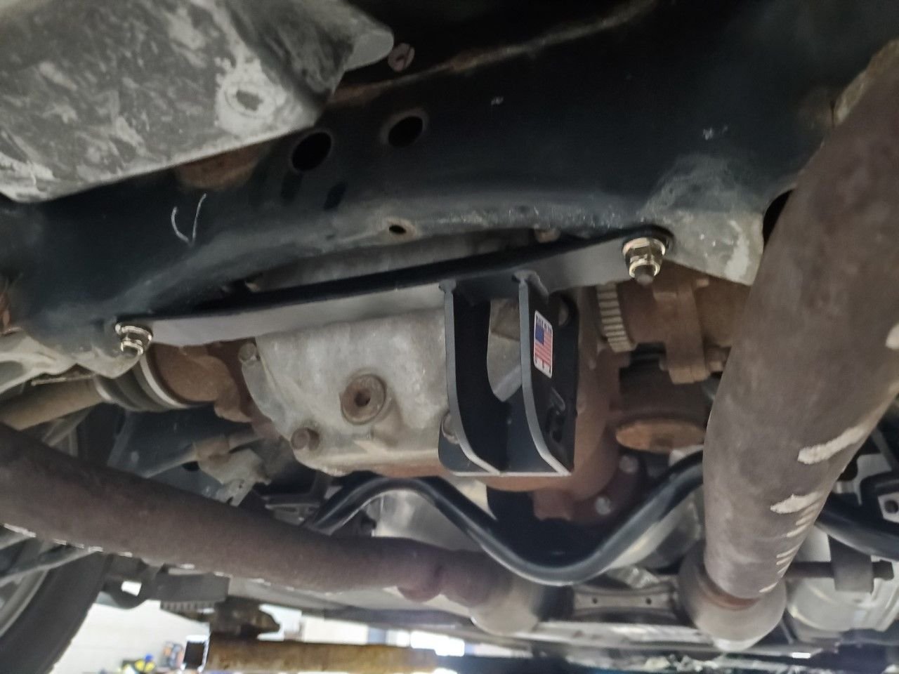

Also got the rear sway bar and Bell Raceworks brace installed before my bushing went out.
**NOTE** do NOT use the 2 longer bolts they provide to replace the diff bolts. They are too long by just a little bit and your diff bolts will bolt back up just fine.

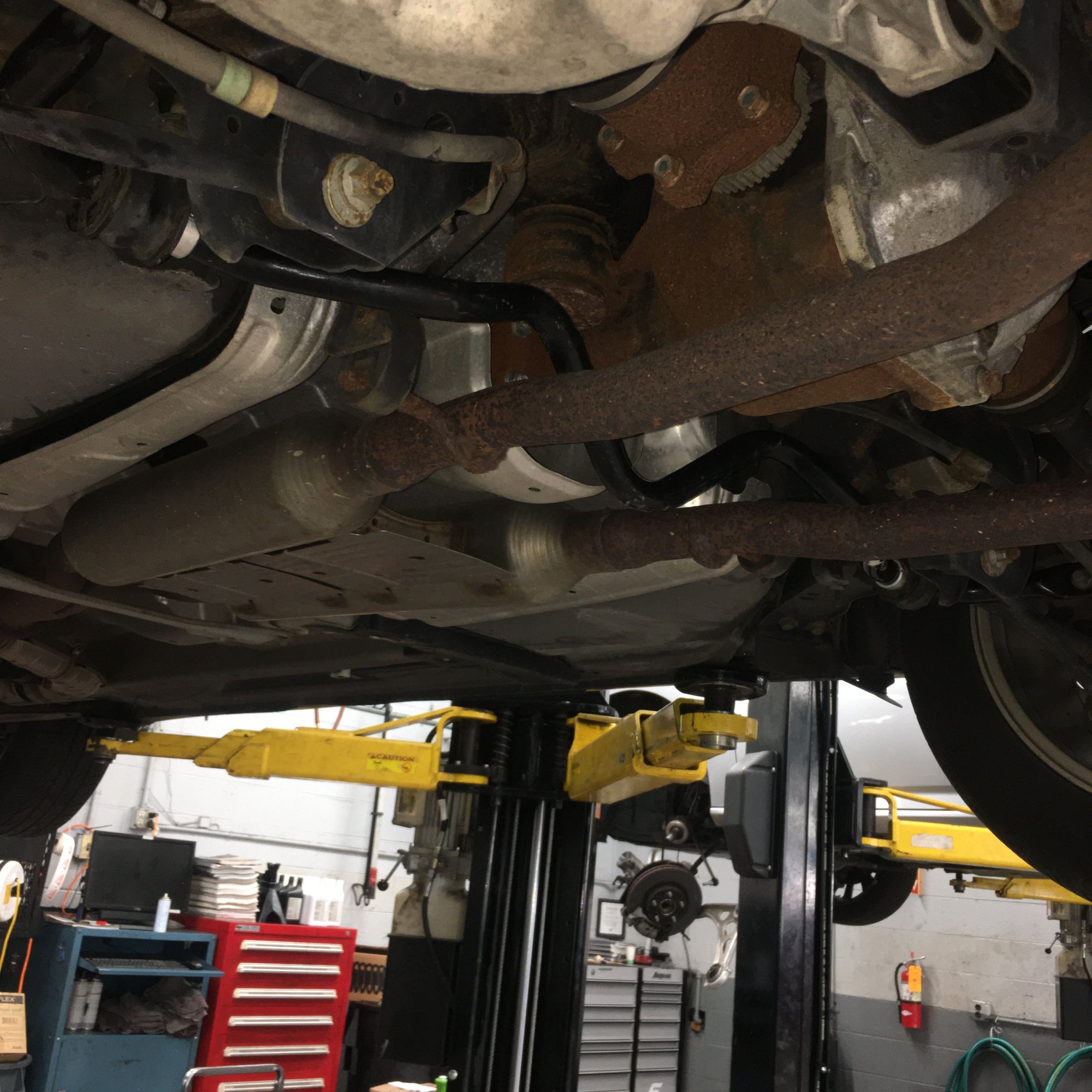

RSB Done
Finally got around to installing the sport rear sway bar on my AWD sedan. Install took about 30 min total including the test drive afterwards.
Car definitely corners significantly flatter with no noticeable difference in ride quality. Another plus that I noticed is that the tendency to understeer has drastically decreased so I am very happy.

Not sure if I understand that statement but I will say the 2 bolts provide do fit correctly. Did you have a washer on it?

Same. I had no issues with the longer diff cover bolts provided by Bell.
