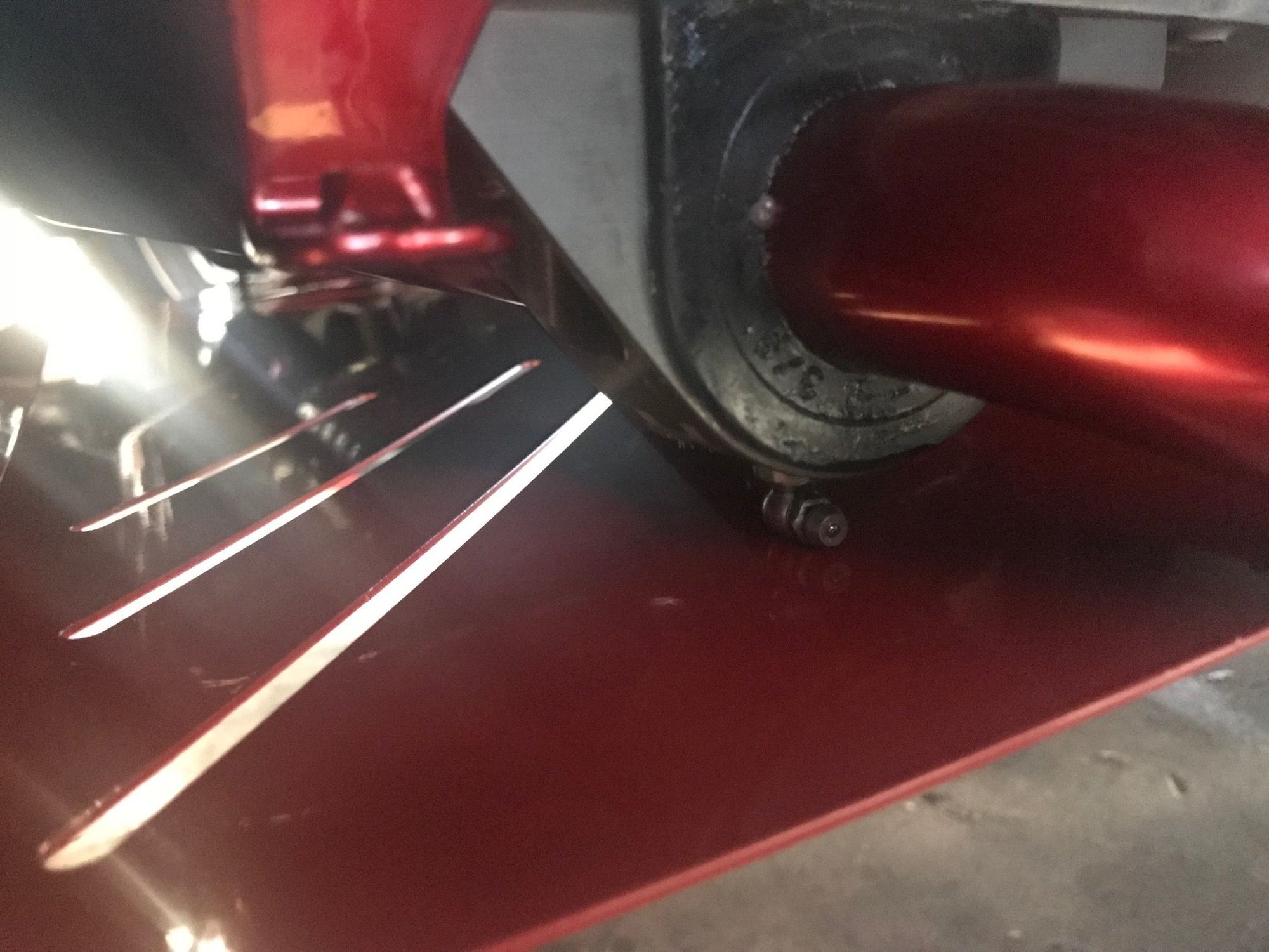

So... it's the Zerk fittings for the Hotchkis frame brackets that's the problem, not the aftermarket bar itself? Is that what you're saying?
That's good info for anyone planning on an aftermarket tray.
Yeah, the zerks were the only spot I have fitment issues with. Although, I have the TBW under tray, so the fitment for other aftermarket trays may be different. But, as I mentioned, it's a fairly easy fix to just drill a couple of holes were the zerk fittings make contact with the under tray. Here are a couple of pictures of the zerk fittings contacting the TBW under tray. I couldn't find any pics after I drilled the holes in the under tray, but I can always take a couple pics if someone wants me to.

Those sway bars are beautiful. Paint is wearing off my Eibachs after all these years.

Interesting Adrian, I need to take a photo of mine. Last time I checked, I had like 5 mm more clearance.

Thanks for the nice words. I do love the candy apple red powder-coat! I don't really have any experience with Eibach, but the original powder-coating on the Hotchkis sway bars was holding up pretty well before I had them redone... even where the bushings ride on the bar there was very little wear. My powder coating guy actually had to send the bars off to have the old coating removed with a chemical dip.

More good info there on the under tray.
It's not a high priority for me, bit odds are when I get one it will be TBW. I like everything I've ever seen about that tray. I don't have Zerk fittings for my sway bar brackets & frame bushings, but I like collecting miscellaneous info like this. Things get repeated here, because car forum.
I wonder... my engine is lowered in the bay by a half inch because if the aftermarket motor mounts. I wonder if that impacts fitment here?
Originally Posted by hexotic
Shouldn't affect fitment. It mounts in place of the OEM one, so if that clears, TBW will too 😁
Yeah, I agree that the lower engine mount shouldn't affect the clearance between the sway bar and under tray, since both of those mount to the bottom of the sub frame which wouldn't be affected by the lower engine mounts.
Do you have the same Hotchkis sway bars with the billet mounting brackets, Andy, or do you have the stamped steel brackets? I think the billet mounts are thicker, so that could be the difference.
