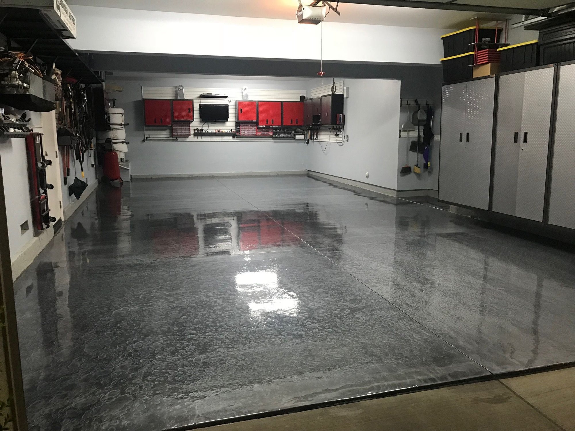

I picked up my AAM intake manifold from the polisher and also finished the epoxy coating on my garage floor.

Beautiful. Both.

Well just another example of living right, simply gorgeous, not overdone but so functional, and should be easy to keep that way. Great job Adrian!

sexy intake and floor. How long did the floor take to do? did you do it in stages? what product did you use?...I was thinking of doing mine with a kit Costco has for a few hundred dollars (Canadian)

Thanks, Brad. I plan to be in this house for the next 15 years until I'm ready retire, so I really wanted to put in something that will hold up well and still look good years from now. The previous owner had previously used a DIY epoxy box kit from one of the big box hardware stores and it just wasn't holding up. That really made it a pain to recoat though as we had to grind the old coating completely off before starting with the new coating... Took me and two friends a day and half to completely grind the old floor coating off... definitely not something I would recommend doing for anyone over the age of 45, especially if you have a bad back!

Hey man. Thanks for the nice words. The floor was a big project partially because the old coating had to be completely removed first. The entire process took about 5 days (not including a one week final dry time) with a day and half just grinding off the old floor. The new coating was applied in 4 stages. The first was a primer coat that we let dry overnight. The second coat was a base coat with the main charcoal grey color epoxy, which had to dry for 24 hours. The third coat was the main coat which consisted of a mixture of two different color epoxies, the main charcoal grey color and a lighter steel grey color, plus about 5 pounds of real metal-flake was added to the mix to help give the floor that liquid metal look. Once the main coat set for an hour or two we sprinkled the floor with acetone to give it that cratered look to try and make it looks more like stone. Then we let the epoxy dry for around 36 hours. Then the final coat was a UV resistant polyurethane coating to help protect the floor against fading and also add another layer of durability. This is the only coat that really didn't go well... the epoxy coating looked like glass before we added the polyurethane coating, but it was so hot (even at 7:00 am) out when we laid the poly coat that it was literally starting to set before it even had a chance to level out, so the floor now has a bit of an orange peel look to the surface instead of being as smooth as glass. It really bugged me at first and I was thinking of adding another poly coat but after I put everything back in the garage and parked my cars in there I barely notice the orange peel now.

Forgot to mention that I have a friend that does this for a living so I got all of the supplies through him which aren't available over the counter and he also had all of the proper equipment to do the job right. The total cost just for the materials was around $1800 (that was for 1000 sq-ft of coverage, so figure on maybe 1/2 that or a little more for a standard 2 car garage) so it's not a cheap endeavor even if you plan on doing the work yourself. I'm not familiar with the Costco kits, but I would stay away from the box kits you see at Home Depot or Lowes if your looking for something to last for years and years. The is the 3rd house/garage that I've done the floor. The first was back in the 1990's when I bought my first house and there weren't many options back then so I used a two part epoxy from Home Depot... I even roughed the floor with a sander and etched the floor with muriatic acid and it still was starting to wear through and flake after just a couple of years. I learned my lesson with that house and have used professional coatings since. If your looking to do the floor yourself I have heard good things about the floor coating kits available from Car Guy Garage: https://www.carguygarage.com/epgafl.html
