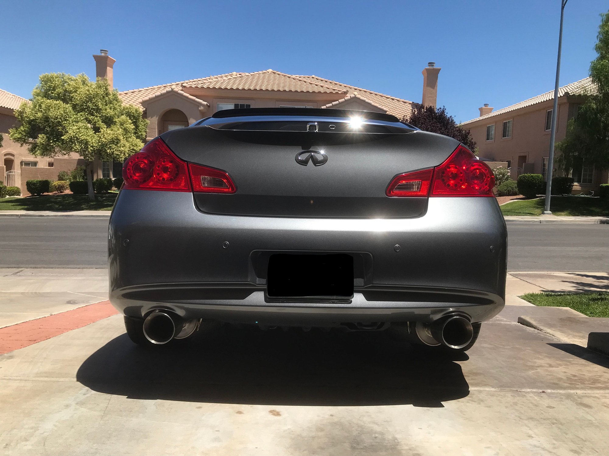

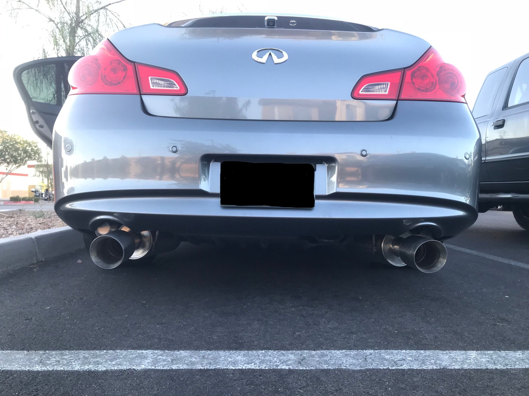

Hey guys new here. I’ve owned a 2013 G Sedan for 2 years now and installed ARK exhaust today. Although I noticed my exhaust tips hanging lower than normal. Has anyone had this problem or know how to fix it? Much thanks in advance. My OCD is killing me.

Thay does seem like they are hanging low. Did you install them or a shop? I used to have ARK as well and it didn't hang that low .I know for Motordyne, depending how you install the pipes, it effects the end result of the tips location . Maybe that could be it?
To get an idea, here's my old thread after installing my ARK .it does not hang that low.
https://www.myg37.com/forums/g37-sed...or-review.html

Yeah, that's not right. You're going to damage them somehow hanging like that. It's going to happen, just a matter of time. I'm sure just about any shop can correct the fitment for an hour of lift time.

The rubber hangers come in different lengths. Any exhaust shop should have a variety to choose from. Just get something shorter. If the problem is really bad, like over 1", you may need to just torch and rebend the metal hangers on the exhaust itself. Just a small example from Cusco. Ive seen adjustable ones as well.
http://www.cuscousainc.com/products/...st-hanger.html

So I contacted ARK and they told me to try swapping the mid-pipes maybe I had them on the wrong sides so I swapped them today and that seems to have fixed the issue! So for anyone in the future installing these yourself and run into this problem, swap the mid-pipes!
Thank you all for your help and suggestions!

Hey, that's awesome! Glad you found an easy solution.
Looks so much better.

The car is looking much better after the fix. Very glad that Ark had the right answer!
