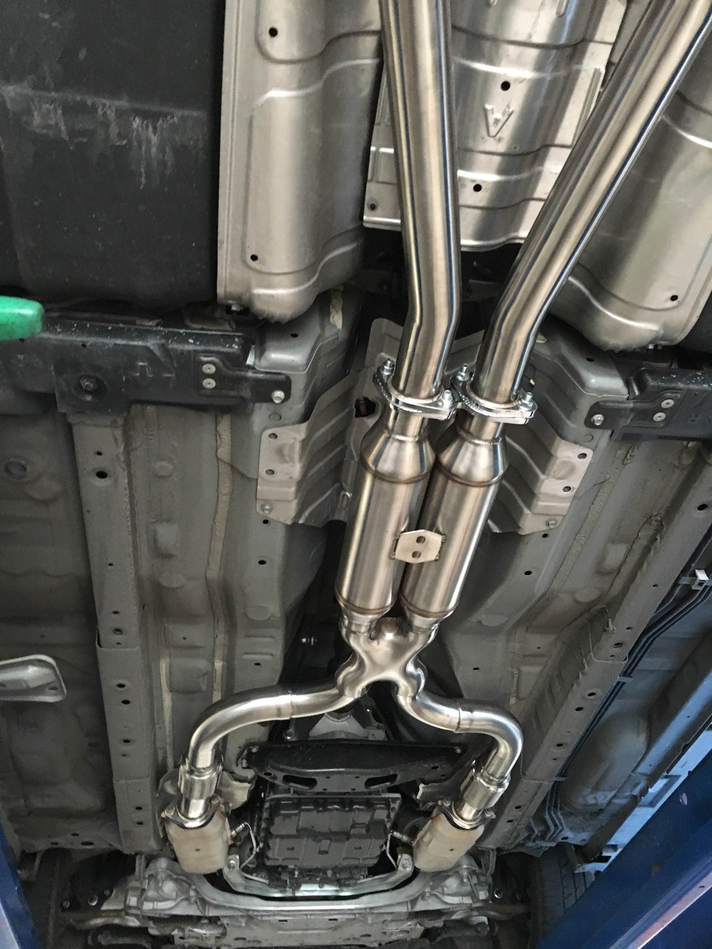

Installed ARK GRIP CBE
As some may have known, I took advantage of the 30% tax return sale + free shipping offered by ARK. Seemed like a pretty good price for this type of system.

Final Pic Installed
Overall, exhaust sounds nice and deep with the "new" burning smell as most exhausts have. But I have another question. The mid pipes seem to awkward / funny looking as they aren't symmetrical. One of the hangers was actually an inch longer than the other. Under the car, it looks funky for some reason. No exhaust leaks so far or anything though. Just wondering if this is common with most ARKS? anyways, very pleased.

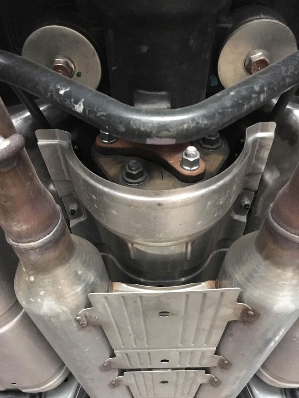

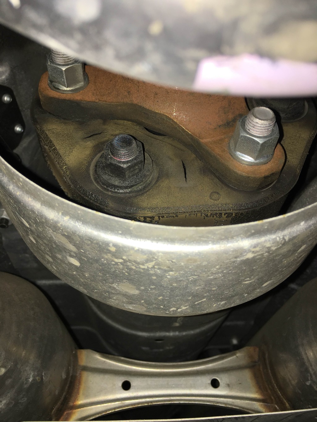

Ripped / Torn Drive shaft
As I was getting ready to install my exhaust when I noticed something under my car while it was on the lift. It caught my eye because it looked sort of like 2 rips on a piece that was unknown at that time. Here is a picture of it:
Up-close
Little better pic of an overall idea
Now, according to Infiniti, this is part of the driveshaft. This RARELY happens according to them. But who knows. I have 62,000 miles on the vehicle which is a 2011 G37S Sedan 7AT. If I didnt install my exhaust, I would've never found it as my car was at the stealership a week ago and they did not see it.
According to Infiniti, this rip can cause vibration on all levels. Meaning, the car will start to vibrate while in operation. Now that I think of it, I have been having vibration in the car as you can sometime feel in / hear it with the cupholders. Anyways, it's getting fixed under powertrain warranty on Monday. If anyone is having huge vibration problems, this may be a solution!

Excellent quality photos here, really letting people see this exhaust from a practical perspective. Well done. And big thumbs-up for cluing people into that drive-shaft problem. It's the first I've heard of it, and is enough of a big deal to be worth remembering. Thanks, OP.

Also, just a little fact, the rip in the driveshaft is caused by wear and tear, not really driving habits. They also said if you live in a hot area, it could crack it since it's made with rubber and the heat can crack it? Just a little heads up. I'll let you guys know how it goes on Monday. I'll get part numbers for you guys as well JUST in case it happens in the future.

And this exhaust is nice. What I have to say the major difference is in the low rpms. Still breaking it in but I've noticed that above 5k, the sound is still enhanced but you get more of the VQ sound out of it. On the lower RPM, I get that deep bass grumble sound. Prob >4K rpm. But like I said, only around 50 miles on this bad boy. Can't wait to get a pair of RHFC / HFC.
Only downside is you watch your mpg go down. I can assume you know why so it's not really a downside haha

That X into those bottle resonators are beautiful. Thanks for sharing

Thanks for sharing the driveshaft cushion info. I didn't perform my ARK Grip install, I will have to crawl under my car to see if I suffer the same cracked rubber problem. I don't have a vibration problem yet on my 2011, but I do live on the Gulf Coast and does indeed get a bit warm here.
To be honest, the things that Infiniti listed as what can cause this besides the normal wear and tear is (1) high milage. I guess this is common on the G's with 100k+ miles? Well, let me rephrase that, I wouldn't say common but a higher chance of it occurring on the cars cars with high milage. Or (2) Hot temperatures as it can cause problems with the rubber.
But the odd thing is...... These "reasons" are the complete opposite of how my car has been. My car has 62,000 miles on dash right now as well as I live in San Francisco, Bay Area, CA. This city is not hot what so ever. 75% overcast / foggy / raining.
SOOOOO, I have no idea why my car has it but it does, and it is getting repaired under warranty which I am happy about.

Great pics man! I live my ARK grip! Super good info the driveshaft bushing , I'll check mine out I have almost 90k on my 09!

The cracked rubber part is called a "Giubo" or rubber donut.
https://en.wikipedia.org/wiki/Giubo
Anyone who has worked on german rear wheel drive cars will recognize it
