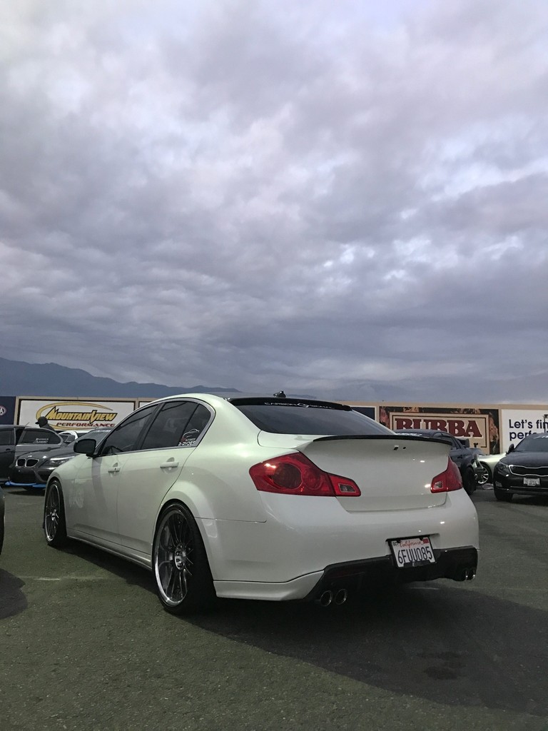

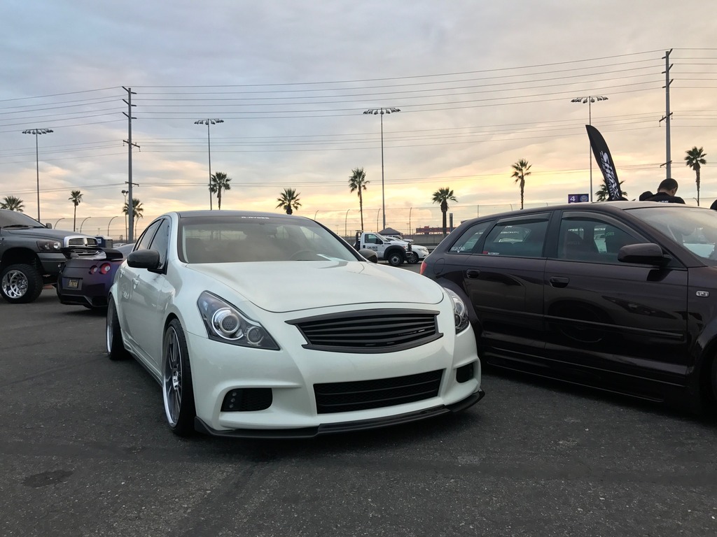

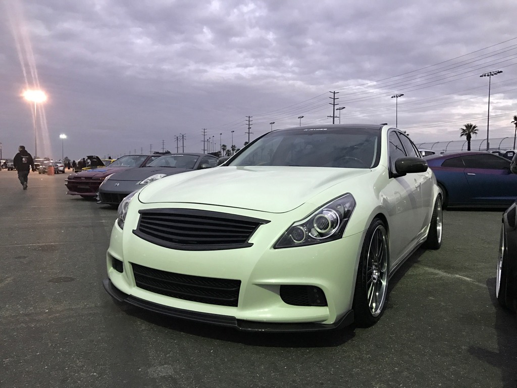

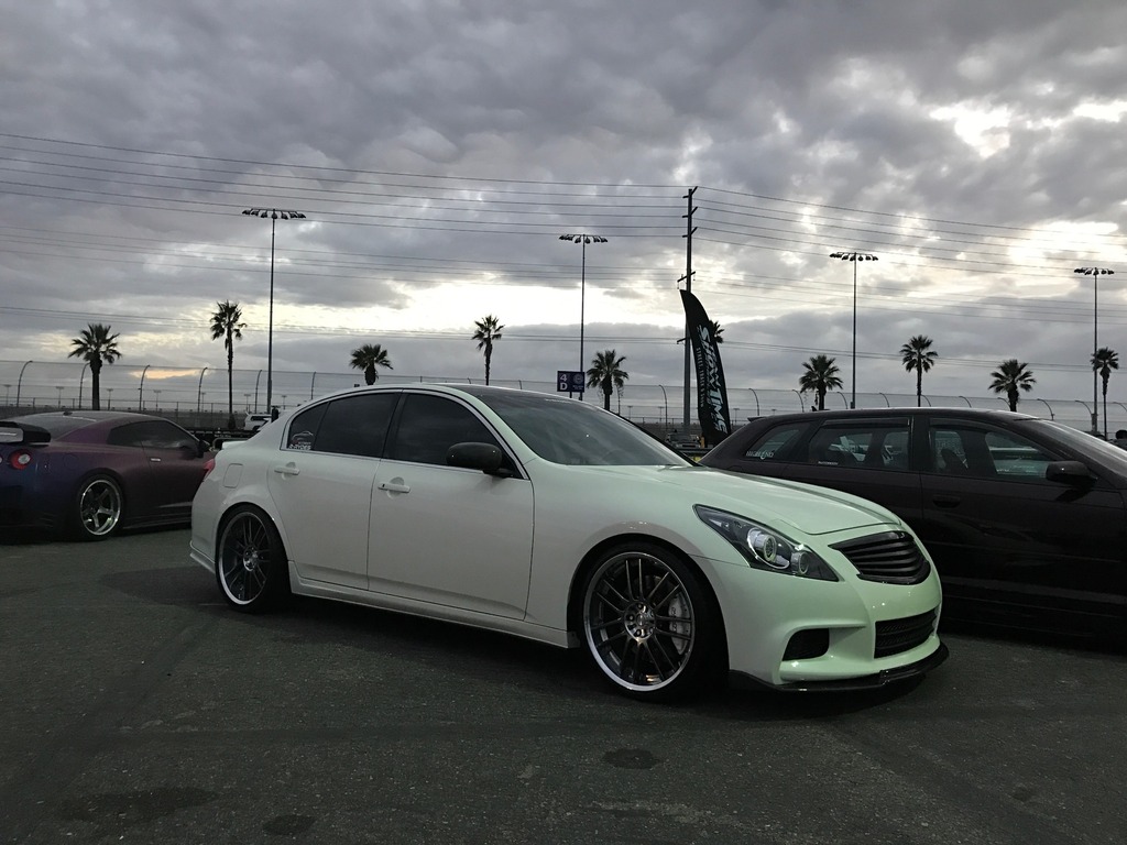

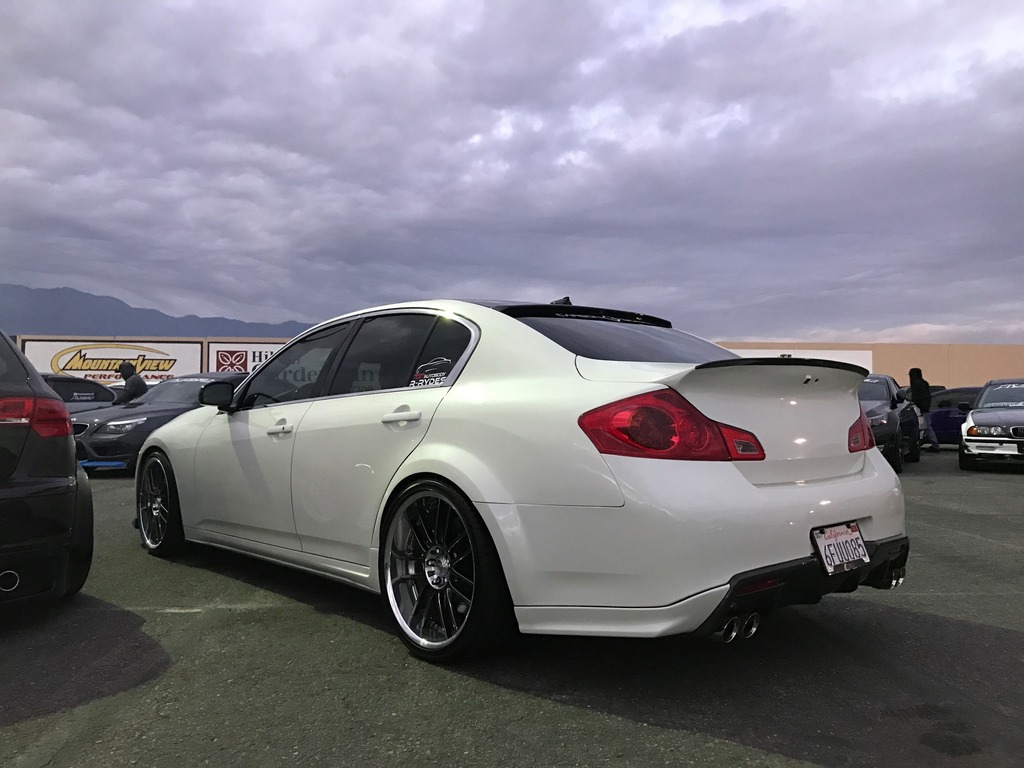

Rear fenders
Would like to ask you some questions about what you had to do to get the rear fenders that wide. Trying to fit a 305 tire myself
Here's my set-up.
Wheels: Volk GT30's
F: 20"x9.5" +30mm (+35mm - 5mm)
R: 20"x10.5" +25mm (+37mm - 12mm)
Tires: Toyo T1 Sport
F: 255/30R20 (soon to be 275's)
R: 305/25R20
Camber for all four corners between -1.5° and -1.7°
Notes: Wheel specs includes spacers. And rear fenders have been widened by almost 1-1/2" per side.
